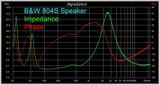

I would like someone to explain how speaker impendence affects the amplifier. I know amplifier have a impedence rating and you're not supposed to go below that because it will draw too much current from the transistor.
How is that speaker impendence measured though? For example, I have a two way speaker system here whose impedence dips to 3.1 ohm. If I build the XO the way I want to it will dip down to 2.1 ohm. We all know a speaker doesn't just play one tone. It plays a spectrum of music at the same time. So, if it is playing a bass tone at 12 ohm and a high frequency tone at 3.1 tone at the same time, will it place an average impendence on the amplifier of 9 ohm? This is what I do not understand and I would like someone to explain to me.

The impedance rating of an amplifier is based on the nominal impedance of a loudspeaker.
Look at the impedance plot for a two-way speaker shown below.
The nominal impedance can be taken as the value which occurs in the valley between the bass resonance peak(s) and the impedance peak at the crossover frequency. This value is often taken to be the impedance at 400 Hz. In the above plot, the nominal impedance would be around 6 ohm.
The IEC method of specifying nominal loudspeaker impedance is set such that minimum impedance must not fall below 80% of nominal, so for an 8 ohm speaker this would be 6.4 ohms minimum, and for 4 ohms would be 3.2 ohms.

OK, this clears it up for me. Thank you so much
