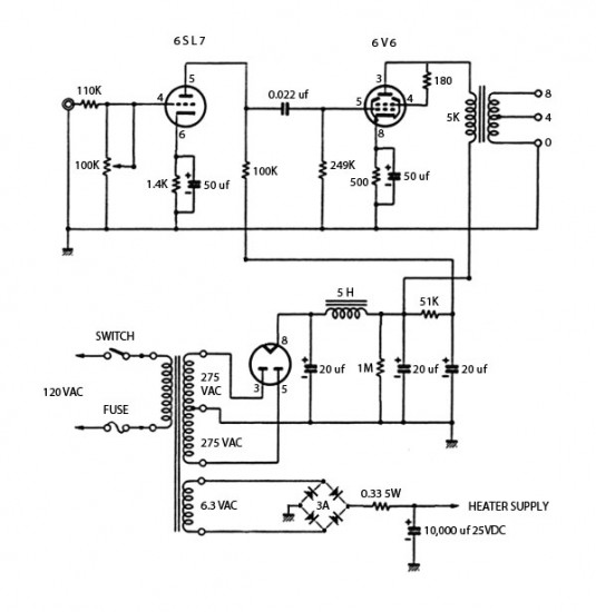

simple 6V6 stereo tube schematic
This is as simple as it gets, just use the best caps and resistors you can afford! Pianolydia
P.s. If you want class AB then go with (2) 6V6;s per channel in the output stage and use PP output transformers, that will make it a class AB1 amplifier! then you would connect the ultra linear tap to the screens! the output would be about 15watts per channel.

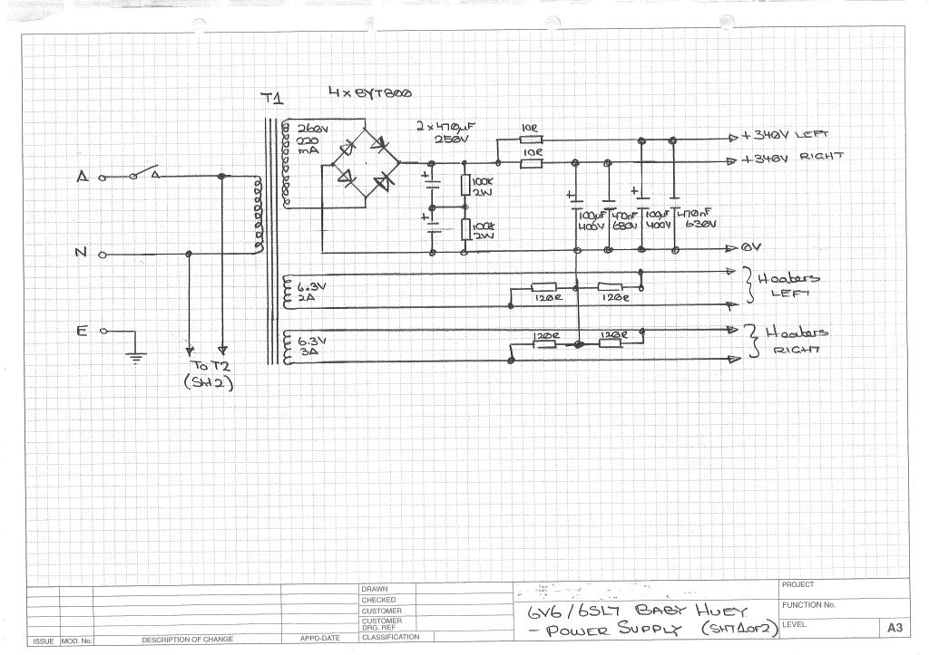

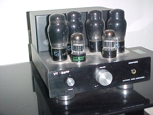

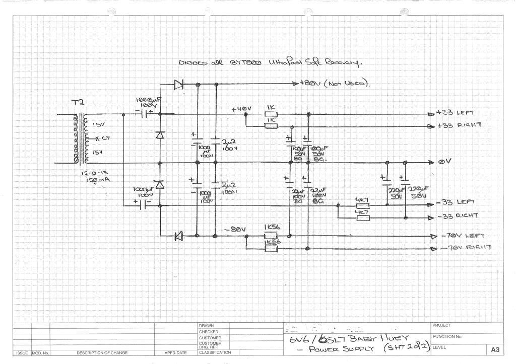

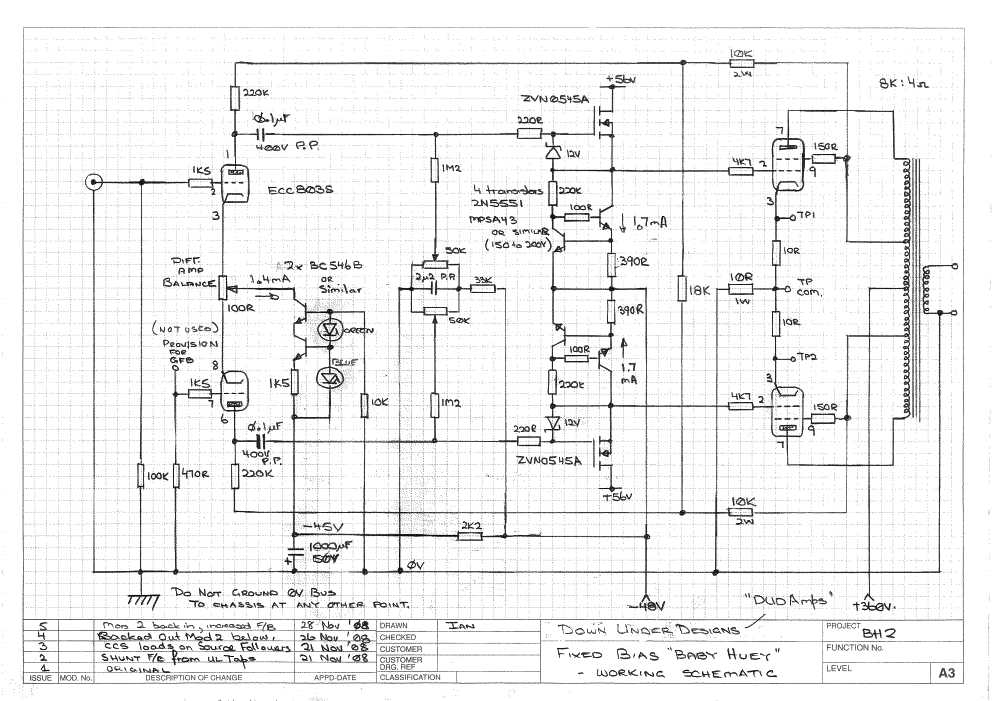

Ian's Amp,
6V6 AB1 Ultralinear with balanced shunt feedback. 6SL7 front end.
I would recommend using a bigger chassis than I did - it was a PITA shoehorning everything into that little box.
The design of this amp is covered in its own Baby Huey Thread which is way too long to wade all the way through.
NO NFB required.
Ian
NO NFB required.
Ian
