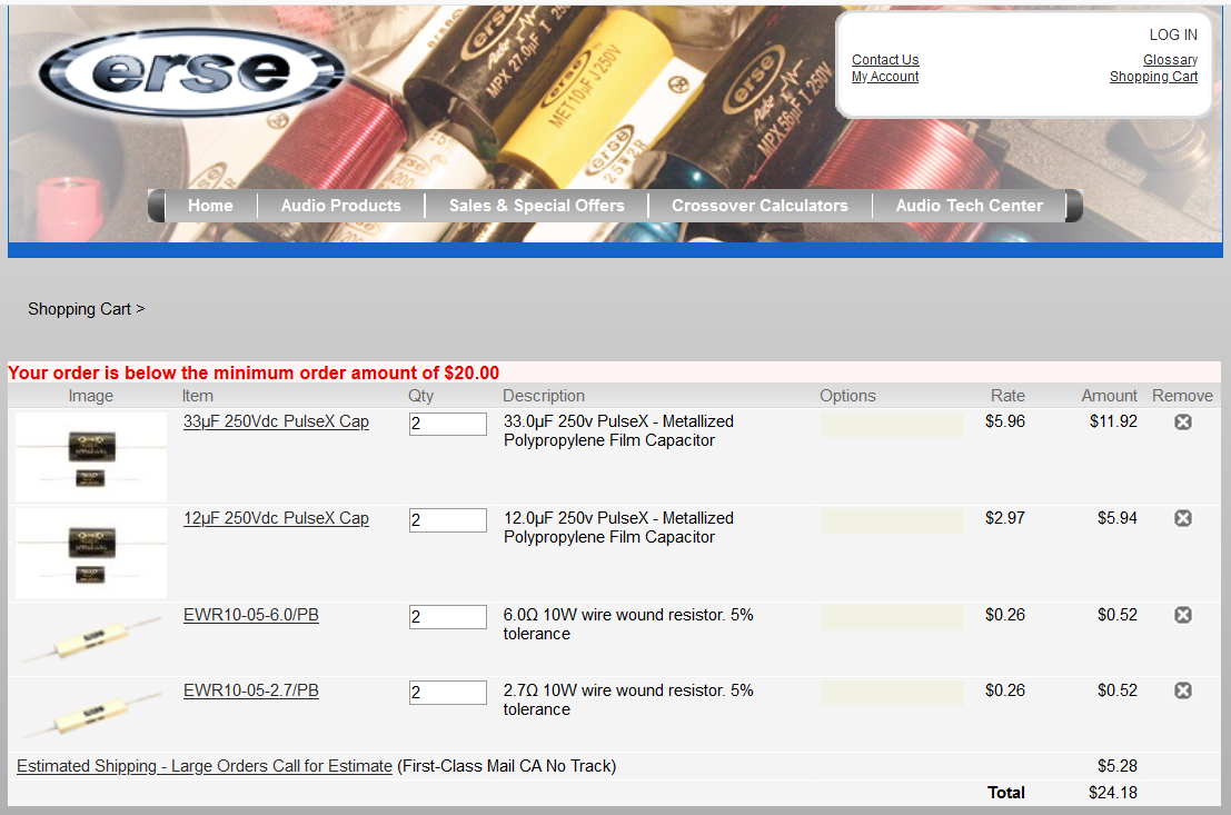

You can do better if you look long enough!
Because the order is still below minimum amount, you have all sorts of gadgets to choose from to modify speakers even further, and you could exchange the inductors as well.

I have the list of components from Parts Connexion for upgrading the crossovers
Clarity Cap PX 12uF 250V 9.34 X 6 = 56.04 CAD
Clarity Cap PX 10uF 250V 8.06 x 2 = 16.12 CAD
Mills resistor 12W 6.2 Ohm 7.42 x 2 = 14.84 CAD
Mills resistor 12W 2.7 Ohm 7.42 x 2 = 14.84 CAD
Total is 101.84 CAD plus shipping and handling.
I don't have experience with Clarity Cap PX 250V but i have used Clacity Cap ESA 250V and i like it but ESA 250V capacitor is more expensive. Hope this will help to improve the sound of your speakers. Cheers!
