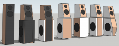

I kind of want to try a 3-way, but I want a slim front baffle--I think 9" is probably my limit. I also enjoy decent bass extension, although I don't listen real loud.
Thanks to room CAD tools "you pay's your money and you take's your chances" is no longer the necessary path to audio nirvina
I took your room floor plan and overlayed a few different speaker directivity plots.
a) a tweeter horn with 60-degree horizontal and 40-degree vertical directivity will give your the best soundstage by removing early wall reflections.
b) a cabinet 15" - 17" deep enough for a 12" side woofer easily fits your room layout.
c) you should maintain at least 3 feet of open space between your couch(listener) and your rear wall
9" wide front baffle supports a sealed 6.5" midrange and a 12" sealed woofer on the 16" - 17" deep side panel.
10" - 11" wide front baffle supports a sealed 6.5" midrange plus two 8" ported woofers...
10" - 11" wide front baffle supports a horn tweeter to significantly reduce wall reflections in your narrow room + sealed 8" midbass
--------option for either ported two 8" front baffle woofers or sealed one 12" side woofer
15" wide front baffle supports sealed 6.5" midrange plus 12" sealed woofer

The last on the right ftw! Very nice design. I’m curious, how high can the side-firing woofer be crossed? Is it basically omnidirectional at 250 Hz (4.5 ft.).
No idea, but looks like Bagby’s design is around 200Hz. In his notes, he says he turned the woofer cabinet 90 degrees and didn’t notice a difference.
