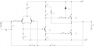

I principal, there is three different designs for n-channel mos-fet power amplifier that I have come across so far. I like to keep it simple and believe a good performing amplifier don't have to be complicated. Inspired by Pass MF-12, Holton N-channel and others, I think it would be fun to design and build one myself, but which one? Target output fets are IRFP520.
I would appreciate comments or experience from any of these designs. Sound, general performance, stability is of course of interest. And of course, how do they compare?
Design A
Design A uses a double differential and is perhaps the most symmetrical of all designs. The second stage (Q1, Q2) don't have to be differential, a conventional CE works fine.
This design have been the hardest of the three to perform well in simulation.
Pros: Symmetrical, uses a real differential amplification.
Cons: ?

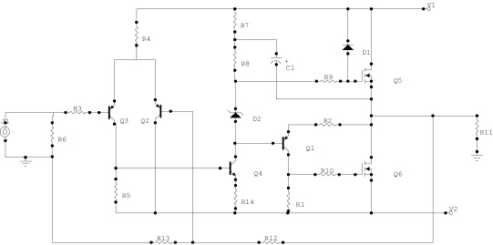

Cons: ?

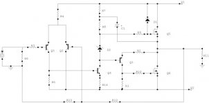

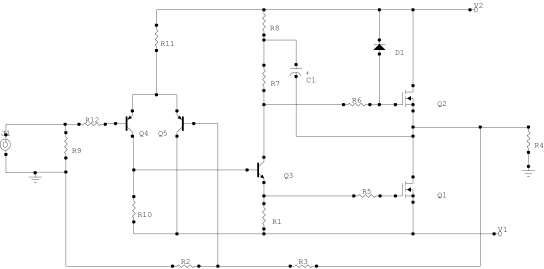

Design B
Design B uses a single transisitor for phase shift. All amplification is in the input stage (Q4), Q3 usally has a gain of one but can be more. It is simple, simulates good and is a proven design.
Holton N-channel is a working example of this design!
Pros: Simple, proven.
Cons: ?

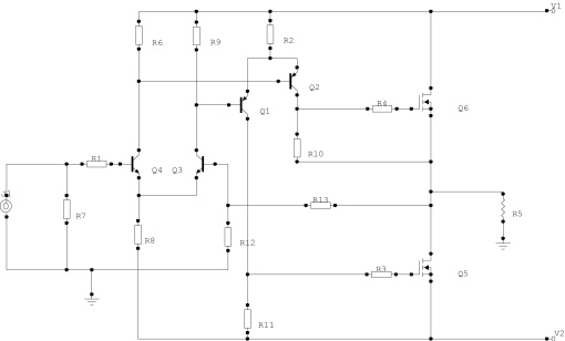

Design C
This design I think is the most classical one, a two stage amplifier (Q3, Q4), with phase shift (Q1), and voltage feedback (Q2). It has been proven over many years and works well.
Pass MF-12 is an example of this design.
Pros: Simple, classical.
Cons: ?

Design A: The collectors of Q1/Q2 go to different rail voltages. This should make it very hard/impossible to find resistor values that balance the currents and gains... does it work?
Design B: I don't think Q3 can be set for more than unity gain because it's also a phase splitter. If you add gain, it will only be added to the inverted phase.
Design C: Mosfet-12, I want to build one of these, I got some IRPF450s cheap...

Design A vs Design C, I would suggest Design C. Same number of transistors. It's not as symmetrical but you will win on HF response.

Considdering that a well desiged amplifier lineairity is domminated by the output stage lineairuty, this design might not be a good chooise ... This output stage is famous for it nonlinearity (BTW same three autheurs), and I also suspect some HF issues, but maybe I'm just being pessimitic now....It's non-symmetric, not ellegant, plain ugly to me actually..

after some experimenting in Virtual Reality, I realized that design A has some efficientcy issues.. the possitive going signals clip a bit mpore below the +V rail.. that's not a big deal but still.. it is however the most linear of your 3 designs.. But I still think I would go with design B now ... better efficientcy and still very good linearity, more stable too ...

The design you showed and the MF-12 both have one leg of the input pair connected to the rail instead of a resistor. This has better HF response than a standard differential although it becomes a single ended application because the Miller effect on the strapped transistor goes away.
Ok, guess it's time for me to own up to my mistakes...
I looked at it again, I agree, the phase splitter isn't really a gain stage.
I looked at it again. I should have split up Q1/Q2 as seperate CEs and it would have been obvious that it'll work, my mistake for the "will it work comment".

Design B is essentially a mosfet version of JLH with differential input stage. The 'current feedback" setup of JLH with a single transistor may just work better.

I had the same problems with design A to get a descent swing (and stability). And like Azira proposes, it works better with two CE in the second stage, and also emitter resisitors in the first stage. Too bad it doesn't work better!
