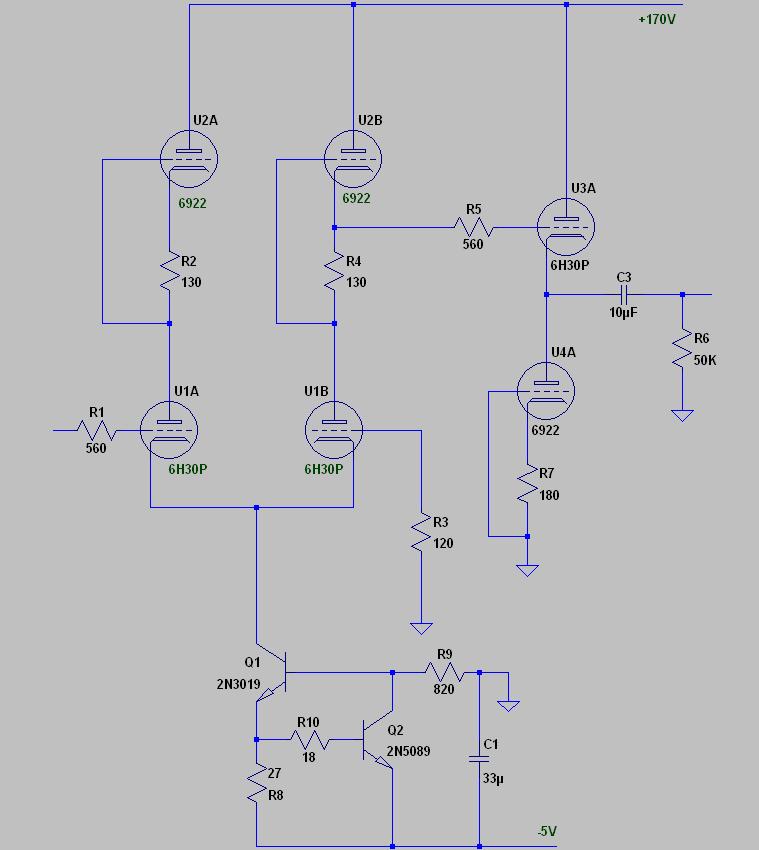

I have had good luck with the Sovtek 6H30PI biased at 12 to 15 mA with a plate cathode voltage of 85 to 90 volts. This circuit I attached I run with a regulated 170 volt supply. It is the lowest noise tube preamp I have ever encountered and the tubes I have are not microphonic. I can't see any change on the scope trace when I tap the tube glass, even if I tap it sharply. I noticed a faint hum with AC on the filaments, so I have swithced them to DC. I only have three of the 6H30PI's so I did not have a big sample to evaluate for microphonics.
I have tried the 6H30PI at several different operating points in other circuits. I have also had good luck at 60 volts and 20 mA. I have found it to be a very linear and good sounding tube but like all tubes it must be biased properly for best results. From my testing over the years if you want to run at lower currents, the 6SN7 is probably a better choice over a 6H30PI.
Thanks Tom, very appreciated input datas !
Seems to me that there is a big "variance" about these 6H30PI,
, ie opposite comments here,so a big factor can be the luck in find
a good one or make a brutal selection. I assume there is not strange
"marks" or letters in these russian tubes, no way to choice before,
just luck 🙁
Paolo
