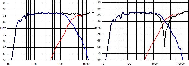

The summed FR is one thing but you really have to check how the drivers are summing at each crossover point (phase etc) and the easiest is checking the reverse null to see if it's nice and deep. If that's the case, then the phase at the crossover point is good.

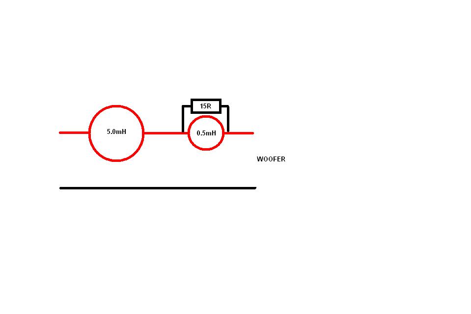

Just "found" a new woofer crossover
I wont claim its an invention, but I have never seen it used like this
On my speakers I experience a much more tight and articulated and rythmik bass
Another side effect is even more articulated midrange and softer highend
Ofcourse its very much system related, and must fit the rest of the crossover chain
Thanks for the post!
How does one calculate the values for this configuration?
Bill.
Bill.
Hi
And thanks for interest
Unfortunately I dont know how to calculate anything regarding crossovers, sorry
I go from listening, which I consider the next best to measurements
Simple calculations/guessing may be a way to get started though
My guess is that the first inductor is the same size as if a paralel cap was used, but about the second inductor I have no idea of the size needed

Big_Bill said:
One question if I may, does "reverse null" mean the same thing as reverse polarity?
Thanks, Bill.
Reverse polarity to me is wiring the tweeter +ve in to -ve on the tweeter and that's required on a lot of crossovers such as 2nd order.
What I mean by reverse is the tweeter is run in reverse to it's correct operational wiring. In the pic below, the left plot shows correct operation of the tweeter which happens to have the tweeter connected in reverse polarity (+ve in to tweeter -ve) where the right pic shows the tweeter reversed from the correct operation and shows a deep null indicating good phase at the crossover point.
Hope this clears it up.
Cheers

Its true
People using measurements use that method with wrongly phased driver ot see the how deep the "null phase" is
They say the deeper "null phase", the better the phase will be when polarity is phased right
But thats just phase at the crossover point
How about phase further from xo point
