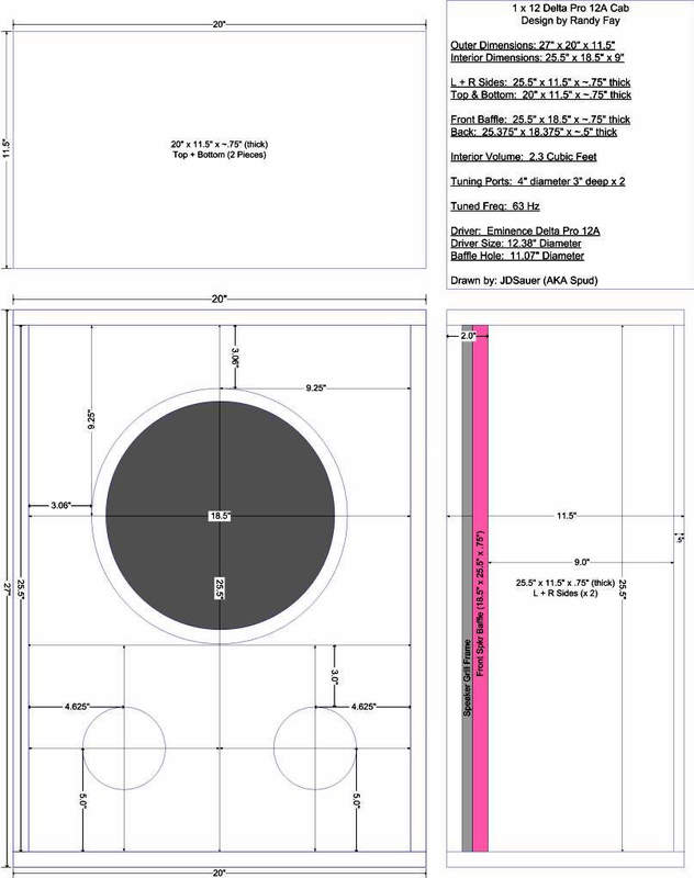

JMFahey & jeffhigh - you both recommend PA speakers. May I ask why? My main cabinet is Randy Fay's design with an Eminence Deltalite II 2512 which is also a PA speaker. I bought it based on Randy's recommendation for the cabinet. I've attached the drawings if anybody's interested.
