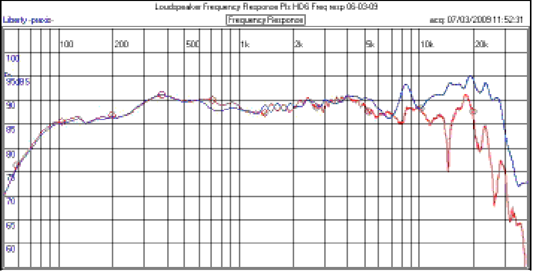

The Tang Band frequency response looks flat (ish) between 50 and 200hz. Do the manufacturers use ported enclosures to make these measurements?
No that is mounted on a huge baffle in free air. So it's actually the best LF response you will ever see from the driver. Once you box it up LF gets truncated.

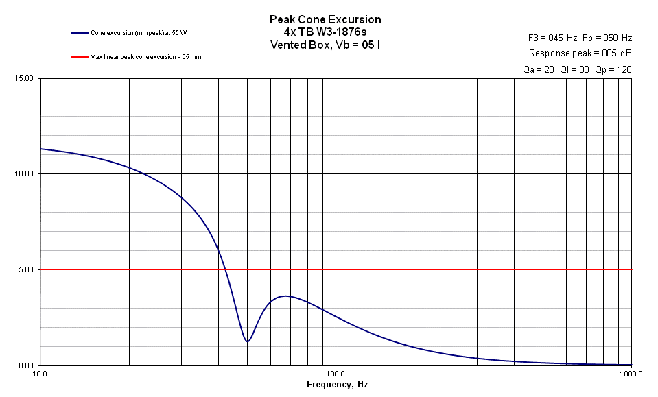

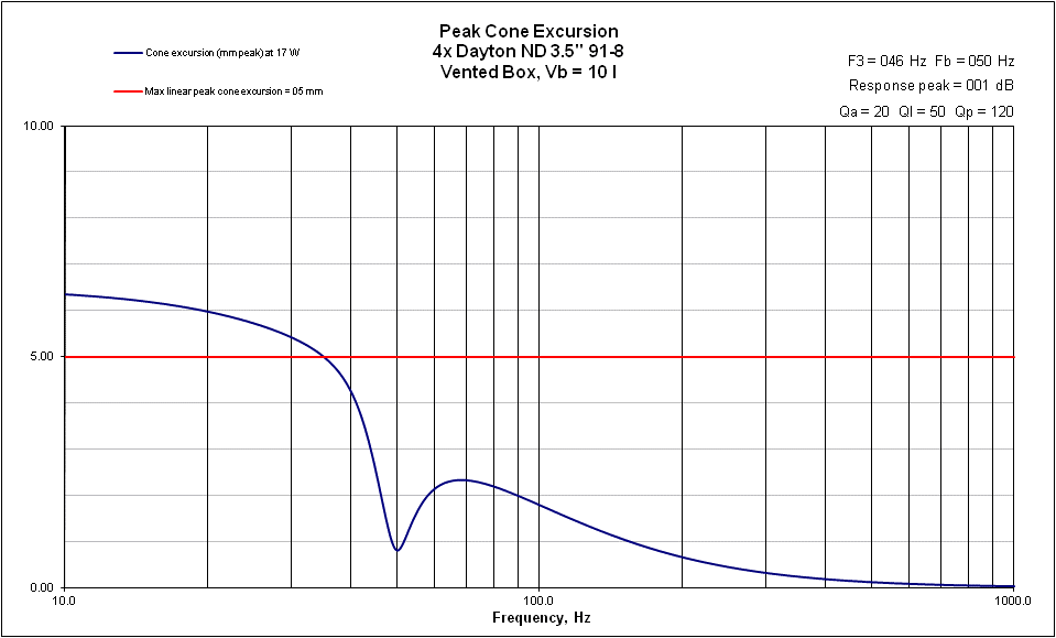

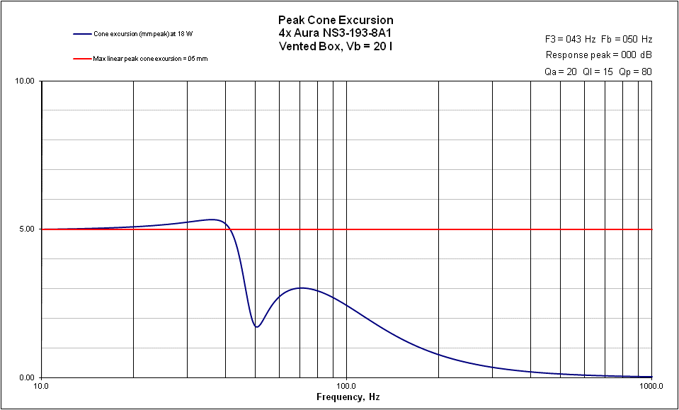

Graphs 2, 3 and 4 show the cone excursion for each of the 3 inchers (again this is with 4 of them) at 100dB 1m. Again not a lot of difference between the Aura and the Dayton but the TB excursion sky-rockets with material below 40Hz. Granted, most musical content is above 40Hz but certainly not all of it. And all drivers stay below mechanical limits anyways and 100dB is probably louder than you're ever going to need.
All sims are based on manufacturers' specs so reality may be a touch different. And of course, other alignments and results are possible too.

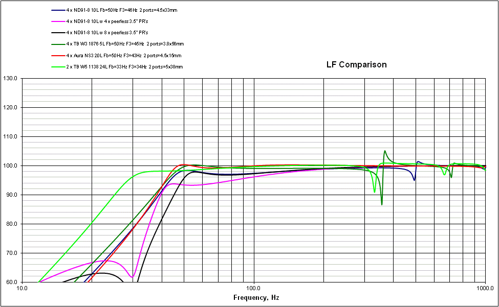

...below is a comparison of all 4 drivers mentioned so far and their low frequency responses.
Except for the green curve (and for it, we hope for some room gain), none of those alignments are particularily nice.

Agreed. I was just trying to compare how low each of them would reasonably go.
Seems the modelled alignments deliberately favour your suggested driver. Poor show
Au contraire. Originally I favored the ND91-8 (that's what I'm using) but think the W5 would be the best choice. But for a 3 incher I finished by recommending the Aura.

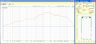

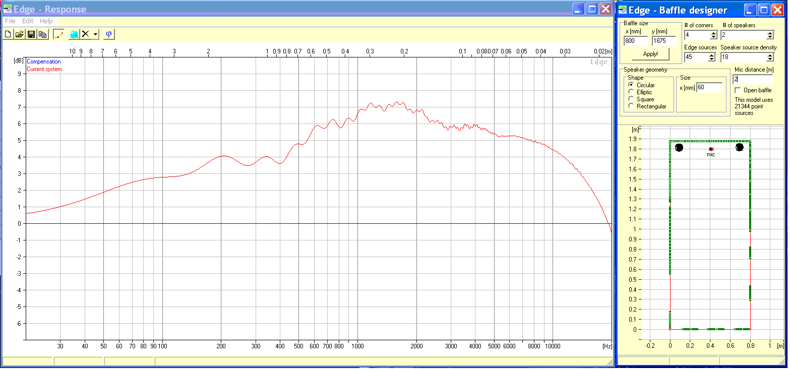

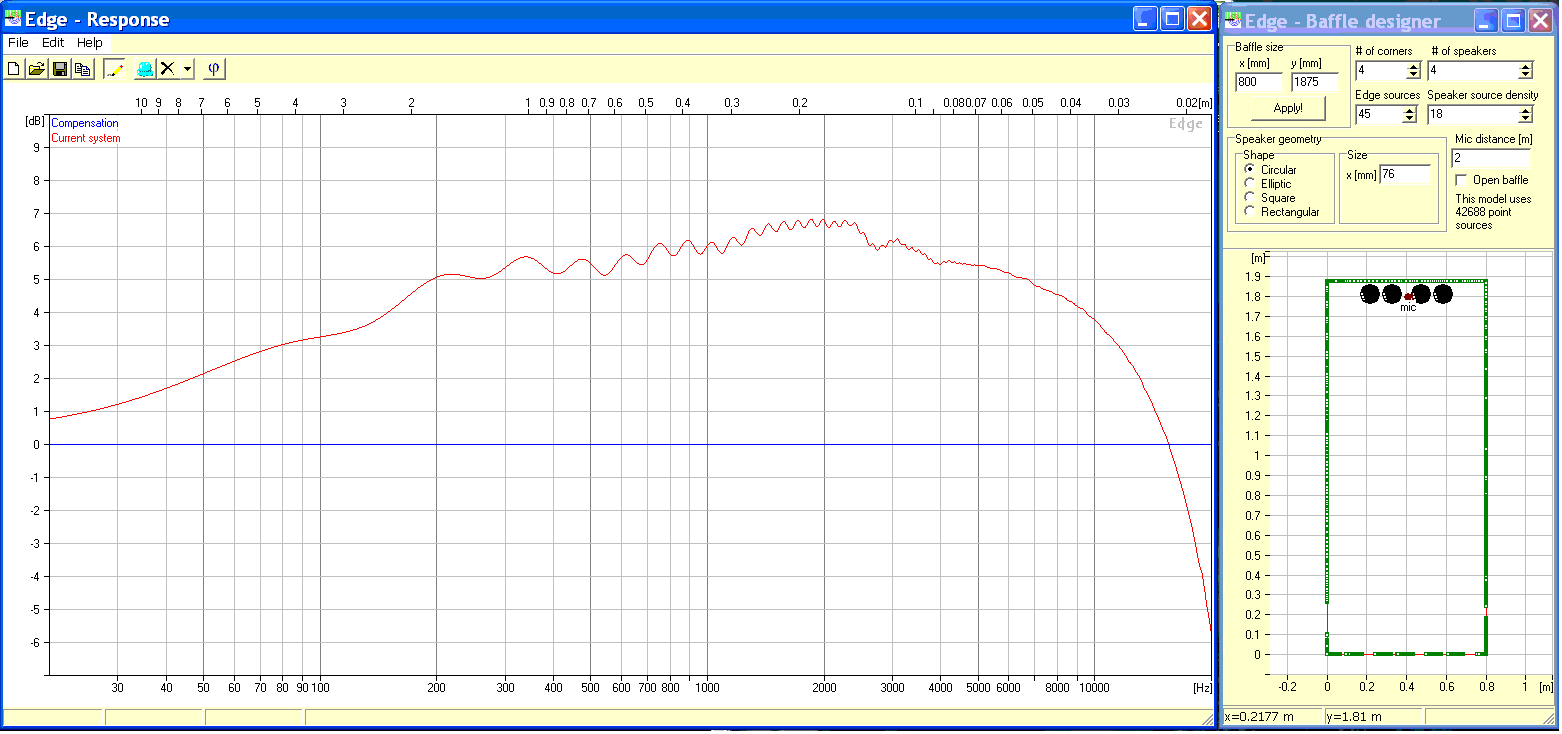

Baffle diffraction and baffle step loss. First graph below shows the diffraction of the 2 Jordans on a baffle on top of a fridge. In effect the baffle and fridge create 1 big baffle surface so diffraction effects are minimal but baffle step loss still occurs, albeit at a low frequency - you are starting to lose SPL at around 500-600Hz. The little bit of diffraction boost that you get between 900 and 2500Hz will actually help to fill in the small dip in that area on the Jordans (Jordon FR, 2nd graph) so that should work out well but you may need to move the xo up 300Hz or 360Hz to match the baffle step loss on the Jordans.
The 3rd graph shows the baffle effects for 4 x the 3 inchers and here you can see that you start to lose bass right around where you want to cross it over. That you are going to have to do something about but I think your amp should be able to fix that pretty well since it's got 3 bass boosts to choose from for the sub out. On 1 of my amps, my bass control gives me a 6dB boost starting at about 500Hz, so if 1 of those 3 is similar that will effectively counteract your baffle step loss. Hopefully.
Simulations are with The Edge. Very easy and quick to figure out and to use: Tolvan Data

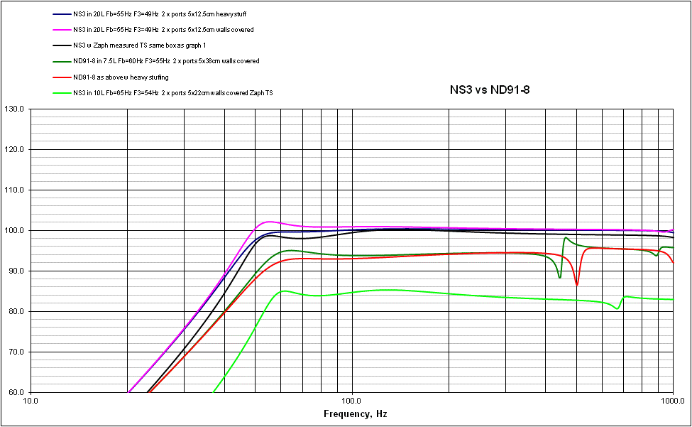

Below are some more comparisons of the NS3 and the ND91-8 to give you more info. Each case is with 4 drivers series/parallel. This time, I'm trying to get the best response I can out of them. To confuse things just a bit more for you, sometimes (well ok, frequently) manufacturers' specs can be a little off from reality so it can help to use someone else's measurements for a more accurate simulation. Zaph has done that with the NS3 and I show the comparison below. Dayton is generally fairly accurate and I'm using their specs here but these might be just a touch off as well. In the end, you might have to fine tune the port for a result that is most pleasing to your ears.
So, the Aura likes a bigger box but can play lower. If you use a smaller box, the F3 has to go up as you can see in the final graph. The ND91-8 likes a smaller box, but the tuning is also a little higher and it needs longer ports. You can see that going with less stuffing gives you the peaking I was talking about. Driver levels btw are adjusted just for the sake of clarity.

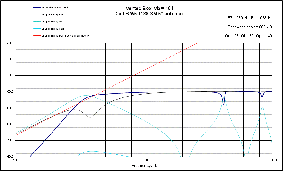

Well, below is what 2 x W5's look like in 16L net using Unibox. The box is tuned to 38Hz giving you an F3 of about 39Hz. Rolloff starts at about 90Hz, somewhere near where room gain starts to increase the response, although I don't know what that will be like exactly in your room.
This is with 2 ports that are 40cm long and have an internal diameter of 5cm. That will allow you about 150W without exceeding xmax above about 34Hz and put you righ close to exceeding the recommended port air speed. With a slot port, the length and cross-sectional area need to stay the same.
So, it looks like you need to reconsider how long your port(s) can be - you probably need to put a right angle in it. Also if you want to go with one or 2 ports. Port length can be diminished if you go with a narrower port, but that means potential port noise can happen at lower SPL's. So you may also want to decide on maximum SPL's in order to determine port diameter and therefore length.

Forgot to mention, the sim is with heavy fill.
And also that tuning higher will also allow a shorter port length. But tuning higher will mean a flatter response before rolloff, which often means too much bass when room gain is added in.
