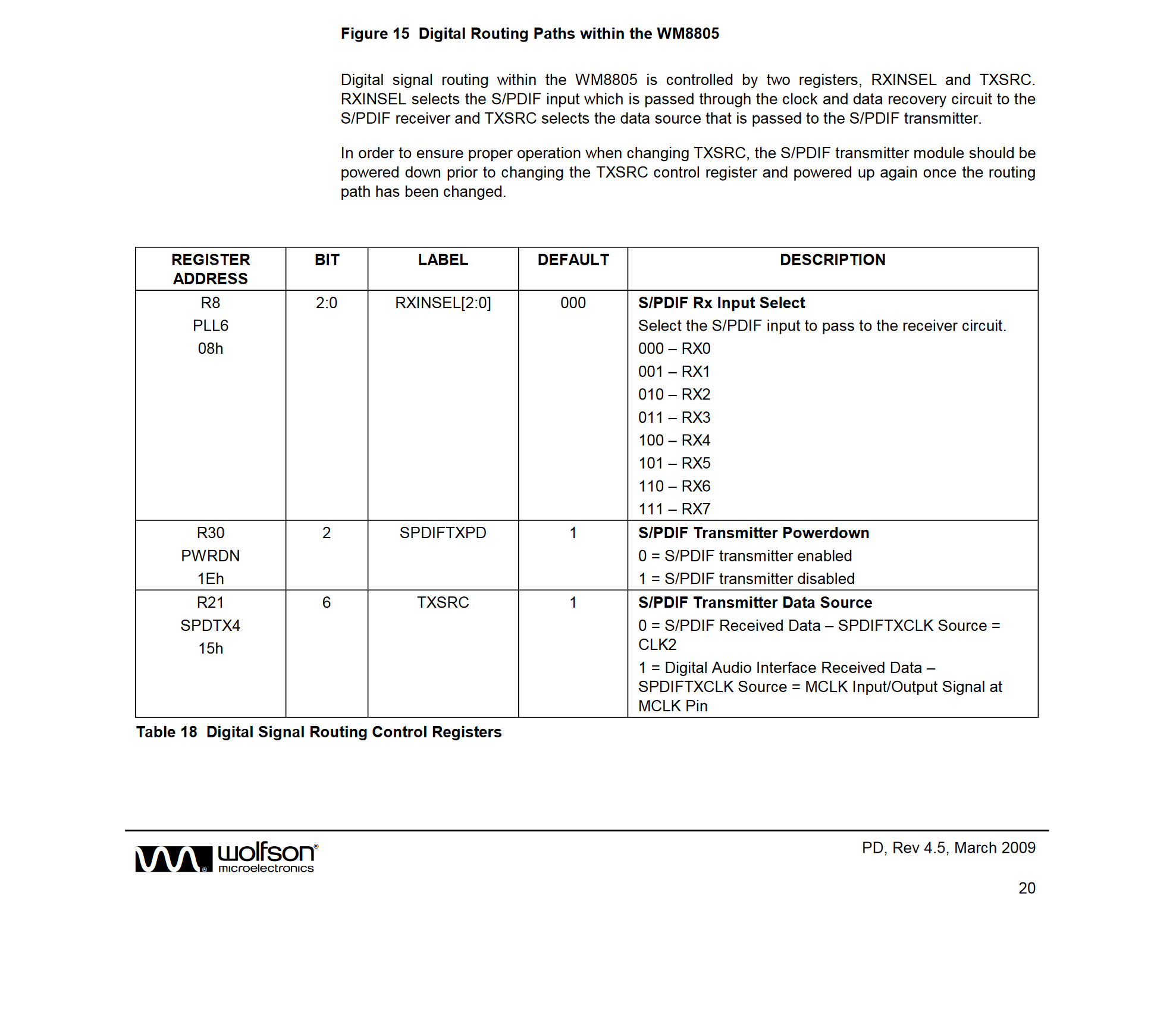

@MRamone: I do not think there is an official ASoC codec driver for wm8805. There is a driver for wm8804 which if you compare the datasheets does not define the PLL6/bits 2:0 which in wm8805 mux the RX inputs. The linux wm8804 ASoC codec driver does not use these bits of the WM8804_PLL6 register. See WM8804_PLL6 usage in https://elixir.bootlin.com/linux/latest/A/ident/WM8804_PLL6 - only clk-related tasks are handled, as supported in wm8804. Therefore the alsa driver does not offer any alsactl mixer control for switching the RX inputs.
Theoretically you could send appropriate I2C commands directly to your wm8805 from userspace, operating the mux outside of the kernel driver. You can play with i2cset to find out.

@MRamone: If the driver does not lock the I2C address somehow to avoid conflicting commands to the device (which I do not think it does), the userspace approach should work. Just read the PLL6 register byte and update it with the required RX input bits. That should be quite straightforward, no need to hack the driver. The Alsa SoC framework is VERY complex, full of fragile macros, it seems a bit of a minefield to a barely occasional hacker (i.e myself).

And thats what I meant - use WM8804/5 overlay for i2s + write a script in python for example to control muliplexer via i2c. -easiest way i guess
Or modify existing overlay i2c part if you feel like you want to:)
Description of i2c registers you can find in documentation https://statics.cirrus.com/pubs/proDatasheet/WM8805_v4.5.pdf
Thats the most interesting part for you:
Reactions: 1 user

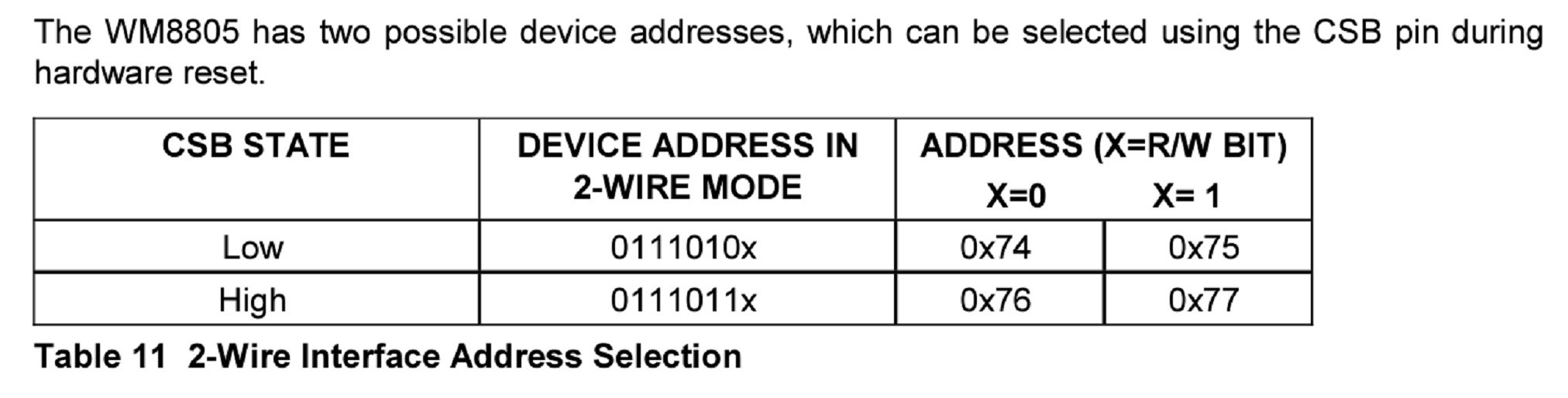

i think i have found an alternative solution if using the driver AND communicating via i2c simultaneously does not work:
Actually, according to the datasheet, wm8804-5 can use two different i2c addresses, 0x3a (58) and 0x3b (59) depending on the status of the pin 9 (CSB) on boot:
The kernel driver expects the pin to high and assumes 0x3b, while for instance the two arduino projects that i know of have pin 9 to ground and use the address 0x3a.
So if all other alternatives fail, i could have two chips: one wm8804 or 5 with pin 9 high (address 0x3b) doing the i2s to spdif tasks using the kernel driver and a second wm8805 with pin 9 low that will be in 0x3a and not locked by the kernel driver, doing the spdif selection tasks and controlled via python/i2c (SMBus2 for instance??)
Not very elegant but seems likely to work....

Well generally it's not nice when one device is being controlled by multiple masters. A driver may assume that what it wrote into a register is there and avoid proper atomic read/modify/write sequence. But the wm8804 driver uses the standard atomic read/modify/write method for writing to PLL6 (the ASoC method snd_soc_component_update_bits does so internally, if you analyze it in https://elixir.bootlin.com/linux/latest/source/sound/soc/soc-component.c#L788 ) and seems to be safe for your purpose.
The TXSRC bit of wm8804/5 seems to be operated by the alsa ctl "Input source" https://elixir.bootlin.com/linux/latest/source/sound/soc/codecs/wm8804.c#L100 so your plan with single wm8805 looks viable and pretty clever for your use case.
