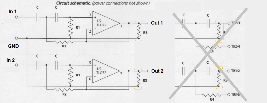

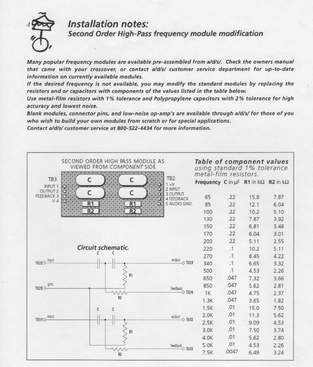

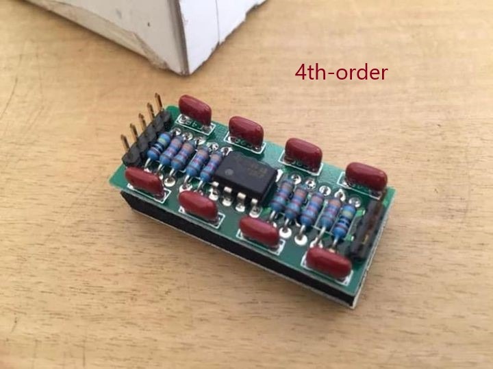

I have a 4th-order high-pass filter crossover module. I'd like to use it only as a 2nd-order high-pass filter.
Please help me how can I rewire it to achieve the goal?

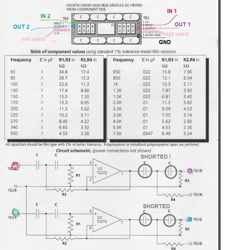

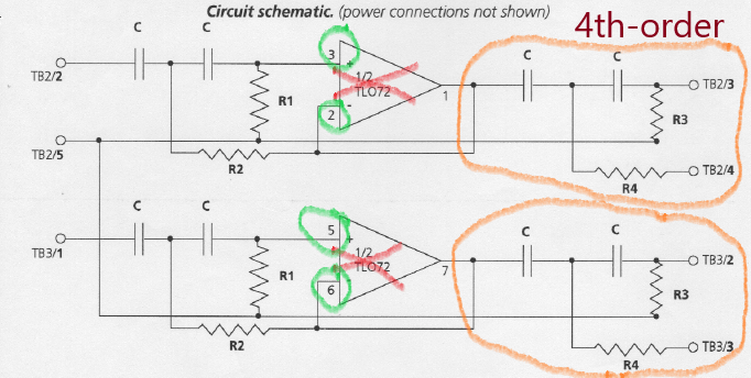

Here is my idea.
I think to completely remove the TL072s out of the board, then, tap the pin no. 2, 3, 5, and 6 of the TL072's sockets to be used.
But I don't know if I can leave the unused components (in the orange circle) at their place or should I remove them as well?
Will this idea work?

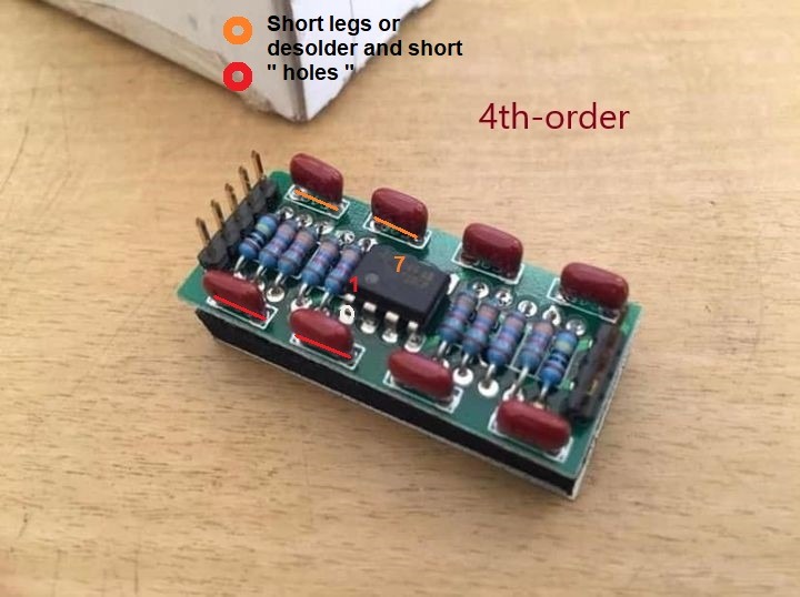

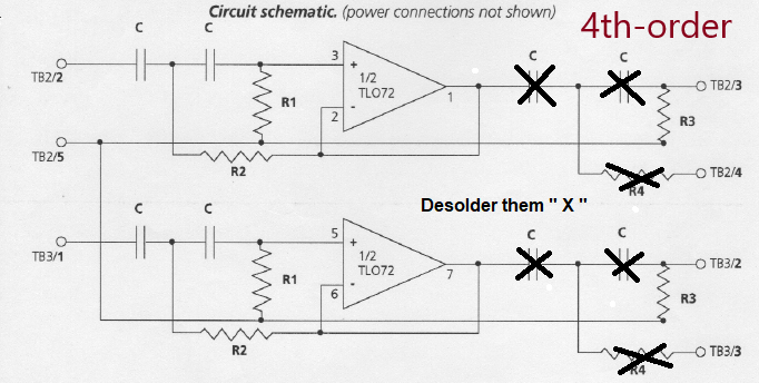

From the original schematic of 4th order you need to desolder these capacitors, you need to track them down on the PCB , Might not be the ones I showed in post #5. Your 2nd order will look like this, with the TL's in place.

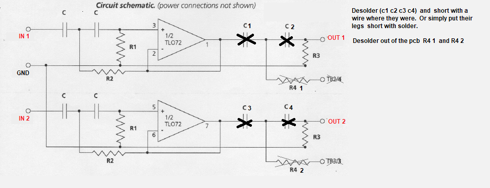

I'm afraid that there may exist another TL072 on somewhere outside the module.
To my understanding, the 4th-order active filter is created by cascading two 2nd-order filters. Thus, each 2nd-order circuit have its own TL072.
And the TL072 presented on the 4th-order module is a part of the second 2nd-order filters. However, this is only my assumption.
The simplest solution is to add two wires, one from each op-amp output to the corresponding module output, and leave everything on the board. The capacitors of the second filter section are then bypassed. Restoring the modules to their original state then only requires the removal of the two wires.

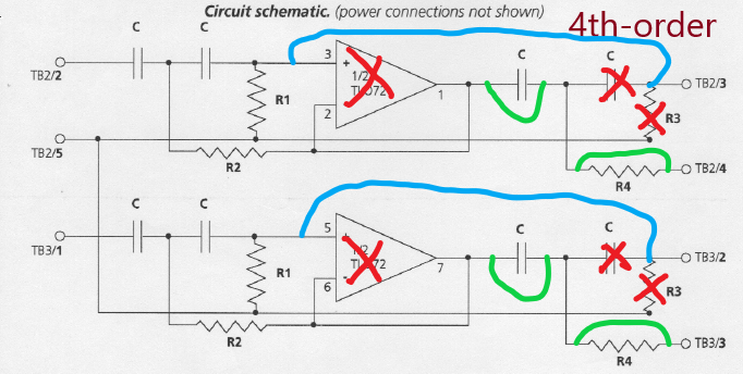

Here is the new diagram that I try to draw by myself.
Can anyone please check it whether it would work or not?
The red crosses refer to removal. The green lines refer to bypassing. And the blue lines are adding wires.

Now, I’m thinking it may be easier to build a second-order module than modifying the existing fourth-order module. What do you think about it?
However, since I have very little knowledge about designing the PCB, could anyone please help drawing the PCB schematic regarding the picture attached in post #9?
