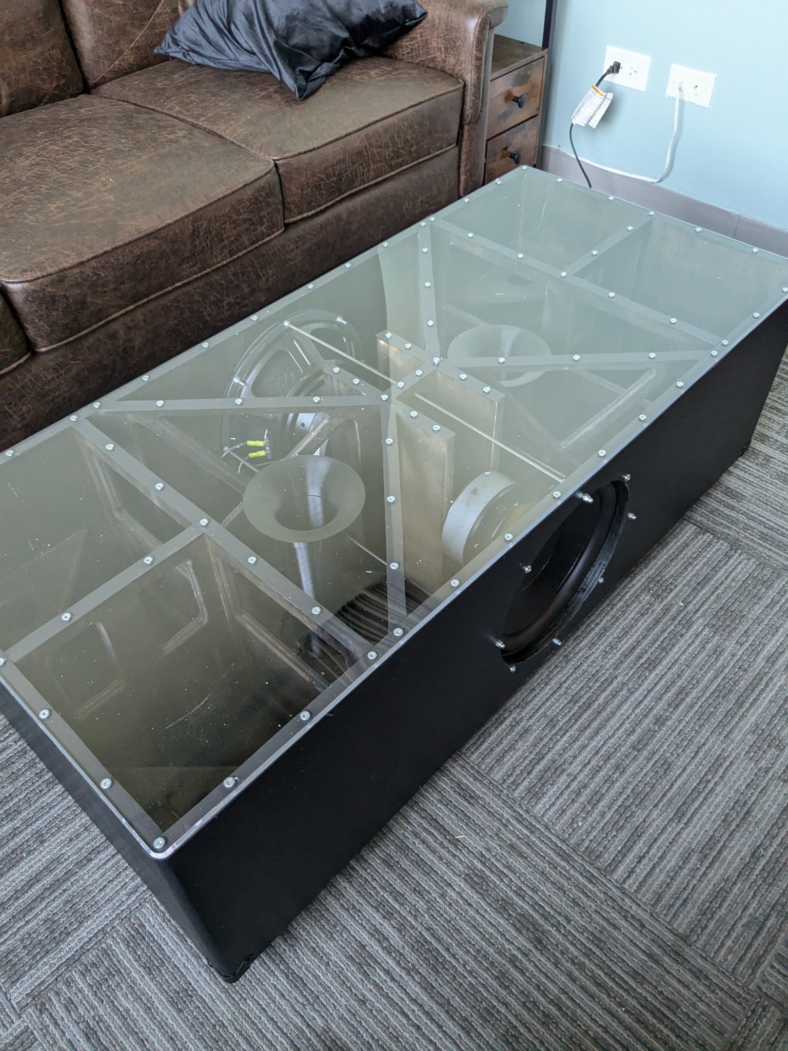

This is for my office. I run the fabrication shop of a highly regarded engineering consulting firm. This is my space to "show off". I definitely did not need a push push sub that doubles as a coffee table. I definitely do not need it to hit to 16 Hz. It did not need to have a clear top. But wow is it super cool to listen to and look at.
And I do not need a 3 way on my desk man will it be cool when I do.
I think hifi isn't all about practicality. If it were, we would all just listen to 2 way studio monitors.

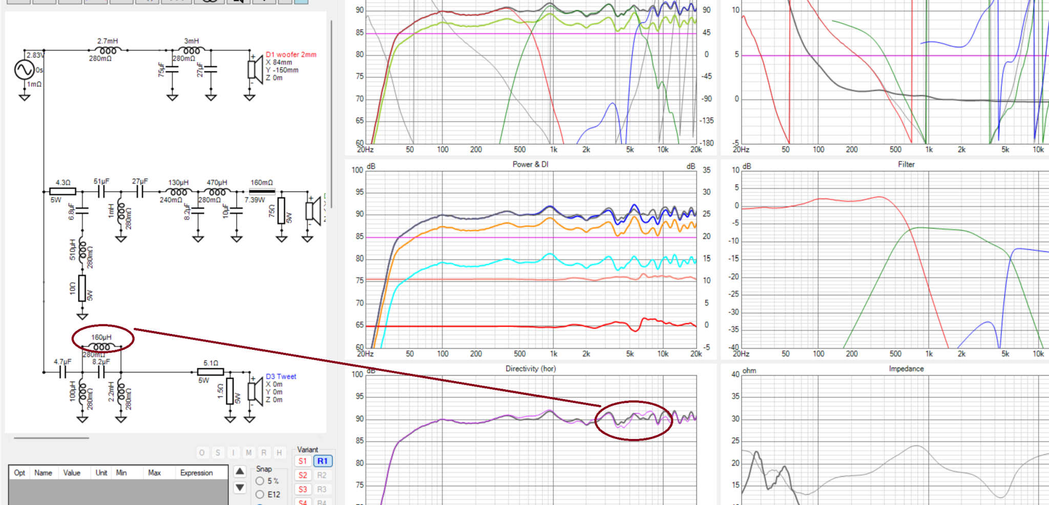

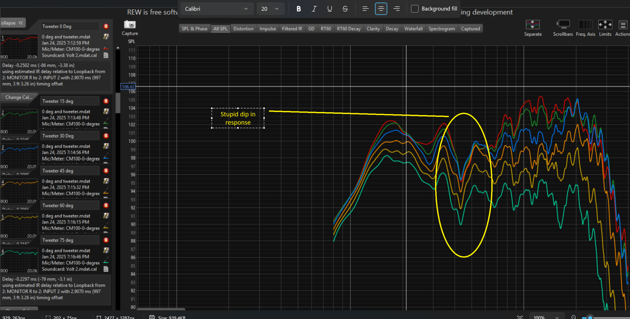

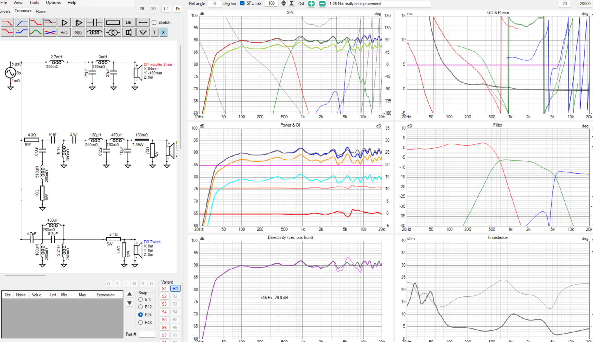

On a separate note, I have been messing with this XO inbetween today's activities. I really got nowhere. I came back to the same XO over and over. I pushed the XO lower to no avail because of this dip in the tweeter response messing everything up.
Pushing it higher makes the lobing worse (we are going to stick to calling it lobing until someone figures out if its something else).
And then....... I just took an inductor and stuffed it here. It puts an odd kink into the lower end of the filter but it makes the XO so steep that the lobing is pretty much rememdied.
I will take some measurements inside of the actually office tomorrow. We shall see what difference it makes being in the actual room.
I would think they would lobe less the closer they are. I can visually imagine lobing in my third eye but I'm just not understanding why I wouldn't always have this issue if that's what it is.

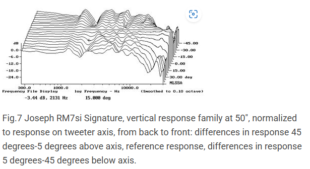

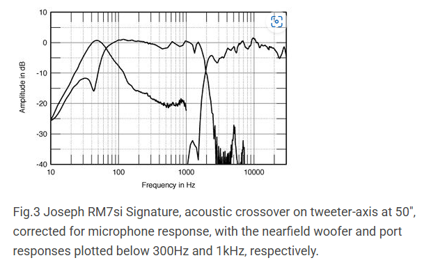

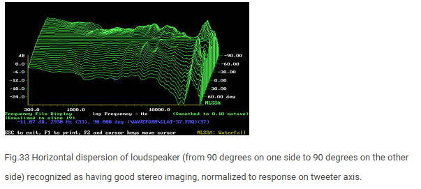

Not in an appreciable way if the driver spacing is closer than 1/4 wavelength at the cross point or if the crossover effective slope is very high with sufficiently small spacing. Joseph Infinite Slope is one approach to this, but there's still much more response variation vertically (see below and note JA's positive comment about it even though it's not perfect).Wouldn't any and all drivers lobe no matter how close or far they are?
But yes, most normal speakers do experience crossover lobing and poorer response off axis for the axis where the drivers are spaced apart. That's one of the points I was getting at earlier with the vertical response plots. The vertical plot is half the range of the horizontal, but the vertical plot is normally much more chaotic in general once you get into the range where the high cross point is influencing things (other than for co-ax's, as you noted).
https://www.stereophile.com/content/measuring-loudspeakers-part-three-page-7
https://www.stereophile.com/content/joseph-audio-rm7si-loudspeaker-signature-measurements-part-2
"In the vertical plane (fig.7), suckouts develop in the crossover region more than 15 degrees above or below the tweeter axis. This is quite a window, presumably due to the minimal overlap between the drive-units. The speaker will be relatively unfussy when it comes to stand height."

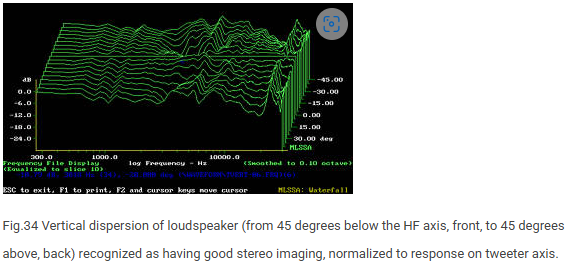

So here's the horizontalBut yes, most normal speakers do experience crossover lobing and poorer response off axis for the axis where the drivers are spaced apart. That's one of the points I was getting at earlier with the vertical response plots. The vertical plot is half the range of the horizontal, but the vertical plot is normally much more chaotic in general once you get into the range where the high cross point is influencing things (other than for co-ax's, as you noted).
This used to be absolutely chaotic before I dug into it with filter components. I do not like the jump at 5500hz but I cannot fix it without ruining other aspects. I'd much rather have a dip than a bump. I know from car audio that bumps are what make systems sound harsh. Better to have drivers not quite crossover so there's a dip than have them cross into each other have them combine into a harsh tone at a specified frequency.

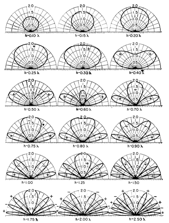

We usually look at it in terms of two points with a distance between them. The reality does include their sizes and can be a little different. I typically measure polars and calculate power after crossing to make finer adjustments than the simulation allows, but I'm only saying this now to make a point.
This is the source of the problem. Vertically offest drivers have lobes in the vertical plane, Horizontally offset drivers have lobes in the horizontal plane.The drivers are not vertically aligned.
There is a good visual representation of what happens in this article
https://www.prosoundtraining.com/2013/01/25/tweeter-placement-two-way-loudspeakers/
With a tweeter and mid it is generally impossible to have the crossover frequency be low enough for this not to present as an issue
A very steep crossover sometimes helps in one axis, but creates bigger problems in the other axis or off axis. Since you have both vertical and horizontal displacement - I return back to my "measure it on the desk where it will be, from the position of your head" and design as best you can for that. And if 15 degrees off-axis is the most linear - then just point them straight out. They don't need to point at your ears. If there will be a wall beside and to the back - include in your measurements. This is a "custom" speaker, for a specific use-case. Don't torture yourself too much 🙂
