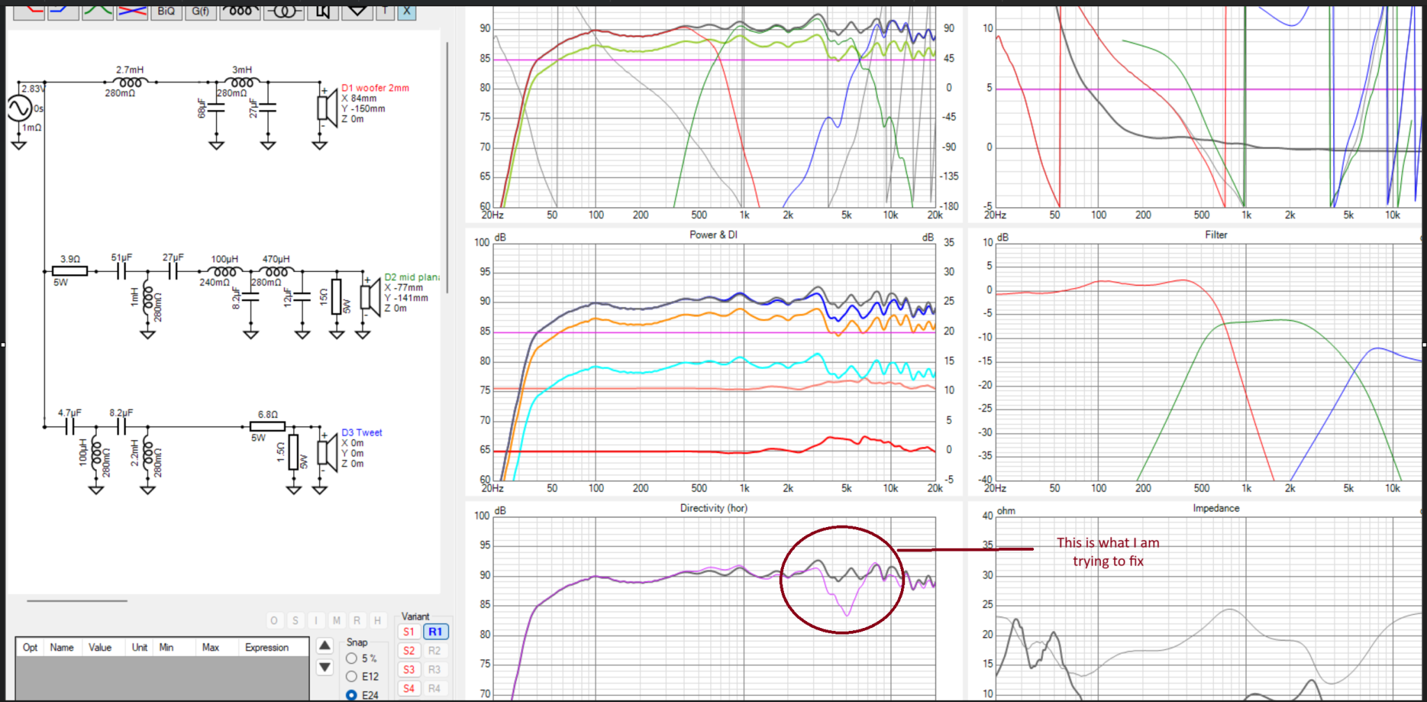

Here is the current XO. You can see how big of dip there is at even just the 15 degree mark

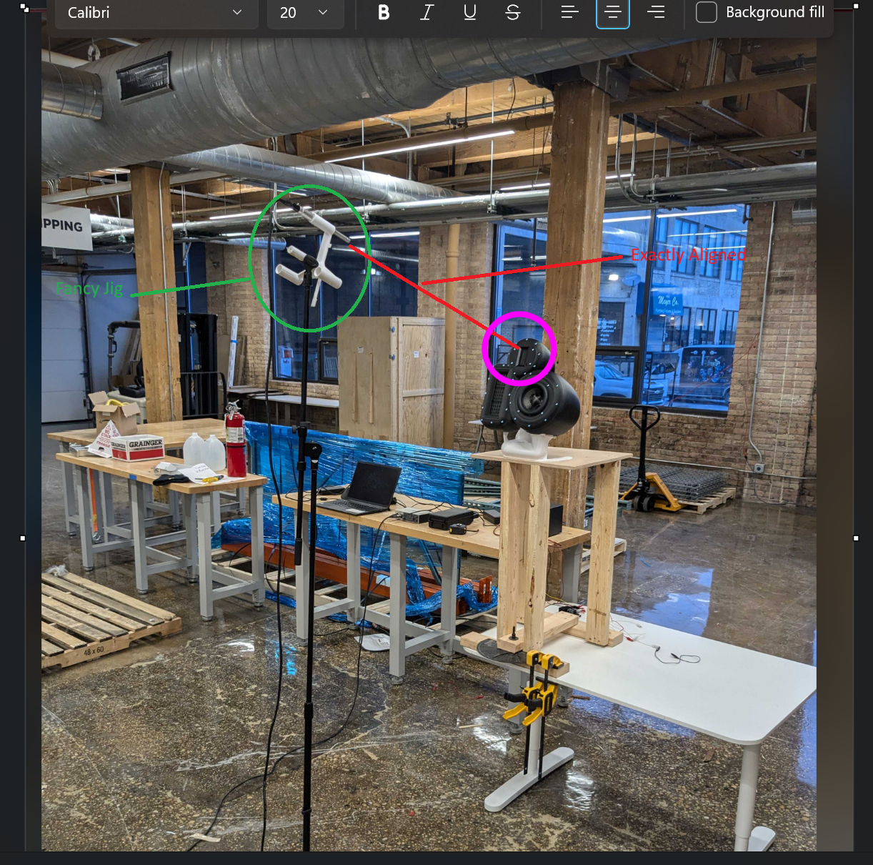

I took these measurements with a jig so that the microphone was positioned exactly at the front of each driver when taking the measurement. It was aligned with the face of the unit so that the Z offset would be taken with the data.

This is the dip I am trying to fix. I removed everything except 0 and 15 degrees off axis to better show what is happening.
Not sure that's phase related in the directivity graph. More like comb filtering at the mid/tweet crossover. Phase graph shows reasonable phase alignment between the two. You displace the mid and tweeter in both x and y axis - so the usual directivity dips will occur in both the horizontal and vertical axis (as @mattstat has mentioned above). At least this is how I see this. I think this is a compromise you will need to live with to have this arrangement of drivers/baffle/cabinet.

There is a slight gap between the mid and the front baffle. I'm not at the shop so I cannot take a picture.Not sure that's phase related in the directivity graph. More like comb filtering at the mid/tweet crossover. Phase graph shows reasonable phase alignment between the two. You displace the mid and tweeter in both x and y axis - so the usual directivity dips will occur in both the horizontal and vertical axis (as @mattstat has mentioned above). At least this is how I see this. I think this is a compromise you will need to live with to have this arrangement of drivers/baffle/cabinet.
Essentially the front face piece is offset from the face of the mid planar by 1.5-2mm. Could this be causing a reflection inside which then causes the comb filtering effect?
I can seal up that area with gasket material so it goes straight up from the mid planar to the "waveguide" instead of it getting trapped in there.
I didn't both because I noticed that most front loaded horns and waveguides are offset a bit form one another.
Do you think this is worth investigating?

I don't think so. Seems too insignificant. I think it's just the two drivers playing together.There is a slight gap between the mid and the front baffle. I'm not at the shop so I cannot take a picture.
If you want to run an experiment... Consider getting some f26 industrial felt and cut out "felt frames" to go around the mid and the tweeter. Kind of like felt wave-guides in a way. I'd make them at least 1cm wide or wider, and have the openings tight to the planar openinig (attach with double sided tape to the drivers). It's thick felt and it is ugly - so not a solution - but you should be able to measure the effect on diffraction and possibly comb filtering and at least you can be certain if that is what you need to work on.

Your image seems to show the microphone aligned with the ribbon.I understand that the planar is very long and I have taken the measurement at the center of it

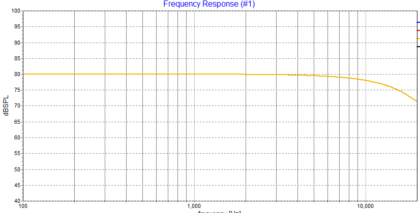

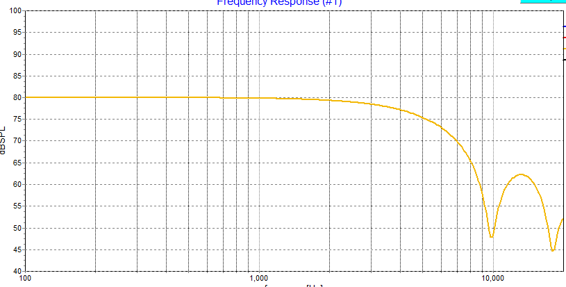

So let's take a 6.5 inch diameter driver (about the height of the planar, I think) and look at its off-axis response, assuming perfect pistonic behavior:
5°
15°
These effects are just path length difference issues related to the driver's size and getting off axis.
