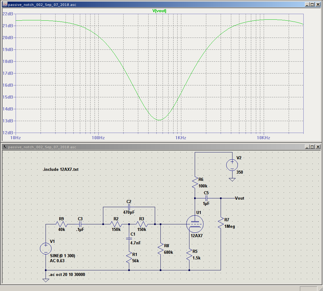

A few minutes tinkering with a mistuned tee filter got me pretty close to your favourite SLO curve. This circuit has very little loss except at the notch frequency, in fact, I had to dial down the virtual input voltage level in LTSpice to mimic the (-4dB) level of your SLO curve.I more or less was trying to mimic the response of my fav settings from a SLO tonestack.
If you make the 68k resistor variable, you can dial the depth of the notch up or down. But this is strictly a mid control, as bass and treble responses are fixed.
I'm attaching both a screen capture, and the LTSpice simulation file (.asc), for your tinkering pleasure.
What do you think?
-Gnobuddy

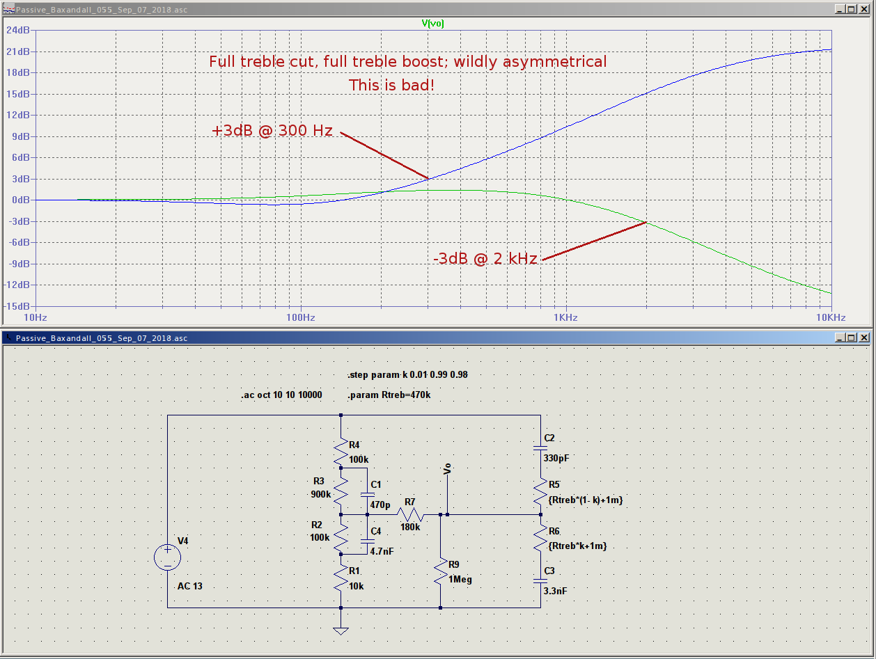

When I first sat down to simulate it, this is what I was expecting, because the active version (popularized by Baxandall, and used in Hi-Fi for decades) is virtually textbook-perfect. A beautiful thing, as you say. I used it a lot in my DIY Hi-Fi days.The James...10:1 ratios...It is a beautiful thing in graphs.
Sadly, the passive James (?) tone control we are discussing here is not very nice at all. IMO, it's more of an ugly mess than a beautiful thing.
As just one example, take a look at the attached screenshot. Set to full treble boost, the +3 dB corner frequency is 300 Hz. Set to full cut, you would expect the -3 dB corner frequency to be the same 300 Hz.
Instead, you get - wait for it - 2 kHz. 😡 Nearly an order of magnitude higher. 😡
Needless to say, with hugely different corner frequencies, the treble cut curves are nothing like the treble boost curves.
I originally simulated it with a 1M load. The bass end of the response droops a couple of dB, because of the voltage divider formed by the two 150k resistors and the 1M load.Gnobuddy's Tee would also work. It should be checked with a non-infinite load.
So I would suggest running the output straight into the grid of the next valve, and putting a 1M resistor from input of the Tee filter to ground, to make sure that grid is ground-referenced. The 1M resistance at the input will add very little additional loading to whatever previous stage is driving this Tee filter.

I tinkered a bit with the Tee filter, adding a 40k source impedance to simulate a preceding 12AX7 triode, and adding a simulated 12AX7 triode to the output.
Curiously enough, I got the flattest response (equal bass and treble levels outside the notch region) with a 680k grid bias resistor for the following gain stage.
Screenshot attached.

Except for the special-case of undoing unwise equalization, I'm not sure why they should mirror? Your reasons for doing cut are usually different from your reasons to do boost.
I do agree that the James tends to boost far down in midrange or else has limited effect by 10KHz. But that does give a "Wow!" boost, sells the product.
You are not going to do better with a passive network.
The Bax IS better because it uses Linear tapers and can be true symmetric (pretty graphs), at the cost of integrating a gain-stage into the EQ.
In real life, I was fond of James as a party tool. But have not had one in decades.

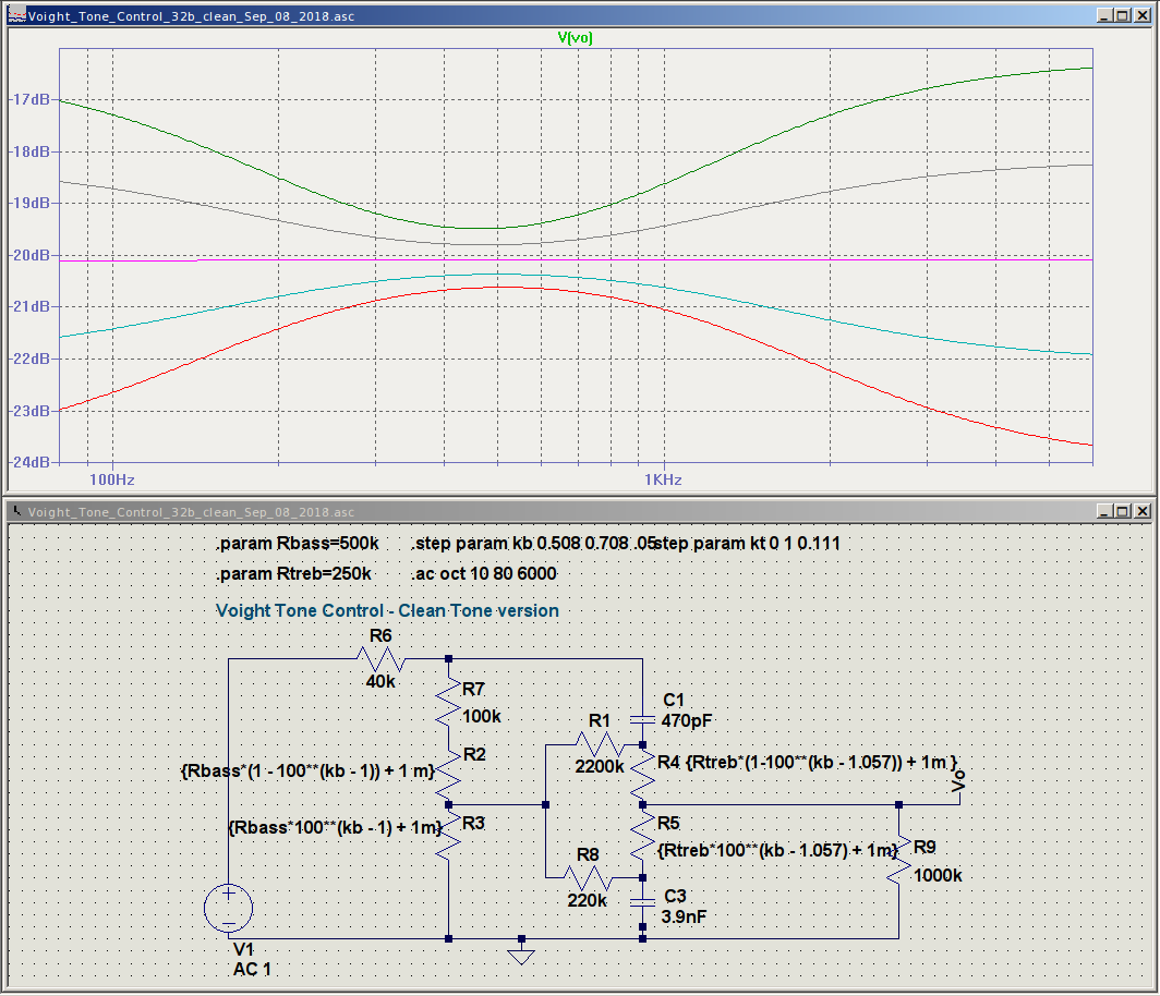

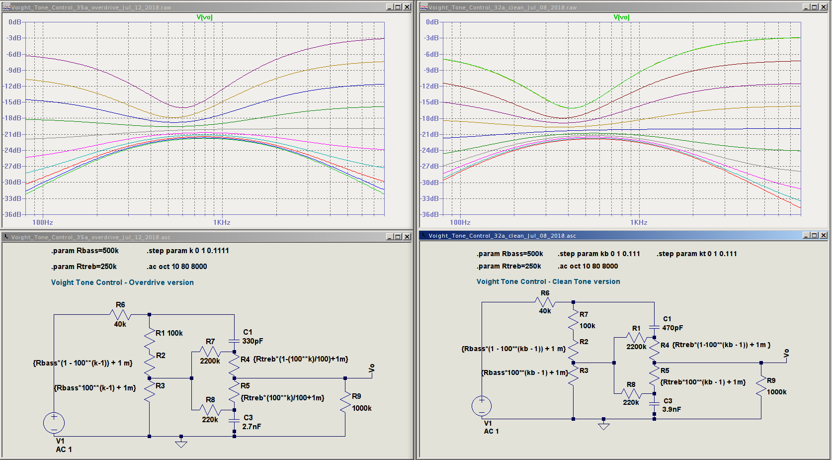

So far, my favourite passive tone control is a heavily tweaked version of the Voight tone control from Merlin Blencowe's preamp design book. Screenshots and .asc file attached.You are not going to do better with a passive network.
The tweaked Voight is not quite as nice as an (active) Baxandall, but is not bad at all. Both pots are logarithmic. There is very little interaction between treble and bass controls, and for the most part, EQ changes quite smoothly and predictably with control rotation.
The flaws are fairly minor: midrange gain does change slightly from full boost to full cut, and control response does tail off a little bit for both bass and treble at full cut.

I don't think that would change anything. The notch filter pretty much sees the grid bias resistor of the next valve as it's load, whether that valve is part of an LTP or not.How would the sim look with a LTP as U1 (second gain stage)?

The Voight is a clever thing. What I wonder about is the great different in slopes, boost or cut. Slope often is more obvious than nominal corner frequency. But it sure is simple. And seems to lack the small wonkiness the James can get through the middle.
For small cuts and boosts, the Voight is almost perfectly symmetrical - astonishingly so! See attached files.What I wonder about is the great different in slopes, boost or cut.
You're right, it's not as perfect at full boost and cut. But it's still much closer to perfect than the usual Fender TMB circuit. In use, my fingers don't notice any issues with the Voight, and the controls feel smooth and predictable, probably in part because I rarely find myself using those extreme tone control settings.
For this simulation, I picked the central value of "k" (pot position) carefully to showcase the flat-response setting, which is again astonishingly good - virtually perfectly flat. Other than that, the simulation isn't tweaked in any way - just small, equal value steps in pot rotation on both sides of the central, flat-response setting.
