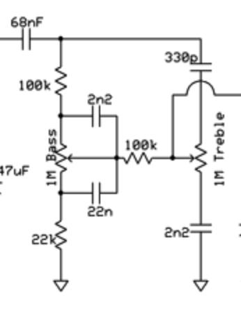

I am working on a guitar pre-amp as a pedal. found milions of schematics and layouts and finally picked up one to build. my choice is "Green Citrus" because it sounds very like "Holy Mountain" by "Midnight Amplification" my project is almost done, pcb is here and all elements are in place. when i tested this preamp i have found that 'Treble' knob doesn't "do" much, the difference is barely noticed by ear.
the questions are :
1. what kind of filters are being used here ?
2. how can i affect those filters ? (what happend if increased and decreased)
the piece of schematic responsible for the tone is attached to this post.
Thank You in advance for help

That is what is called a 'passive' tone control network. These have quite a high attenuation (it cuts down the signal) and they also have more limited boost and cut compared to the more usual 'active' type that would need either a transistor or opamp to add gain.
Its very important that you feed the circuit from a low impedance source (less than around 1k) and that you take the output to a high impedance (1meg or more). Not doing that will affect the way the circuit works.

The transistors provide the correct operation conditions I mentioned (low Z to drive it and high Z that it feeds into) but it is still what we call a 'passive' tone control. An active tone control incorporates the filters within a feedback network around the transistor or opamp.
So you want to change the frequencies. In a way its trial and error for you to get the effect that you want. Increasing the 330pF cap (say to 680pF or 1000pF) will make the treble control work lower down the frequency range... so more noticeable. Increasing the 2n2 that goes in series with the treble control will cut more treble out as you turn the treble down. Experiment and see what suits you best.
http://makearadio.com/tech/tone.htm
- its a "James" tonestack or "passiv Baxandall"
- for more Treble increased the 330p Cap. (see attachment)

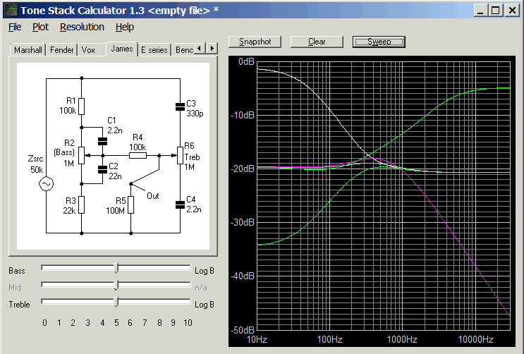

just a little helper for question like this...
tone stack calculator
TSC
good luck

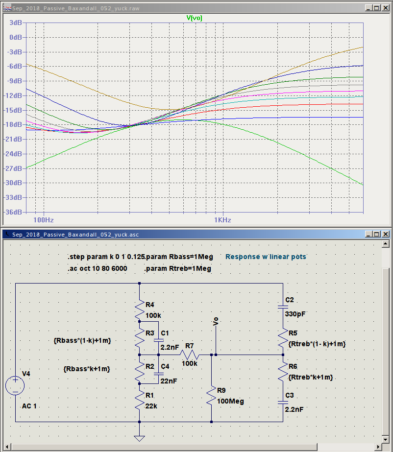

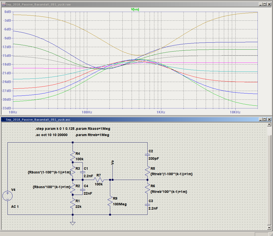

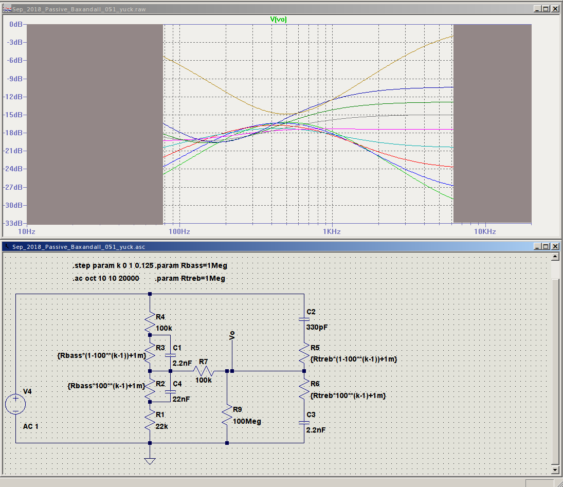

I have the feeling Tone Stack Calculator presents a rather rosy picture of the passive Baxandall tone control circuit. TSC shows only the full boost and full cut curves, which can hide much of the ugly behaviour of a circuit. And the passive Baxandall tone control seems to be quite an ugly circuit!
(The active Baxandall, by contrast, is extremely well behaved, which is why it became the standard for Hi-Fi for many decades.)
A well behaved tone control should have these qualities:
Some notes about the attached images:
-Gnobuddy
- Cut and boost curves are symmetrical.
- Equal changes in pot rotation produce roughly equal changes in cut and boost.
- There is sufficient control range within the frequencies of interest.
- There is a central flat-frequency setting.
- The bass and treble pots do not interact with each other.
- The equations next to the potentiometers are to simulate the normal "10% audio taper" pots, i.e., logarithmic pots with 10% of full resistance at the half-way setting. I deduced these equations myself.
- The second image shows what happens in the frequency range relevant to electric guitars, i.e., from 80 Hz to maybe 5 - 6 kHz. The weak and wildly non-linear bass control response speaks for itself.
- The full treble cut curve in my simulation differs from the same curve as posted by PRR using Tone Stack Calculator, because at the zero position, the pot equations I used still have 1% of total pot resistance, rather than exactly zero. 1% change in resistance should not produce enormous changes in frequency response in any well-behaved tone control circuit...
- The other three full cut and boost curves match the ones from Tone Stack Calculator.

...Tone Stack Calculator .. shows only the full boost and full cut curves...
...the passive Baxandall tone control seems to be quite an ugly circuit!...
Baxandall's name should not be applied to the passive network. (If you must use a name, James wrote the paper usually cited.)
TSC *can* show the complete response for any sane number of knob setting.
Okay.Baxandall's name should not be applied to the passive network.
Excellent, that's very useful when it comes to tone controls.TSC *can* show the complete response for any sane number of knob setting.
-Gnobuddy
I should have noted: TSC will let you see the curves *interactively*. You can discover interacting things that are not shown by a SPICE sweep, even a nested sweep.

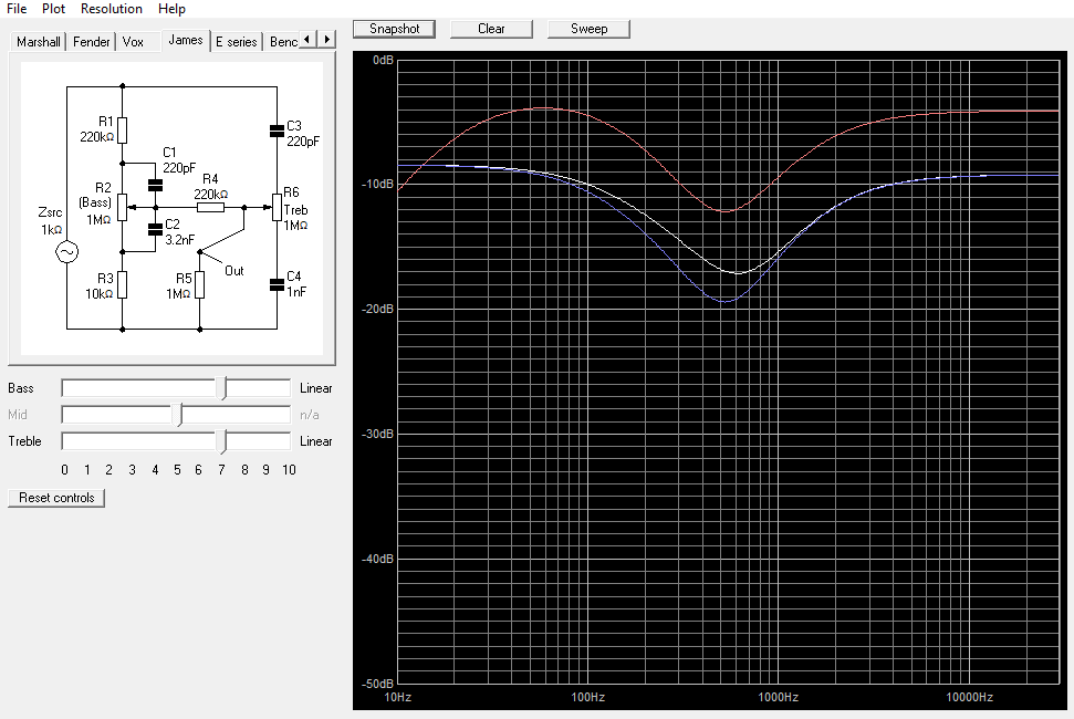

I tinkered with TSC some years ago, before I had learned how to use LTSpice. Those sliders seemed useful at first sight, but I found that having a static snapshot of several frequency response curves was a much better visualization tool, at least for my brain. So for me, TSC is a distant second place in terms of being able to see what the circuit does.I should have noted: TSC will let you see the curves *interactively*. You can discover interacting things that are not shown by a SPICE sweep, even a nested sweep.
But to each their own. I've been around enough smart technical people to know that we don't all see or process things the same way. The more good free tools are out there, the better for all of us.
-Gnobuddy

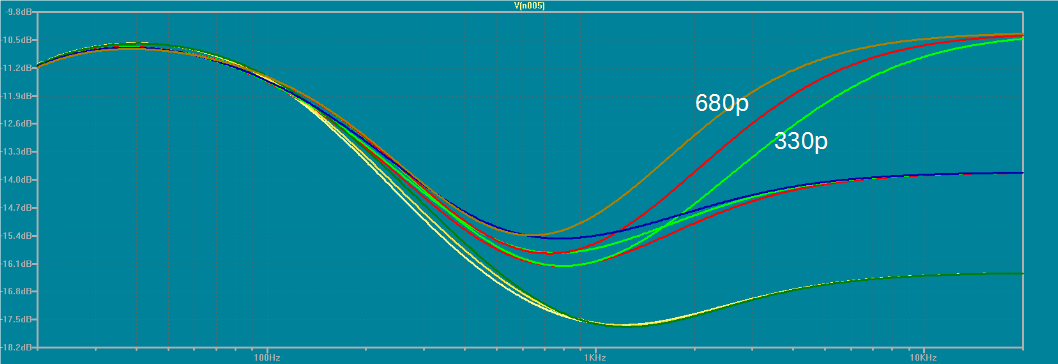

Perhaps there is some magic set of component values that makes this circuit behave well, but if so, I have failed to find them. I've simulated several variants from various sources attempting to do so, without any luck.
After many moons messing with it, I finally came about values that "look good". Hopefully sooner than later I'll have the chance to test it out.
I more or less was trying to mimic the response of my fav settings from a SLO tonestack. The values needed to get there seem a bit screwy, but I don't fully understand the James TS anyways.
The red curve is the Soldano set to T6 / M4 / B5.
The James TS settings were 7 for both T/B. I guess I should have did a full sweep 😎
White curve is James with C2 set to 2.2n. Increasing C2 to 3.2 (approx a switchable parallel 1n) decreases low mid response a decent amount, represented by the blue curve. BTW, this is assuming being fed from a CF.
It's rather lossy, but I couldn't smooth out the response unless I used large resistors at R1 and R4. I don't particular care unless it actually sounds lossy.
EDIT: It just occured to me that I should scaled the values to suit the source Z. I'mma dumby... 😕
