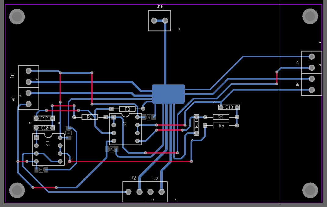

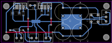

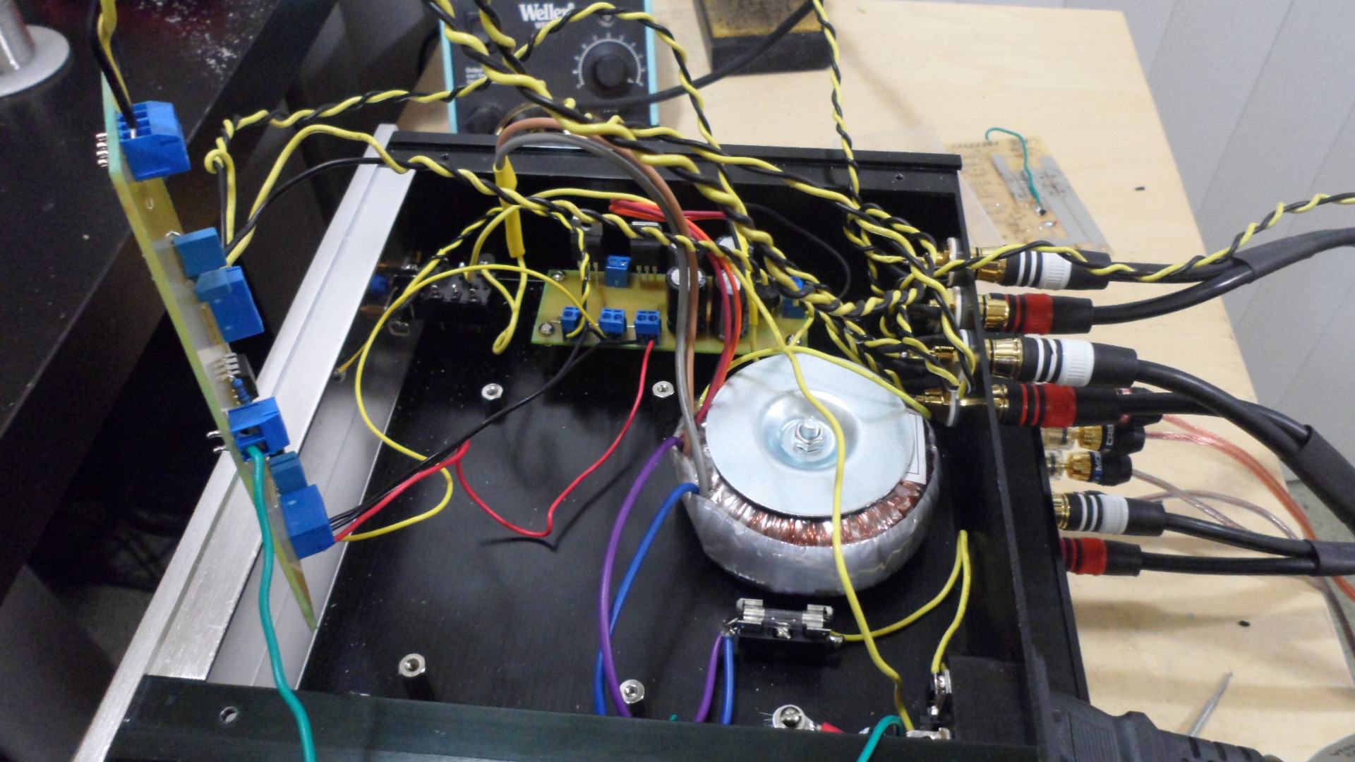

I'm having ground loop issues when connecting my active crossover to my amp. When my amp is hooked up to my speakers without any input (rca's unconnected), the speakers are completely silent. My amp's chassis and power supply ground is connected to earth ground.
However, after connecting my active crossover (pictured) to my amp, I get ground loop hum. If I leave the earth ground unconnected (the green wire in the first pic) the hum is gone. Just to summarize:
Amp (earthed) + Active Crossover (earthed) = hum
Amp (earthed) + Active Crossover (unearthed) = silent.
It doesn't matter which ground I connect the earth ground in my active crossover (power supply ground, speaker ground, etc), the hum happens when its connected.
I've attached pics of my setup and my layout for both the active crossover power supply and the main board. If you'd like anymore pics or tests for me to do let me know.

You did mean to say that your amplifier's signal ground is connected to chassis (mains protective) ground?
Is the signal ground of your active filter(s) also connected to chassis and protective ground again?
If so, the answer is there - the signal ground of the crossover unit should not be reconnected to protective
ground via another mains loop.
There are safety issues with floating the signal ground above chassis ground but commercial signal processing
devices are typically isolated or otherwise known as "double insulated" which avoids this chain of secondary
grounding problems. For a basic overview -
Yes, but not directly. In my amp, the chassis ground is connected to the power supply ground, and the power supply ground is connected to the signal ground (but not at the exact same point).
Earthing (Grounding) Your Hi-Fi - Tricks and Techniques
Yes, my active crossover is connected the same way, earth/chassis ground eventually connects to signal ground.
So are you saying is that by design, active filters and processors are *not* suppose to be connected to chassis ground?
Just connect the signal ground to the chassis using 10ohm resistor, instead of direct connection, in the crossover. This is easy test. If it will be successful, than You can use 10ohm/5W resistor, parallel with 100nF ceramic capacitor.

Maybe I'm just lucky but when my system was tri-amped, the preamp, the crossover and all three stereo power amps had the line ground connected directly to the chassis, all circuit grounds connected to the chassis and there was no hum problem. The trick is where those connections should be made.
There should never be current flowing in shields, one of which is the chassis. I connect mains ground to the chassis right where the module is, or the cord comes in. Everything else connects to a master ground point, which is usually located at the power supply, and that point also connects to the chassis at a single point close to the power supply. Most RCAs have ground wires that also run to the PS master ground, though my power amps usually mount the RCAs right to the chassis. Finally, everything plugs into a power strip, never into widely separated outlets.
Probably not to the best theory, but it works without fancy ground breaks using resistors or diodes.
