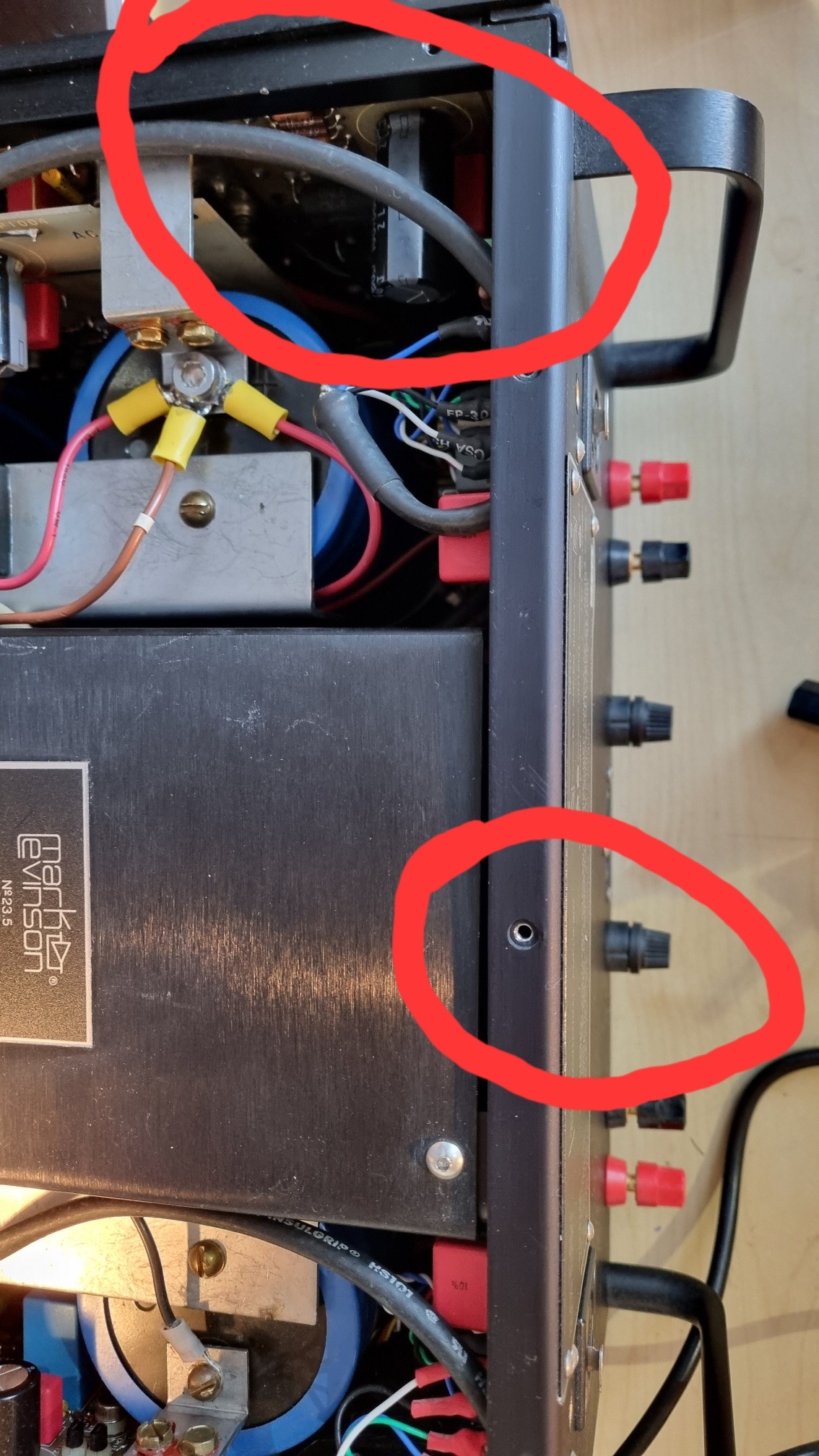

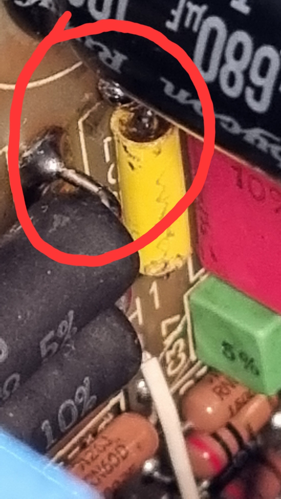

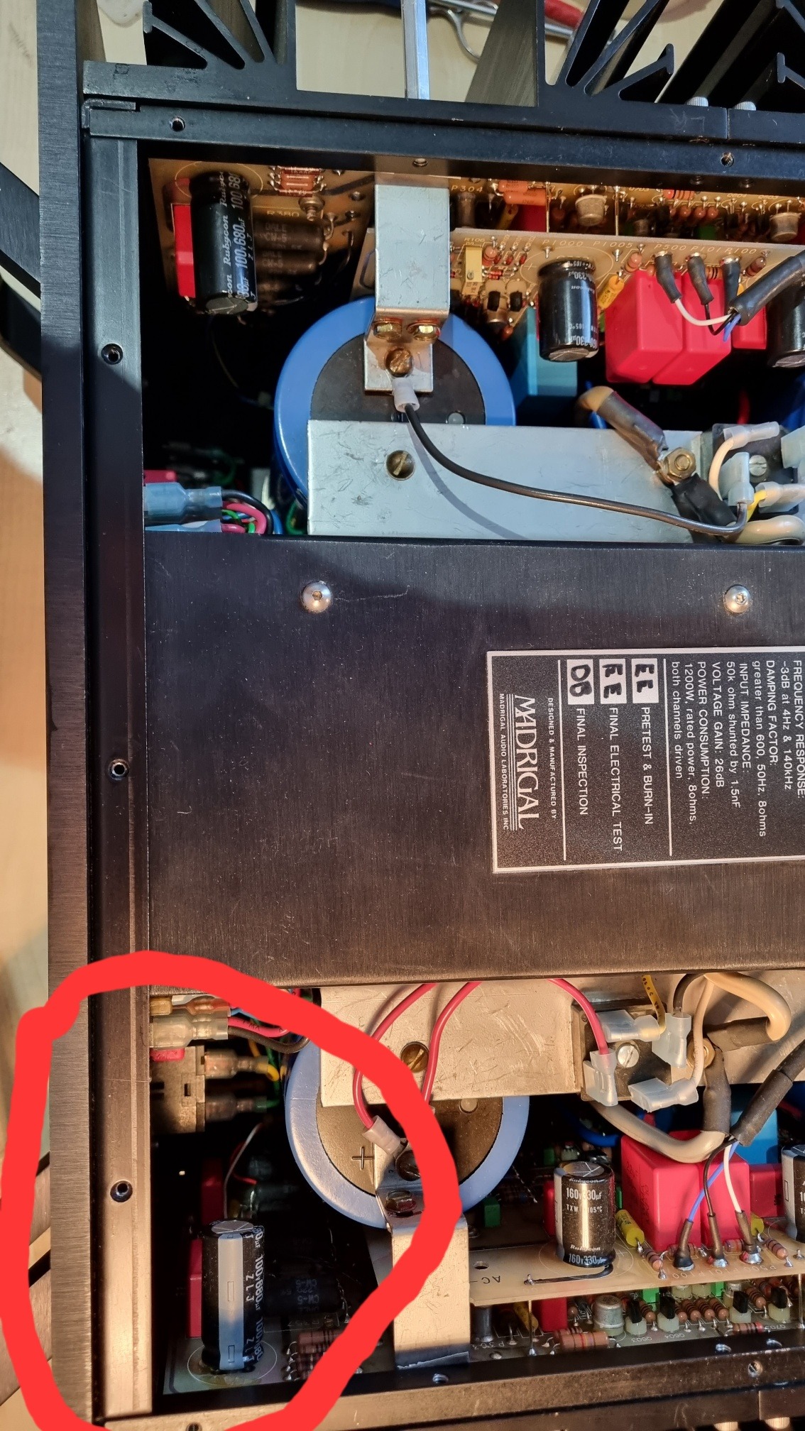

PLEASE HELP! Mark Levinson ML 23.5
Real **** happened to me!
I serviced my Mark Levinson ML 23.5 1.5 years ago and now I wanted to check the quiescent current! UNFORTUNATELY an accident happened while measuring!
I somehow caused a short circuit between the power resistor and the small yellow 10nF capacitor with the measuring tip of the multimeter! (see photo)
It completely destroyed the base of the yellow capacitor and my measuring tip. According to the measurement, the capacitor is OK. And an 8A fuse was also broken!
After cleaning the circuit board again, replacing the base of the capacitor and replacing the fuse, I tried turning the power amplifier on again for the first time!
The switch starts to light up and I thought you got lucky. UNFORTUNATELY IT STARTS TO SMOKE IN THE FRONT AREA!
Of course I immediately switched it off again.
PLEASE HELP!!!
Thanks so much!

Having just recapped and repaired a 23, I can give you a few pointers. The smoke you are seeing from the front is probably the three 10 Ohm soft start resistors beginning to overheat because the relay is not activating to short them out. This is indicative of a short circuit which is loading down the low voltage primary. I would suggest checking your output transistors for shorts.
Reactions: IRS Rößler Sound

Sorry, you will have to go through the hassle - I know how you feel. This is likely your problem. To confirm, try disconnecting the AC wires at the diode bridge of VCC and power up with a dim bulb setup. If the bulb is dim you will know the problem is on the output stage.
While you disassemble the amp make good images in bright light of every step, every screw and every wire you disconect.
It seems to be a quite conventional construction, the pre stages may work without the power transistors connected. This gives you the option to try and repair the amp without blowing the power transistors with every failed test.

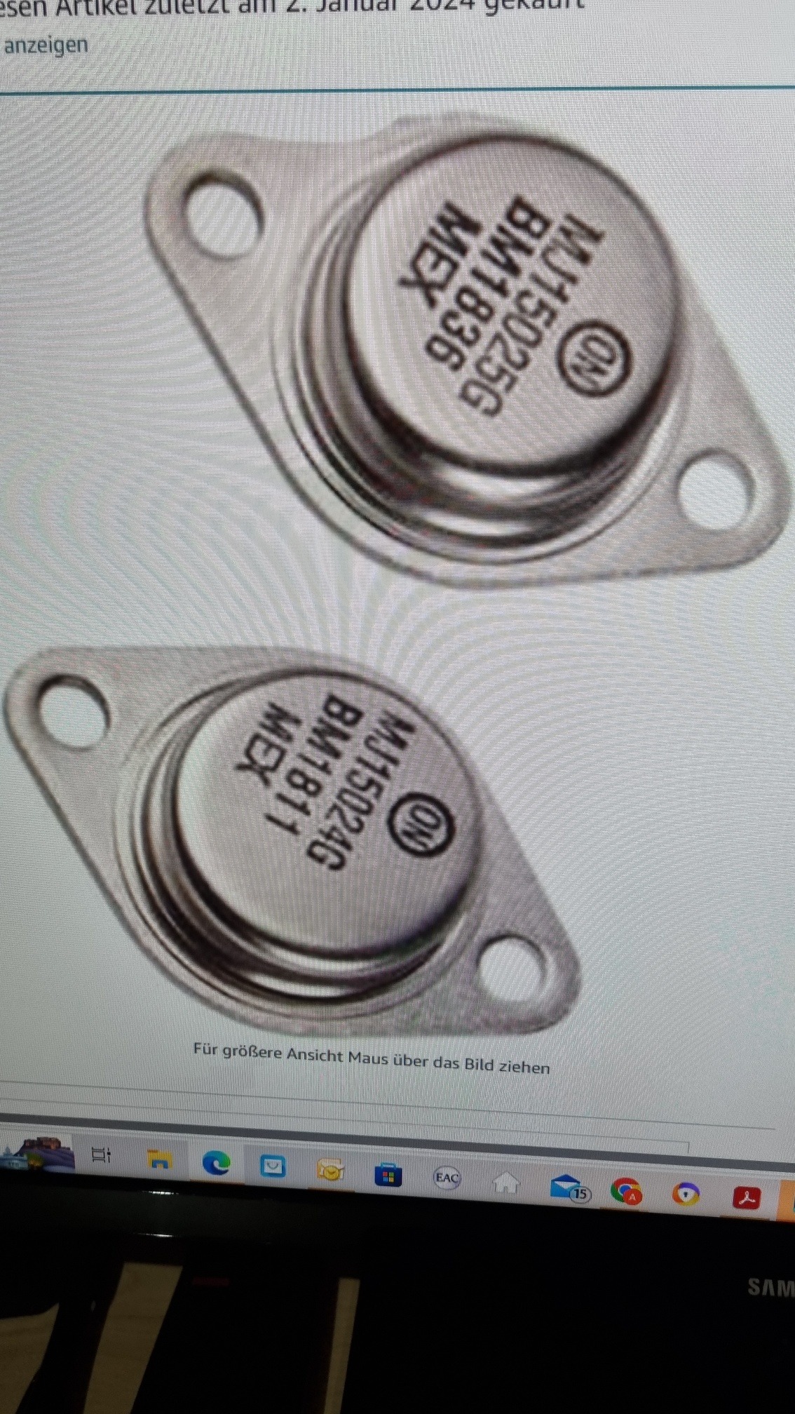

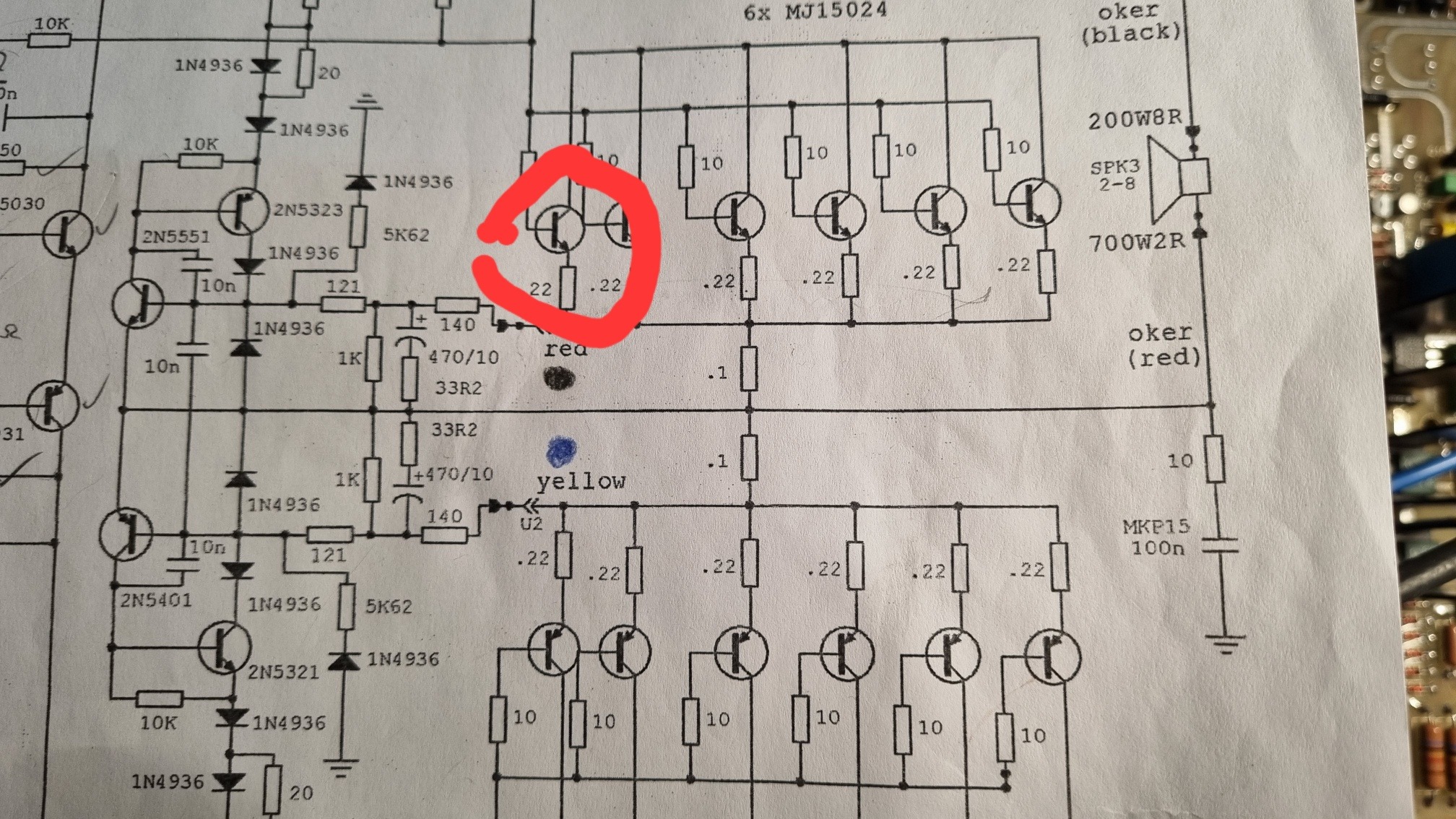

The first of the 6 pieces MJ15024 transistors from the positive wave is defective! The others look good! Of course I'm swapping the MJ15025 from the negative side too! Unfortunately they are no longer Motorola. But I don't think it will matter if they are swapped in pairs?

I recently wanted to repair an amp with these transistors if I remember right, the replacement part measured quite different. I will have a look tomorrow, I may have a few real Motorolas left.
You need only one?
PS transistor amps are no cars. You don't need to change power transistors like tires, in pairs. They are OK or gone.
You should remove the whole lot and measure them, this will tell you how "matched" these are.
The .22 Ohm emitter and 10 Ohm base resistors "match" the transistors.
Sorry, I don't have the same parts as yours, they are from the same family. Would have charged you P&P for one. The ones I got for a replacement measured quite different, so I did not repair the amp, as it was not worth the trouble.

You should be able to turn the amp on with a 75W dim bulb. Check the bias. If your amp is like the 23 there should be none because Vcc is too low.
Another check you can do is to measure resistance between the + and - Vcc buss bars. It should be an open circuit. If it isn't you still have a shorted transistor.
