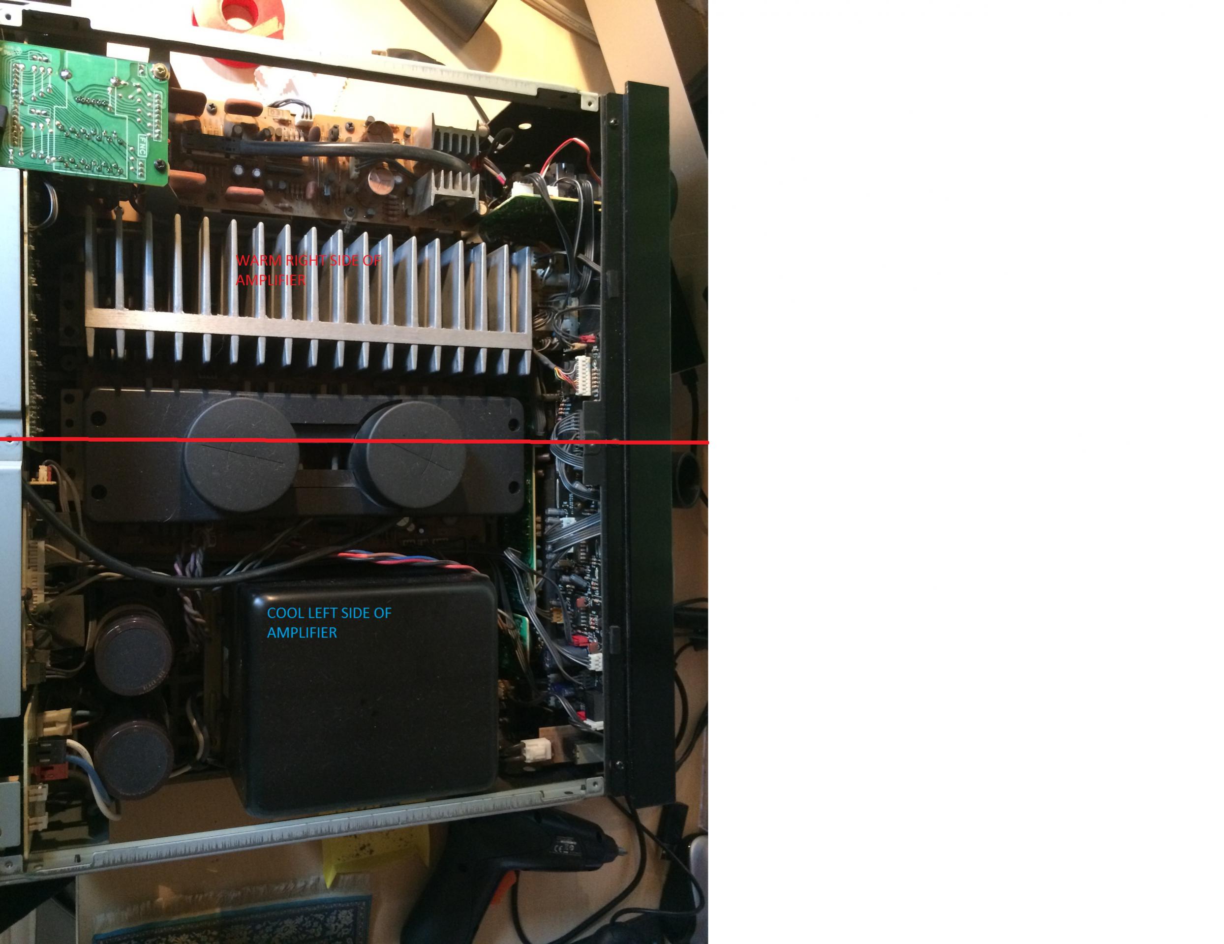

Well, this is a good lesson for all of us.. I'm very sorry this has happened to you, because I have been repairing amps for awhile now, and I believe the 707 is among
the best integrated amps around.. It runs 70mv of bias across both resistors, the
808 runs 80. The TA-N90 sounds slightly better, running 180mv !
If they are not concerned, I would find another shop. - The amp is too nice, I would move on to a shop that cares. - You could even ask a few shops if they
have a lot of the output mosfets in stock, to get a better match..
For example, a TA-F808ES just sold on flea bay for 1075 dollars!

Voltage is not as meaningful as current there.
what it sounds like is they did replace parts however
The bias has to be set and obviously one side is warm and the other side is not that means the output transistors are biased to0 cold and not dissipating heat as they should. Maybe the bias pot is dirty or has a bad spot in it which I have seen on many solid state amps that are up in years.Now,I have also seen generic replacements not work correctly but it sure sounds like the bias current wasn't for the new transistors that were installed,or maybe they moved the bias pot and forget to set it back to spec after cleaning it..I will look at a schematic on this unit.

I found the service manual but it's yoo big to upload here but
The bias in each channel needs to set to 30mv. ..Here is the thing.He told you he replaced transistors and three resistors but you need to find out if he replaced the MOSFET outputs and if he did,it is imperative that he used the .22 ohm resistors in the drain whether it's the driver or the outputs.I have seen times where shops put anything .47ohms or less in there and you can't do that because the protection circuit monitors that and in your case if there is ANY DC voltage on the base of Q402,it' going to turn on and limit power.
Lets assume he did he put the right values in.He would still have to set the bias for the parameters of the new transistors just like when we change output tubes. RT402 and RT452 are the bias adjustments for each channel and it's measured at TP1 and TP2 respectively.
I would be more than happy to talk to this man and I will email him the service manual or anyone that wants a copy free of course..I don't think there is a major problem with your unit.I just think he did what I have seen being done a number of times on McIntosh where people put the wrong value emitter resistors in when changing outputs and that causes the power guard to limit power until the problem is corrected.
