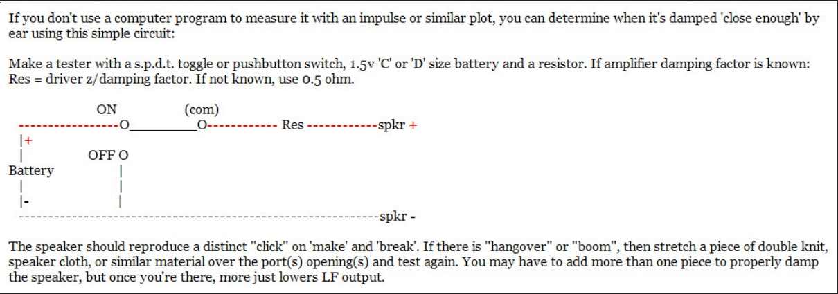

A 4th order Butterworth may have some unwanted boom. You could play around with simulated values while looking at the group delay, trying to keep the slope negative without peaks.
I know. I'm going to fiddle with simulation and then with tuning and stuffing. Tuning it a little "dry" seems to be the best for this application.

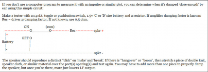

For customs I only ever used 1st order and acoustic solutions to acoustic problems, limiting electronics to zoebel, parallel LCR CD horn EQ. If starting with an Altec or similar speaker, then just tweaked the typically stock 2nd order XO with a zoebel, by-pass cap around the horn level pot.
Hmm, FWIW, etc., IME a BP4/'boombox' is best 'tamed' by 'critically' damping it.

Your old school tip about "click" vs "boom" is so old I had forgotten about it. I first built speakers with information from Howard Sams "Guide to Sound Reinforcement" (which I still have today) and that tip is in there. This was before Theile and Small published their stuff and you do everything with a VOM and handful of 1 watt resistors.
So thanks.
