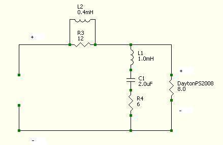

Crossover attempt with no measurements, THIS IS A GUESS:
- looks like Fred smoothed the Dayton and low passed to his woofer around 150 hz
(we don't know what the slopes are for your drivers)
Dayton PS220-8 with Eminence Alpha 15A H-Frame Open Back -
Techtalk Speaker Building, Audio, Video Discussion Forum
AudioRoundTable.com: Speaker >> Dayton Audio/Eminence Full Range Single Driver
from
http://www.quarter-wave.com/OBs/OB_Design_Part_1.pdf
Martin King used a 9.1 mH and 68 ufd low pass for Eminence Alpha 15A, 8 OHM driver about 200 hz crossover
Interesting check this table
2nd Order / 12 db Butterworth Crossover Table
Looks close to what Martin King has for a low pass. (9.1mH and 75 ufd)
Your Cerwin Vega says 6 ohm, for 130 hz 6 ohm @ 11 mH and 150 ufd low pass
(or whatever point you want to try)
(disregard that the following is a 4 ohm crossover, this has a 11mh coil and 350 ufd cap)
you could hook this up and listen. Good? Bad?- Change the cap 150, 100, 200, etc-electrolytic cap-watch how you hook it up.
Parts Express 80 Hz Low Pass 4 Ohm Crossover

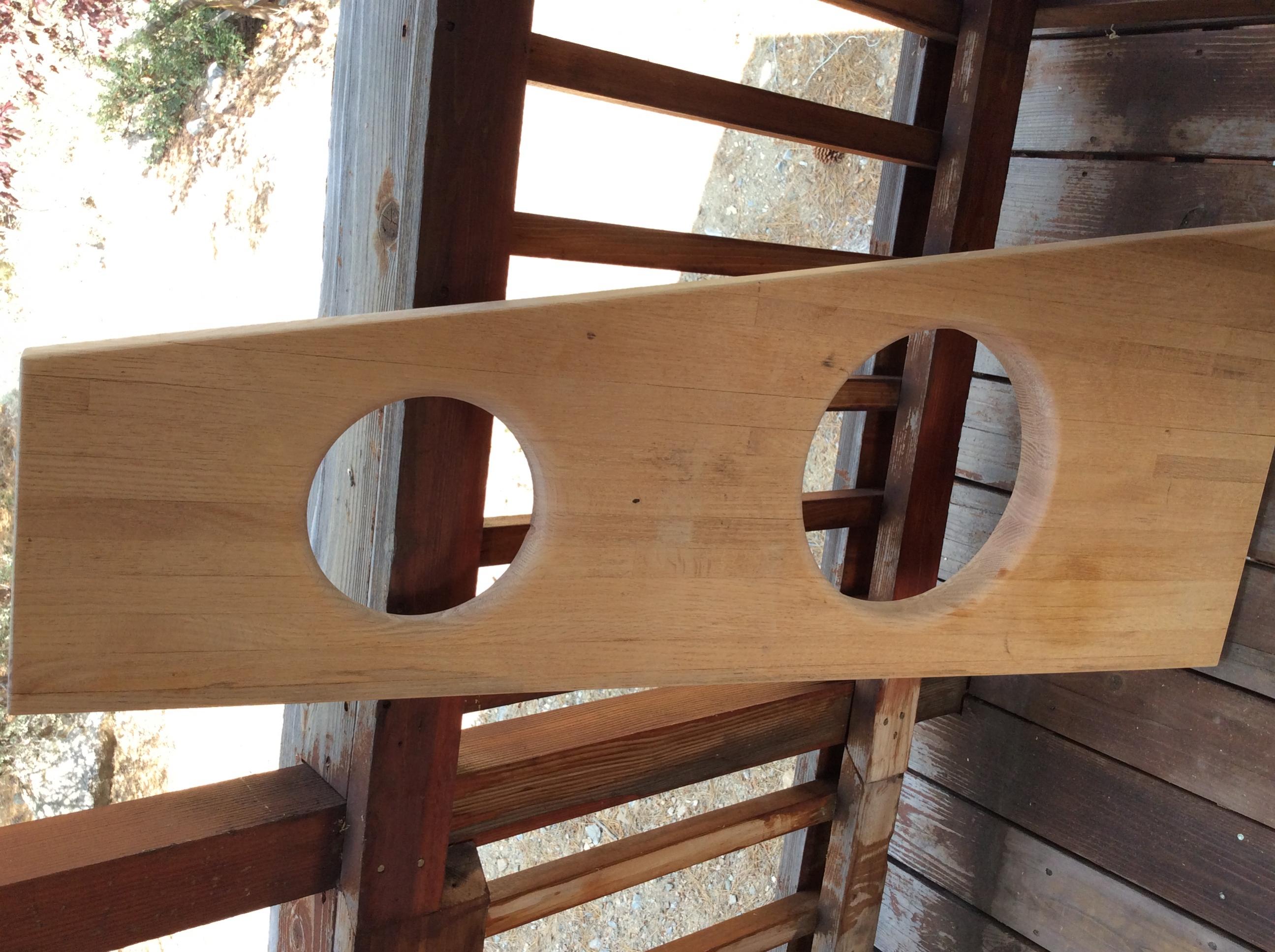

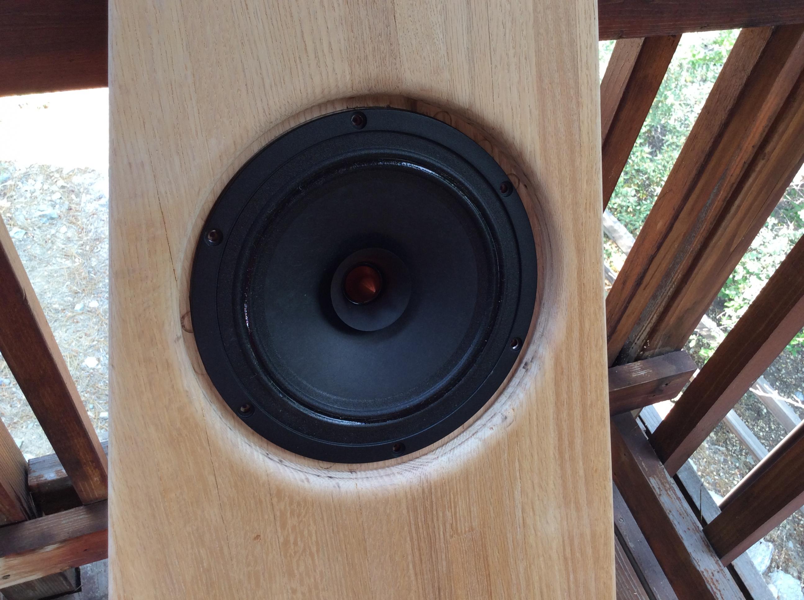

I put these together as I originally intended, just to test ‘em. I’m using the Cerwin-Vega crossover on the woofers only as my low-pass filter. The full-range drivers are unfiltered. I’m running these in parallel and my big ol’ Krell is having no trouble at all. These really sound quite good and bass isn’t bad at all. They don’t have big subwoofer bass, but it’s certainly there!
In a few days I’ll pull the drivers back out and sand, stain and finish these. I’ll fiddle with low-pass more, later on.
Not sure why but my attachments are displayed sideways here..
