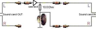

I am completely new to this, want to measure TS params to calculate box volume. I have downloaded Audiotester but their connection diagram is confusing to me(attached with this post).
Here they have not shown any mic which picks up sound from speaker, then how will it measure ? And my laptop only has headphone out and mic in, can I use mic in as audio in? and what sort of AMP should I use in this test?

This setup looks the same as speakerworkshop. The diagram shown will measure the impedance and the software will calculate t/s params from this...you dont need any mic's.
Any amp will do for this test, but to get good results you need to be able to setup your s/card levels, laptop in built usally dont work.
Its best to use a reisitor for the DUT say 22R, once you can measure it properly with flat phase from say 5hz up, your setup is ready.

Thanks for the replay 🙂 but watz DUT ? Can you pls explain this a bit more: "Its best to use a reisitor for the DUT say 22R, once you can measure it properly with flat phase from say 5hz up, your setup is ready."
DUT=the speaker you are testing, Device Under Test.
Instead of try to test you speaker straight away, if use use a known value resistor in its place, when you test it should show its resistance and phase, its resistance should be at the same value for all frequencies and it phase should be at 0 for all frequencies. When you can do this, and you can then test a speaker, and you known the results are accurate.
Use 0.1% resistors if you can, for your setup and for a test resistor.
