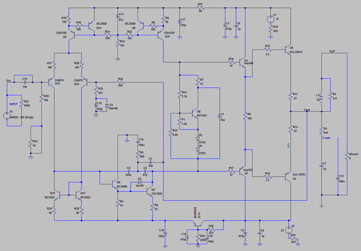

I'm looking for knowledgable people who would help me design (or rather design together) an improved 50W/8 Ohm amp based on D. Self's Blameless design. I'm not much into electronics, so I will need a lot of help and patience, I think.
I just read Self's "Audio Power Amplifier Design Handbook" 5th edition. From this I understood that his amp design is only "Blameless" until the quiescent condition of the output satge does not drift due to heating of the output transistors. But this quiescent state cannot be maintained well.
I attach Self's original circuit of his from page 209 of his book.
My "design" if I may say so is only incorporation of some ideas of Dado's ultra low distortion ThermalTrak + TMC amp to the Blameless amp.
My goal would be that with your help we could design a DIY amp that
-- Would give inaudible distortion at normal listening levels even if quiscent conditions in the output stage change with temperature and the amp becomes somewhat overbiased. By inaudible distortion I mean no distortion products higher than -100 dB even at 20kHz.
-- Would be stable and repeatable (no dependence on component tolerances).
-- Would be as simple as possible to facilitate DIYer build and fault finding (simpler than dado's design).
-- Use mostly readily and easily available components.
The changes I made so far to the Blameless design:
-- separate CCS for input LTP and VAS with increased current
-- OITPC compensation of the VAS according to Dado' design (although I increased most of the capacitors to have a lower loop gain f1 frequency. Dado's circuit with OITPC can be found here.)

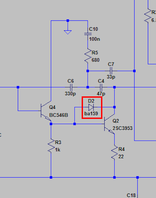

-- A diode between VAS C-B for faster recovery from clipping
-- Voltage regulation on the negative supply, and RC filtering on the positive one
-- ThermalTrak output devices (although the present design of the Vbe multiplier is probably not optimal). This probably just decreases the possibility of thermal runaway and does not reduce distortion significantly, becase even slight overbias causes significatly higher distortion, and keeping very stable quiescent condition is not easy even with TT transistors.
Dado's design is very impressive and I'm not clever enough even to grasp most of the details, but IMHO for what reason should we have all distortion products below -140dB, if the highest SPL we listen to music probably never exceeds 100dB, and we hear nothing below 0dB SPL? So I think his design can be simplified without audible deterioration of sound quality. In Self's book its postulated that the input LTP with degeneration and current mirror and the VAS with buffer has low enough distortion levels to be inaudible with usual negative feedback factors. The main source of distortion is the class B output stage, which is worst if underbiased. A plan to bias the OPS into an slightly over than optimal bias, so crossover distortion should never occur. The takeover distortion (class AB) might come up to some degree, though the OITPC should minimize THD up to 20kHz. I think it's important for the distortion to be low even at 20kHz, because of difference distortion. (E.g. if you have a 19kHz and 20kHz signal, in a nonlinear system it will produce distortion at 20-19kHz= 1kHz.)
I've made an LTspice file (see attached), but I could not run the simulation so far, because I first will have to learn how to use LTspice.
Any comments or help is welcome, and you can modify and re-post the asc file, if you know what you're doing.
The only thing I ask is not to increase the complexity of the circuit significantly. Though an overload protection or loudspeaker protection may be necessary.

--> Uses 2SC3953 and complement, does not seem easily available (presumably EOL?)-- Use mostly readily and easily available components.
--> Uses 2SA970, known EOL
Ahem.
Some (bootstrapped) cascoding my be in order there if you really want to keep the "jellybean factor" high.
Compensation over the output tends not to appreciate capacitive loading very much, should be checked in sim.-- OITPC compensation of the VAS according to Dado' design (although I increased most of the capacitors to have a lower loop gain f1 frequency. Dado's circuit with OITPC can be found here.)
Why have you gone for 0.22 ohm emitter resistors rather than the 0.1s Self suggests?
Implementing some protection circuitry should be considered indeed, even if outputs seem generously sized (some commercial manufacturers use a single pair of 8 A transistors on over +/-50 V).
For maximum repeatability, a finished board layout would have to be provided eventually.

Hi sgrossklass,
Thanks for your comments. I have corrected what you proposed:
Changed 2SC3953 to KSC3503, and 2SA1538 to KSA1381.
Changed 2SA970 to BC556B.
Changed output emitter resistors to 0.1R.
Before I'd go further in improvements, I need to think if they are worth the increased complexity. I need some time to discover what kind of and what level of distortions are audible at all. It may well be that Self's original design is just good enough without any improvement.
If anybody wants to experiment with this in LTspice, here is the asc file.

There are two mods I would do.
a.) add an RF filter to the input. 1k0 in series with the 10uF and a 680pF in parallel to the 10k.
b.) adjust the NFB dc blocking cap to avoid the added distortion created by using a too small capacitor. Self shows this specifically in Editions 2 and 6, I can't believe he omitted it from ed 5. >425uF and preferably >=680uF, maybe even using a 1mF
I would also look at adding degeneration to the VAS (you have added R4=22r) and a collector current limiting resistor to the EF driver at the VAS, maybe 1k0.
This will reduce open loop gain so you may have to use LTspice to work out how much to increase the Input LTP and VAS currents to restore the OLG.
I would definitely increase the Input LTP mirror degeneration. At least 300mVdrop across these resistors and even getting to over 600mV does no harm. So 150r with 2mA as a minimum, or 200r with 3mA is possible.
R31 is shown incorrectly and as a result the input wiring ends up wrong. Look at Bonsai's new amp wiring document, or read about HBRR+HBRL by D.Joffe.

Hi AndrewT,
Thanks for suggestions! I made them except:
@jaycee
Thankx changed the VAS diode to BAV21.

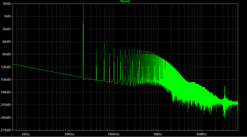

There were 2 errors in the previous schematic, the SIN source was not grounded, and the quiescent current was very high (about 4 Amps)[/B] Here I upload the new asc file.
Is it to limit slew rateof input? I didn't add this because I read in Self's book that high input resistance adds significant "input current distortion" because of nonlinear input currents in the LTP. So this amp must be sourced from low impedance preferably < 200 Ohm. I've halved the feedback resistors (R23, R34) too, in light of this.a.) add an RF filter to the input. 1k0 in series with the 10uF and a 680pF in parallel to the 10k.
Somewhere I read that it's not good to put a larger resistance here, but I forgot the reason. Self says in his book that this R4 resistor is not really a degeneration resistor because the VAS is a transimpedance stage. Now I don't understand what he means (like I said I'm not really into electronics, but it would be nice if we could construct something nice together...)I would also look at adding degeneration to the VAS (you have added R4=22r) and a collector current limiting resistor to the EF driver at the VAS, maybe 1k0.
@jaycee
balancing the source and feedback divider Z at the ltp +/- inputs gives some common mode nonlinearity cancelation - so if you intend to drive from a buffered source rather than a Volume Pot you can take this path
bootstrapped cascode of the ltp Q is more complicated but greatly reduces the input common mode distortion sensitivity to input Z
sharing the ltp ccs and VAS ccs ref turned out to be a poor idea for slew symmetry - later Self reversed them, added a positive feedback C to get symmetric slewing
Cherry gave an analysis of a single Q "VAS with degeneration" which suggested it was a wash gain/distortion wise but could give a high frequency phase margin improvment
Nobody wants to say anything positive (or negative) about R7 - C33 in the bias spreader? Nobody speculates that R16 is hooked up incorrectly: it wants to connect to R7 bottom instead of R7 top?
Tnanks Mark, I wired it incorrectly. But I realized that if it's correctly wired (R16 connect to bottom of R7), then the THD performance at 20kHz (50W/ 8Ohm) is a lot impared. The lowest high order harmonics are when R7 is left out completely. See attached plots.
So what if I omit R7? I'm aware that it is there for better bias spreader stability, but most DIYers don't have a distortion meter to set the quiescent voltage optimally anyway, so why bother with this resistor?
Thanks for the other suggestions, but I don't want this design to be perfect in regard to distortion, only keep it as simple as possible for DIYers. My goal was only that the circuit should not have any distortion component at 20kHz higher than -100 dB, at power levels from 1W through 50W / 8 Ohm.
I will also upload the newest asc file with quiescent current 55 mA.
