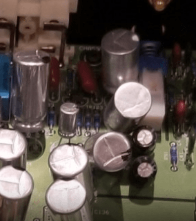

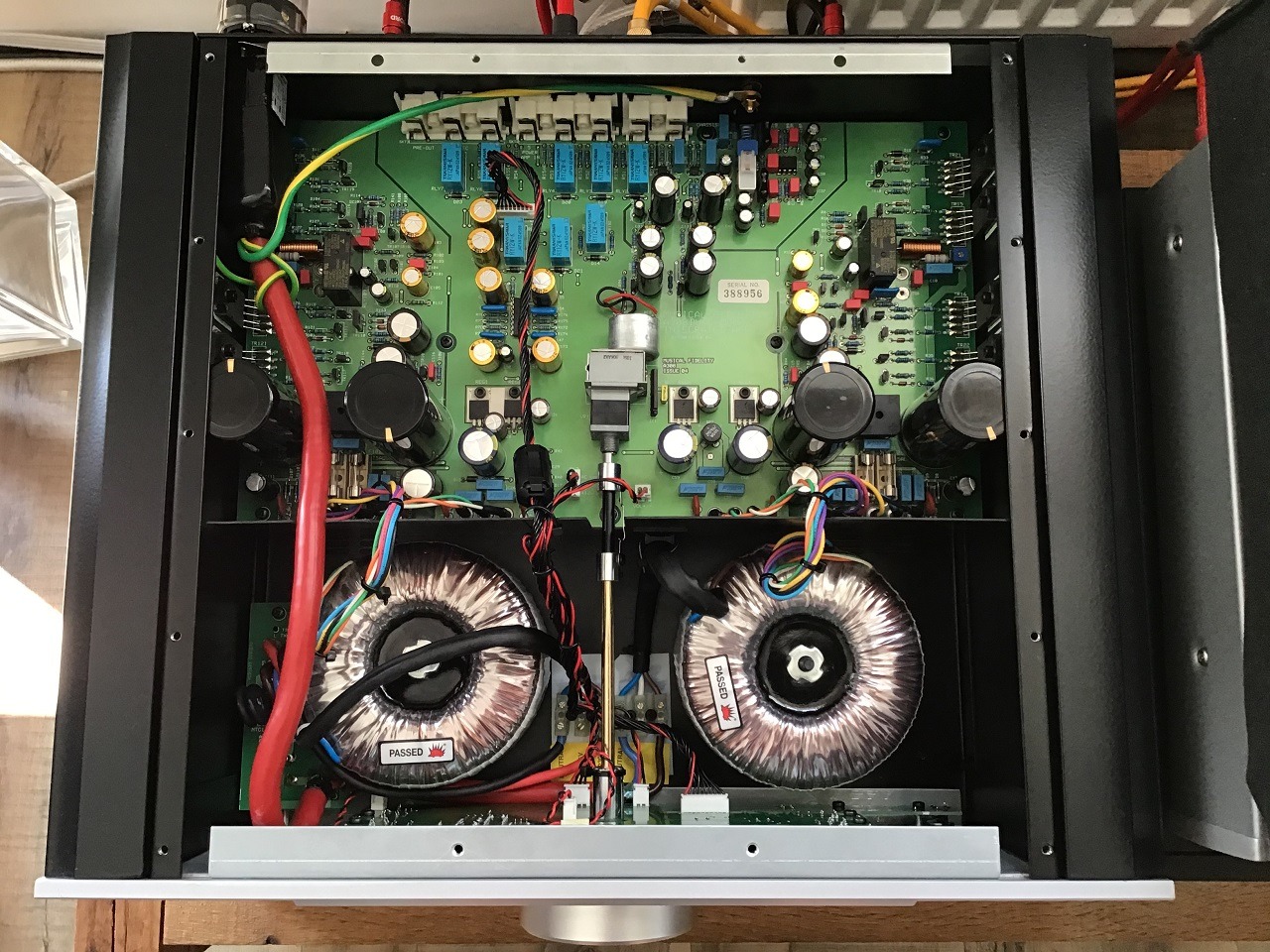

The top marking looks like Panasonic caps on the PCB that have been changed - though most don't seem to be seated evenly on the PCB, with most standing off the PCB surface.
Also Panasonic have used a M in a box symbol on most of their caps but now they seem to have changed that.
They use multiple caps to increase current capability and lower the combined ESR. In my MF A220 rebuild the original Jamicon main caps had a high current capability on the data sheet of about 5.2A but no derating so when I looked through the replacement caps data sheets I took a CDE with a 6.4A on the data sheet designed for 50/60Hz. I also used organic caps on the preamp power supply with 4000mA 10mOhm ESR in parallel to provide 8000mA however those have a serious 0.1 derating for low frequency but with ~20mA that's not a problem (it also powers the phono stage in the A220).
The stages are similar to the A220 - there's closer ±rail caps that have been changed in the board however the dumb bit is putting those massive caps in the preamp stage. It's unlikely to be using the charge capacity and for ESR it could be outclassed by modern caps. Did they replace the preamp opamp?
The two banks per side are one for +ve and one for -ve rails.
Now given those caps are sat on the toroid - I wonder how much amp is coupling the flux to the output stage.

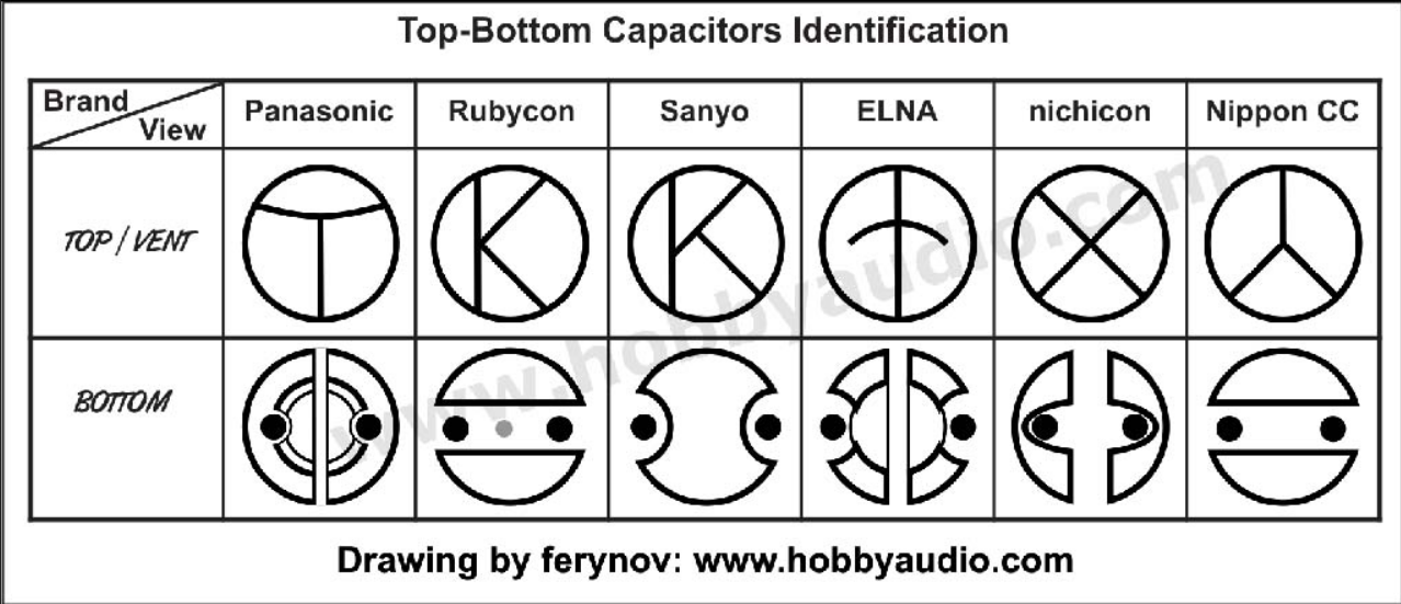

as far as i can see, the smaller ones on the main pcb look like panasonics as well based on the very useful top/bottom markings chart you showed

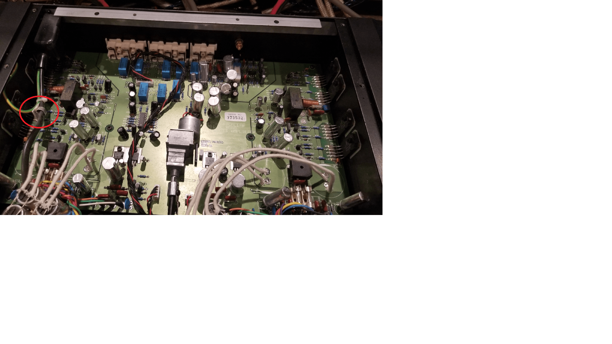

One thing to be aware of is that the aluminium strain relief clip for the mains cable is lying very close to the left power output stage. It should definitely be removed.
It should be (safely) attached to the top of C102 as shown in the second image.

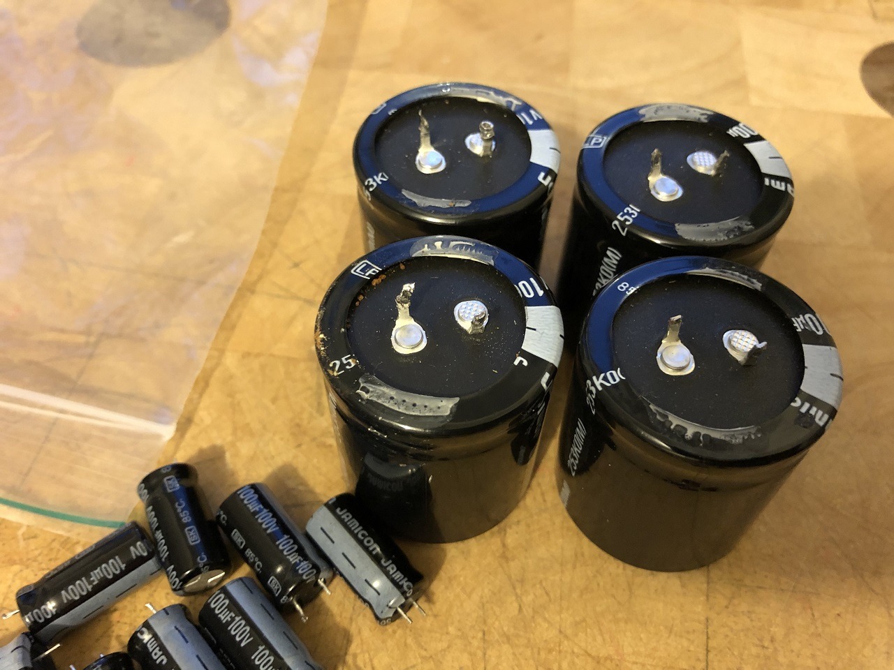

The four main PSU reservoir capacitors (one each for +60v -60v, left and right channels) were originally Jamicon LP 10000uF 63v. That is what has been replaced by the banks of seven Panasonics.
It is very common for them to degrade, as they operate extremely closely to the rated voltage (no derating) - third image shows those removed from my amp.
As NickKUK alluded to, I'd have added some screening between the new banks and the toroidal transformers.
If you need any original values/ratings or recommendations on improvements just ask, I've extensively modified my A308 and it sounds incredible for what it is.
