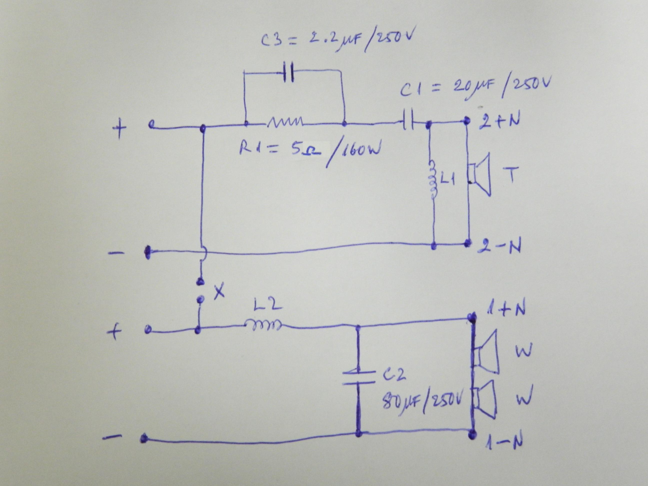

Im building a pair of 2way speakers for my garden and Im planning to use TXD-252 crossover that I bought online second-hand.
In the manual its is written:
  • Passive: 12dB/octave high-pass and low-pass at 1kHz
  • Active: 24dB/octave Linkwitz-Riley @ 1kHz
Please have a look at the pictures and help me identify how should I connect to get the "24dB/octave Linkwitz-Riley @ 1kHz". And what is this connection "X?" on the board?
Thanks :worship:

Thanks Azrael for your reply! I think you understood correctly.
Lets focus on the passive crossover.
Looking at the pictures.
If 1-N & 1+N are for subwoofer and 2-N & 2+N are for tweeter horn, what is the purpose of C1, R1 and C3? And the "X? that breaks the electrical curcuit"
2-N & 2+N locate on another sode of inductance L1, it doesnt quite look like a curcuit to me..
X connects the input of the tweeter crossover to the input of the woofer crossover. This way the incoming signal will supply both of them.
C1 is the standard high pass filter component. C3 and R1 provide an upward tilt to the higher frequencies.
Thanks for thinking along and for the drawing!

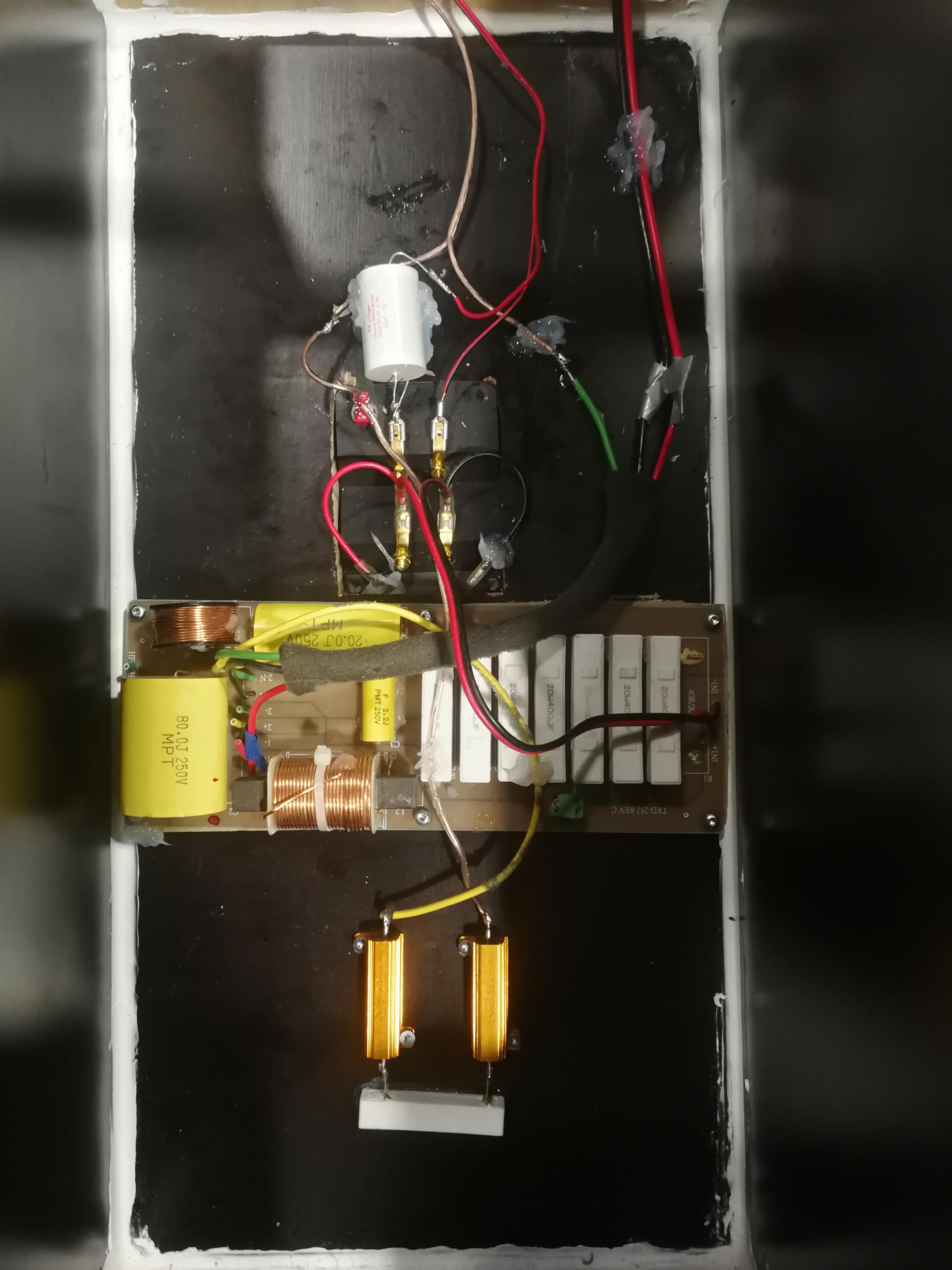

Hello again.
By now Ive built the cabinets and attached the dribers and made some tests with biwiring and crossovers outside of the box.
What Ive done now is Ive put this crossover inside the box and added 70ohms of resistance in series with the tweeter in order to reduce its loudness compared the woofer. Woofer cabinet is closed.
I have two questions:
1. What happens to the sound if I solder off one of the 40ohm resistors and the total resistance will be 5.7 ohms instead of 5?
2. How sould I make the biampwiring? I have 4 pin terminal. Should I add a switch that disconnects the bridge X and connect another set of wires from the second pair of terminals with the tweeter?
