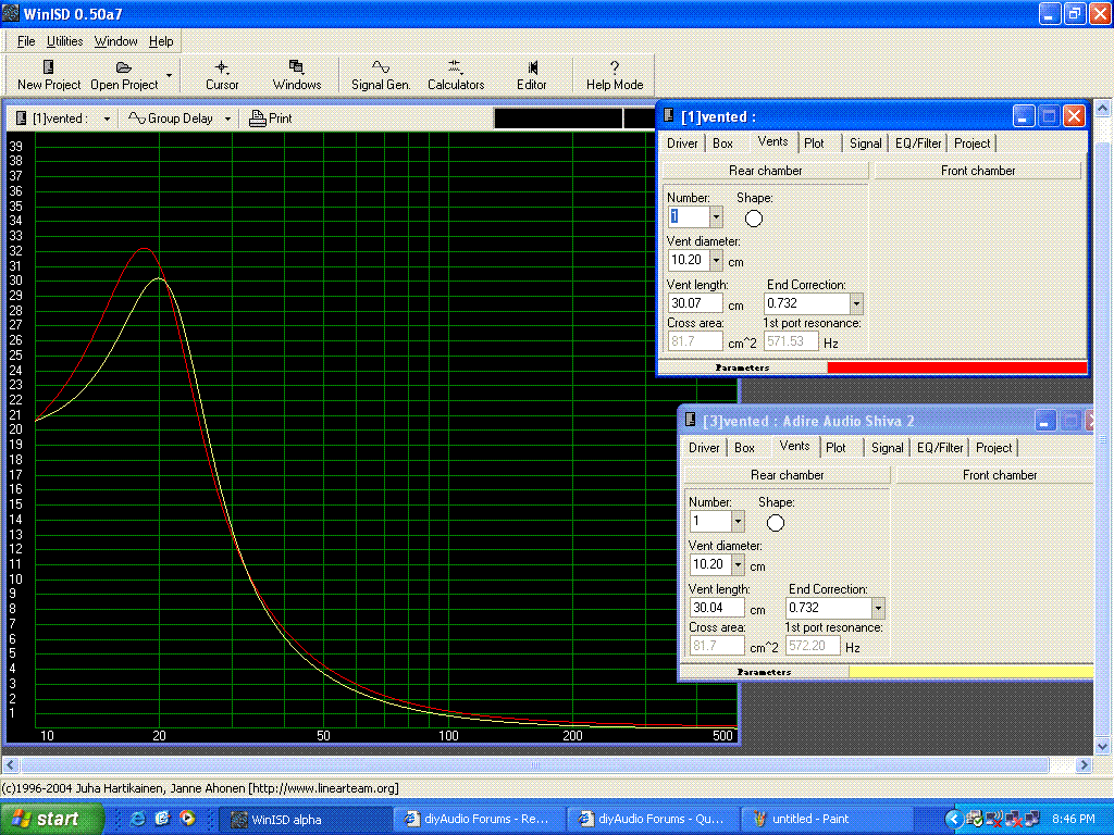

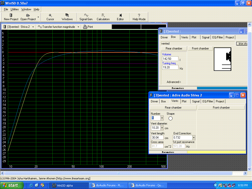

I've been running some simulations on WinISD. I wasn't so sure about the Atlas 12 at first, as Shiva was showing better response curves in the EBS box. However, the mid-Qts option (short the gold terminals with 1.5ohm resistor) is producing some nice results.

It looks like a 39cm long, 10.20cm diameter tube gives a better response with the Atlas 12. 45cm looks even better (lower group delay) but might introduce port turbulance. You will have to adjust the length for the flared ends.

To simon5 (or others): You seem pretty familar with WinISD, is there a feature that warns of audible vent noise?

Thanks, Terry. The Atlas 12 falls within Dan's downfiring sag calculation (1.988mm), so I guess it will work fine. Really interesting technique with the clay for deadening box resonances.

so you guys think that the 12" Atlas will work good with the 1.5 ohm 5w resistor in that enclosure? because i wanna make it final as i will start the project in couple weeks.
