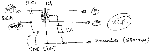

Hi george a,
This might work. I am new to SPDIF, but to me it makes sense. I suppose you should do a conversion "as soon as possible" - close to the RCA connector, and feed the signal as balanced most of the run.
This might be wrong, Jocko, your opinion please...

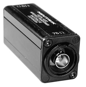

This is an elegant solution to what you need - Neutrik AES/EBU Digital audio transformer.
Here is the link:
http://dv411.com/neutaestran.html
Price goes from $ 30 to $50.
It does good job and it is very small. You could order it in various connector combinations, and you will need BNC to RCA adapter.
I have to say it is funny that this single transformer - adapter goes up to $ 50 and you could get Behringer SRC 2496 unit for $ 130. Behringer could serve you as a digital preamp, bit rate converter, digital distribution box...

Ergo:
Try the resistor on the primary side. There is an alternate source for those transformers now..........Digi-key sells them.
E-B:
No! In any case, I would use coax, instead of 110 ohm for the cable. The less XLR anything in the path the better.
Since the unit uses a Crystal RX, any of the many circuits floating around could be used. No reason to try to stick to high AES/EBU output level. So, treat it as a typical SPDIF stage.
The trick is to find a good one.
Jocko
