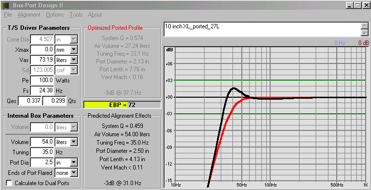

Tuning a vented box is very easy. Cut off a piece of PVC tube of dia 2.5 inches and 4.1 inches long, cut a hole in the front baffle or back of the box and insert this tube into a 54Litres box and your bass response will look roughly like what is shown in the black graph.
If you prefer to use a smaller box, the red graph is optimal response. With a box of 27Litres internally, use a tube of 2 inch in dia and roughly 7.8 inches long and you will be tuning the box to 33Hz and the character of your bass output will look roughly like the red line.

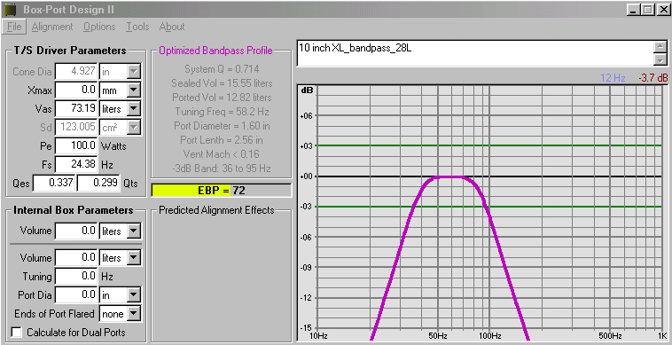

For sub-woofers, bandpass designs are very popular. This simulation shows your response XL is also well suited for bandpass. With a -3dB at 36Hz and 95Hz and a box of only 28Litres, makes a very appealing sub-woofer.
