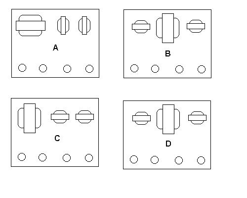

Could someone help me pick out the best layout for my EL84M PP amp, i.e. how to orient the power TX and OPT's? The circles at the front (bottom) of the rectangle are the tubes.

I build mine (6L6G PP) like D.
The only difference is that my OPTs are orizontal.
Looks very nice.And no any transformer interference.
Place the power transformer EXACTLY at the middle of the OPTs.
Like D (or B) you can build the two channels almost identical.
