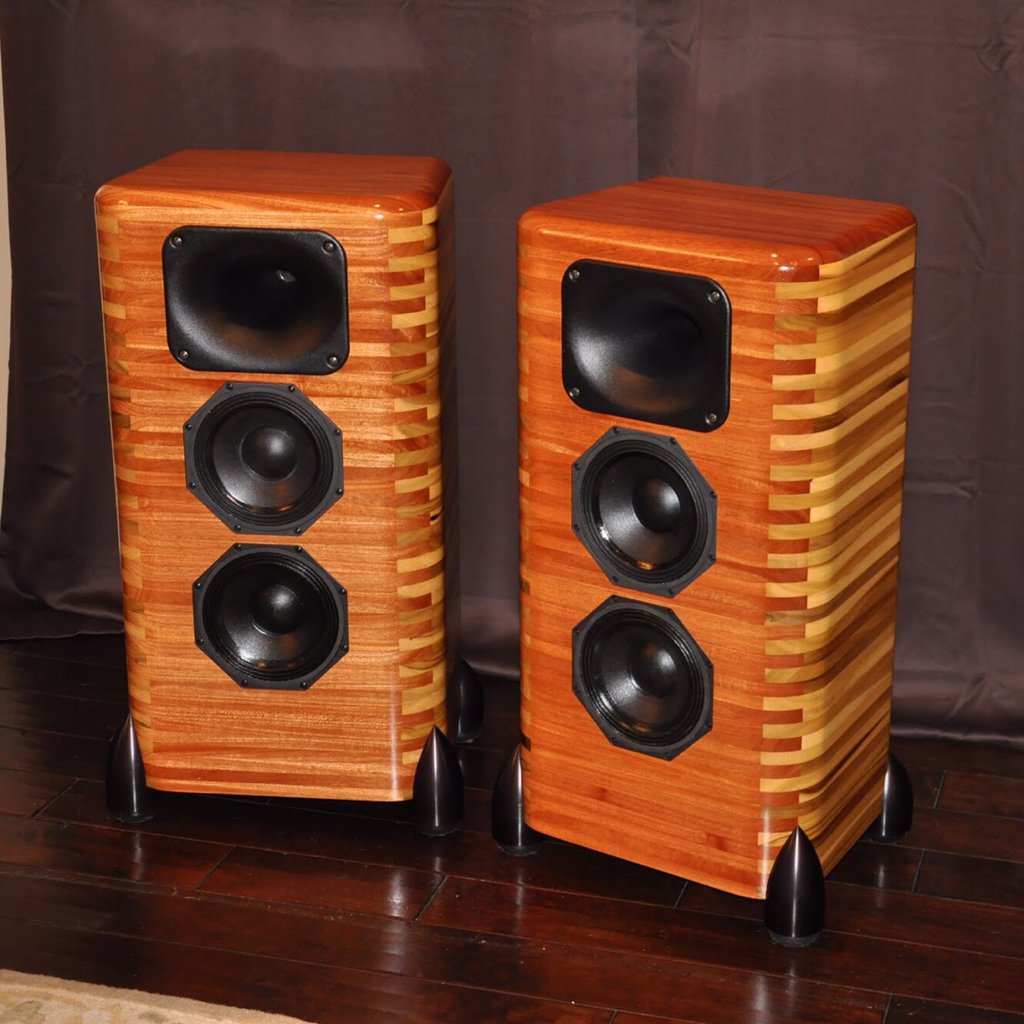

RESPECT: Javad Shadzi has been very clever at routing and stacking hardwood boards into a beautiful, high performance translam cabinet. You will enjoy his threadS and construction techniques. Javad's driver selection cost more than your $200-$250 budget.
Strafi Translam FaitalPro Tower Build
From my experience, a 12" woofer + 1"CD EconoWave constructed from plywood is a great speaker for your workshop goals. Route baffle for waveguide, woofer, plus edge roundovers. If you desire BEAUTY, you could use Javad's translam construction for this EconoWave.

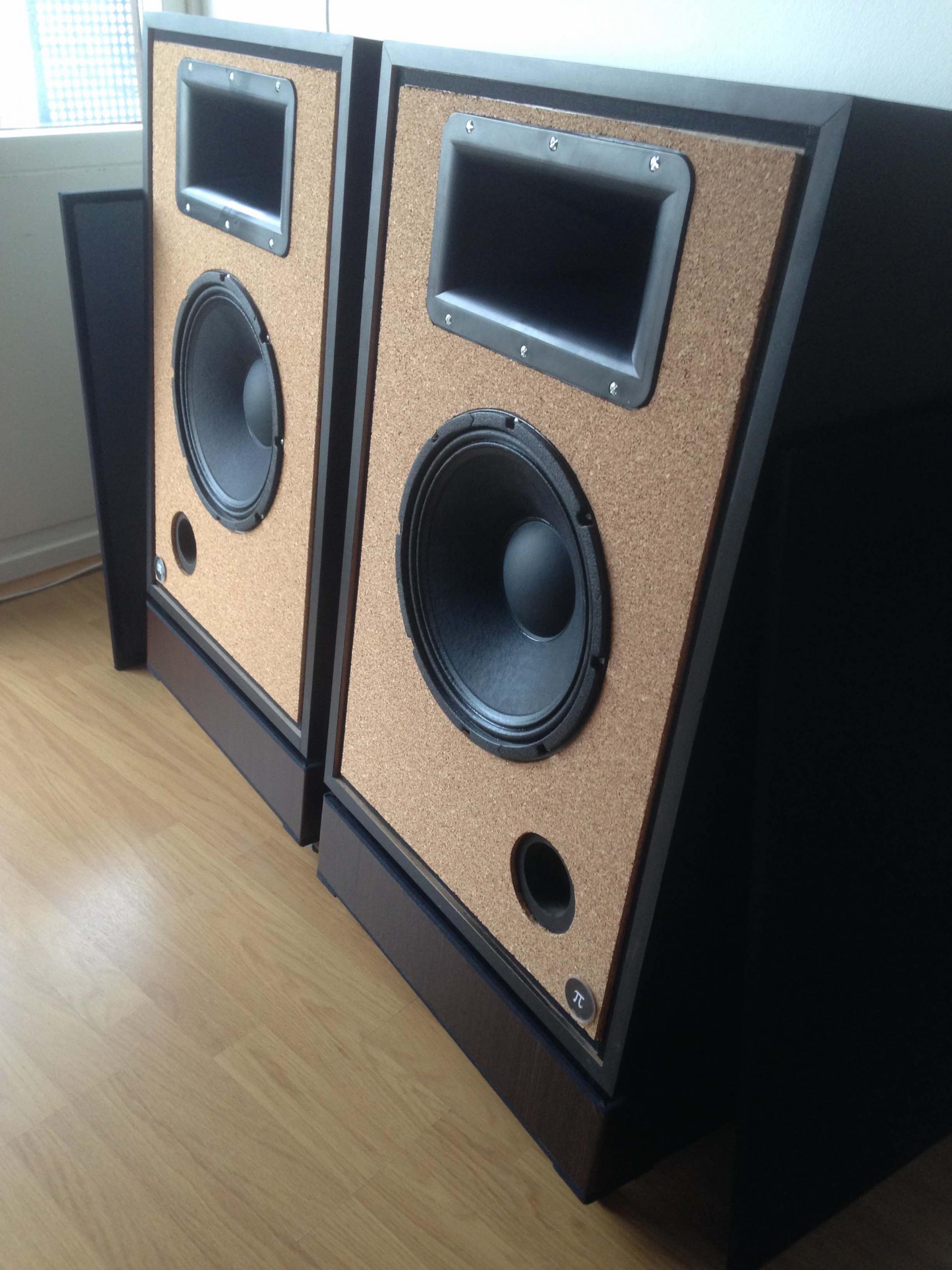

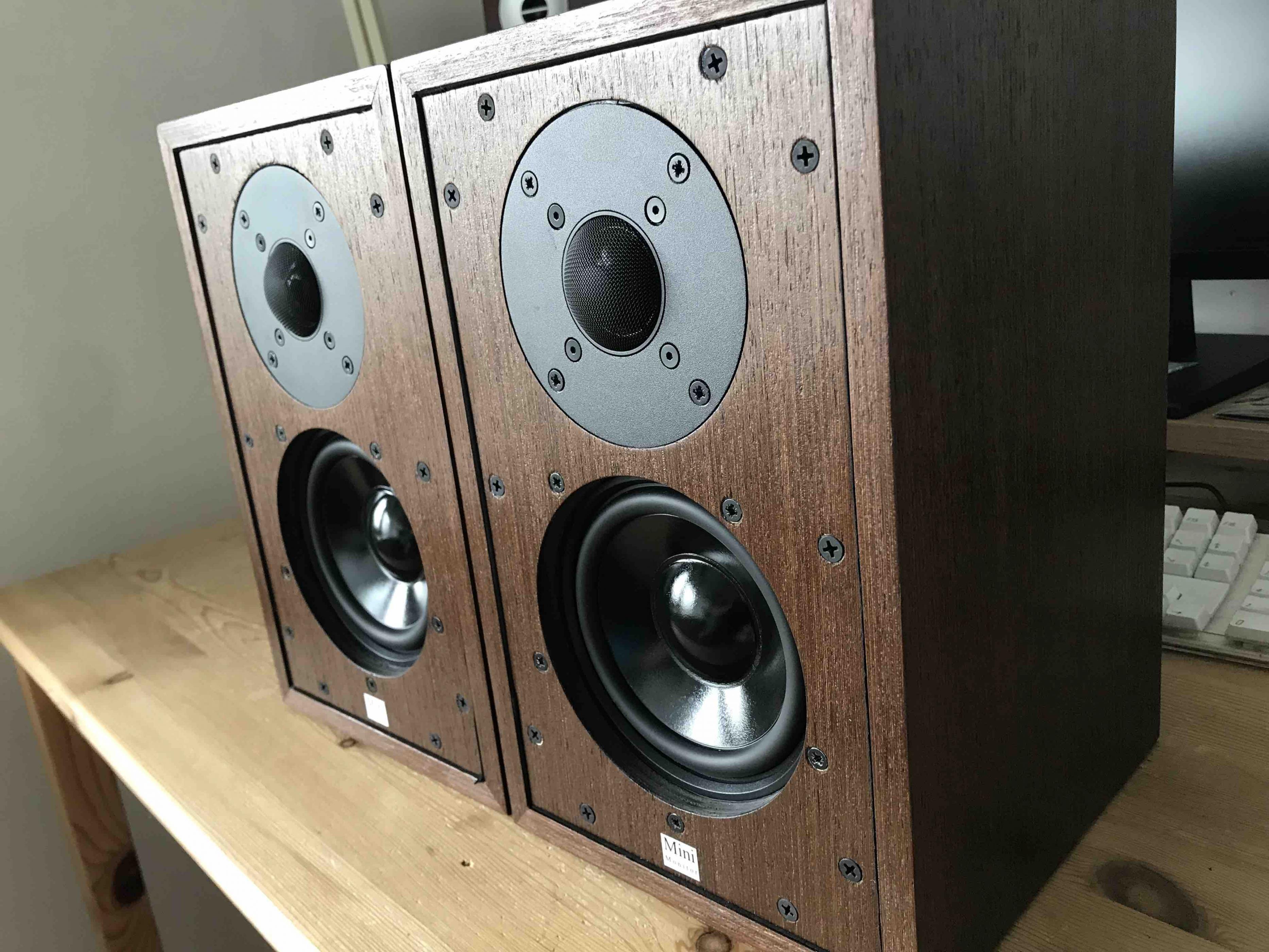

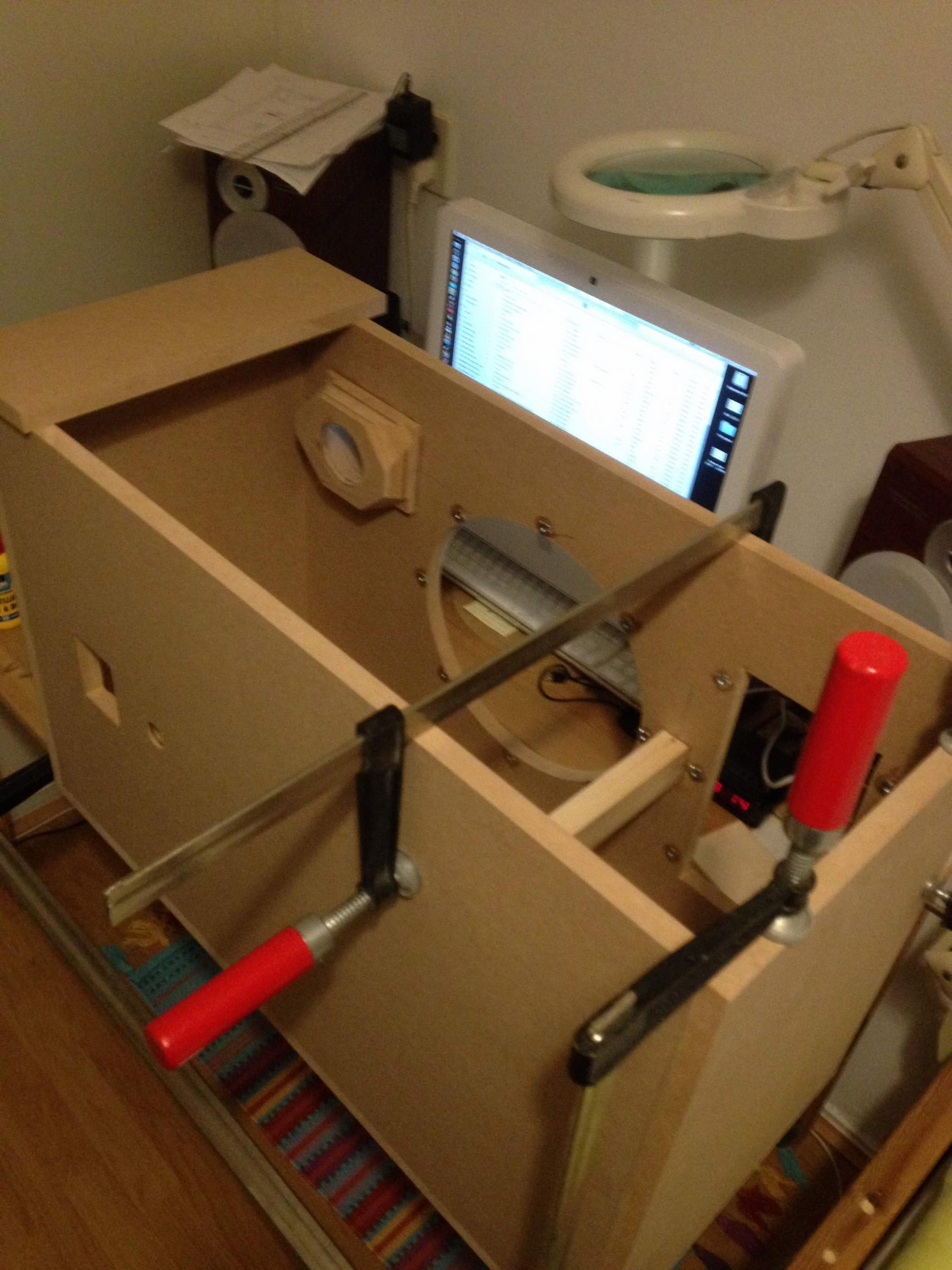

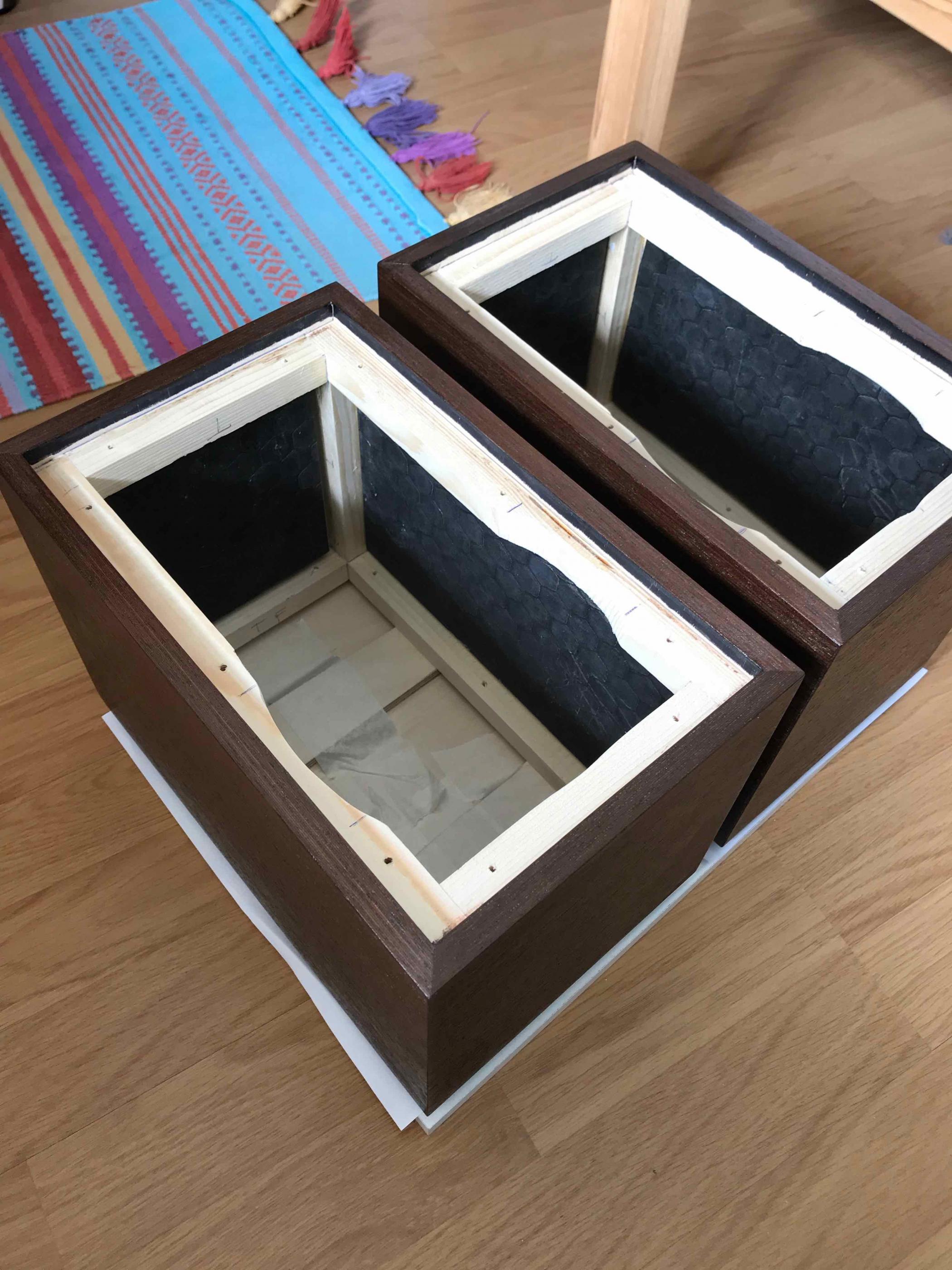

I don't know if you already decided to build some speakers, just want to show 2 examples of big two-way speakers with MDF material and bracing and also a more recent build with thin wall speakers with bitumen lining on the walls.
I can tell you that I spent at least 2 x as much time on the small one than on the big Pi 3 speakers... but since you are wood worker I don't think it would be a problem.
Since I don't have a wood shop, they are assembled right on my desk...🙂
