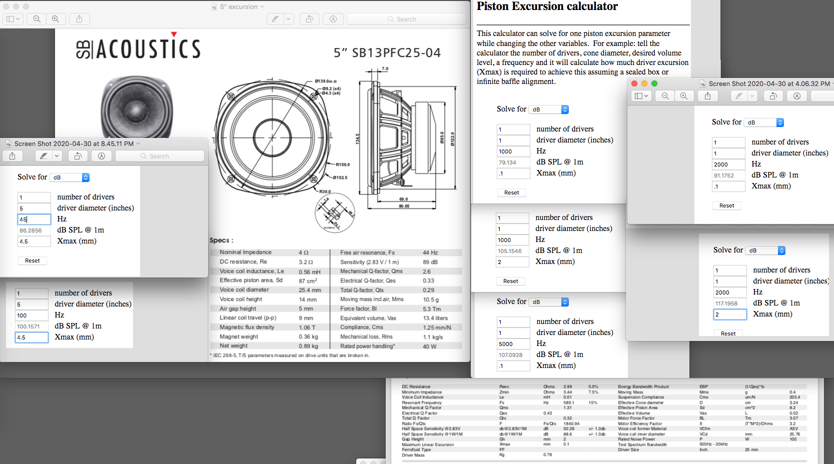

Ran the numbers for your lil' five incher...
Internal box volume, (Vb) Ten liters
Tuned frequency for enclosure (fb) 57 hertz
Low end cutoff @ 3Db down,(F3), 53.55 Hertz @ -3.03 Db.
Port inner diameter, 47 mm, by 123 mm long
Running this driver sealed up will make for poor performance on the bottom end....besides, the simulator calculates for EBP, Efficiency Bandwidth Product & makes the selection for either sealed or ported....and your driver choice is firmly in the ported camp.

Funny, at 100 Hz, the woofer's excursion could outrun the tweeter's at 2kHz by about 8dB. Note the woofer's linear excursion is 9mm peak to peak, 4.5mm Xmax, one way linear excursion.
At 45Hz, the woofer would run out of gas at 86 dB at one meter, the tweeter 91 dB. I can comfortably play my acoustic guitar and sing at that level.
This is an interesting tweeter- runs out of linear excursion (Xmax) at just under 1 watt, but won't burn up till 100 watts (500Hz-20kHz).
Good first project- the tweeter should sound terrible well before it lets out the magic smoke ;^).
tank you man how did you calculate theese figures? i would like to try for myself.
sorry most of this has gone over my head could you maybe explain in layman's terms.
