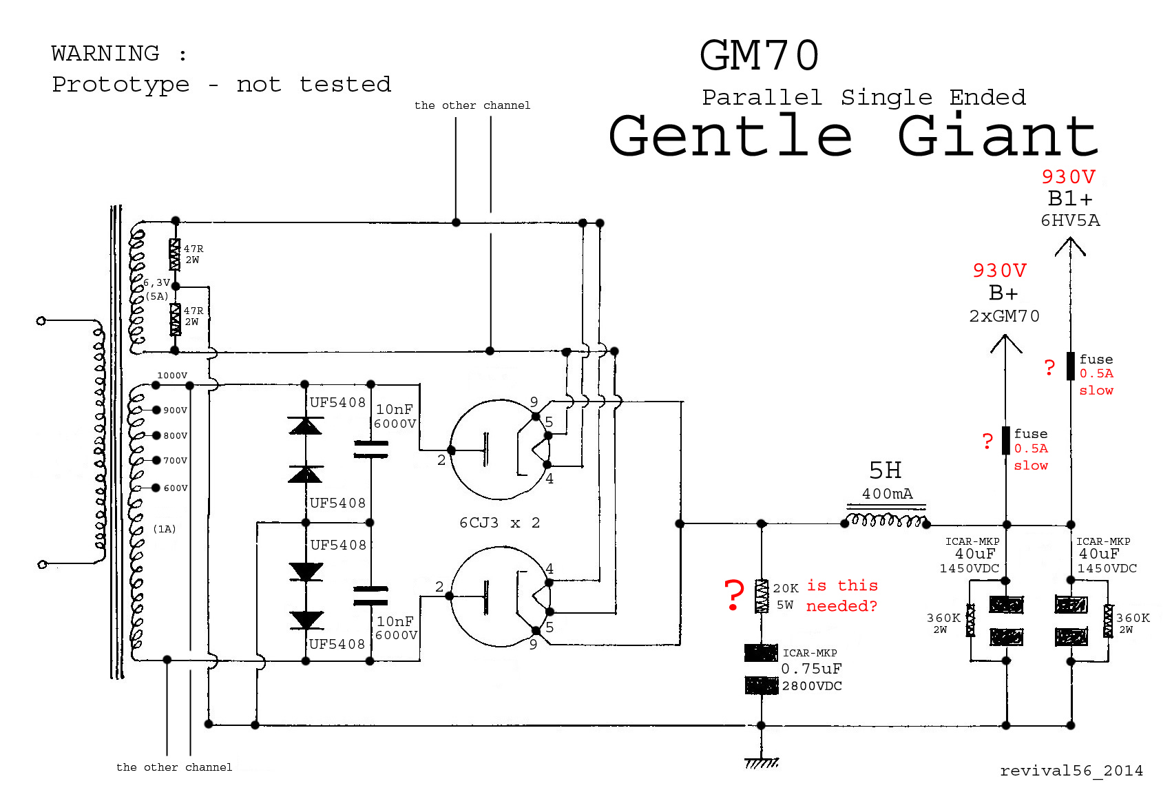

I also have available a transformer with 0-600-700-800-900-1000V (1A).
My idea is to build a SEP that GM70 with work possibly under 1000V.

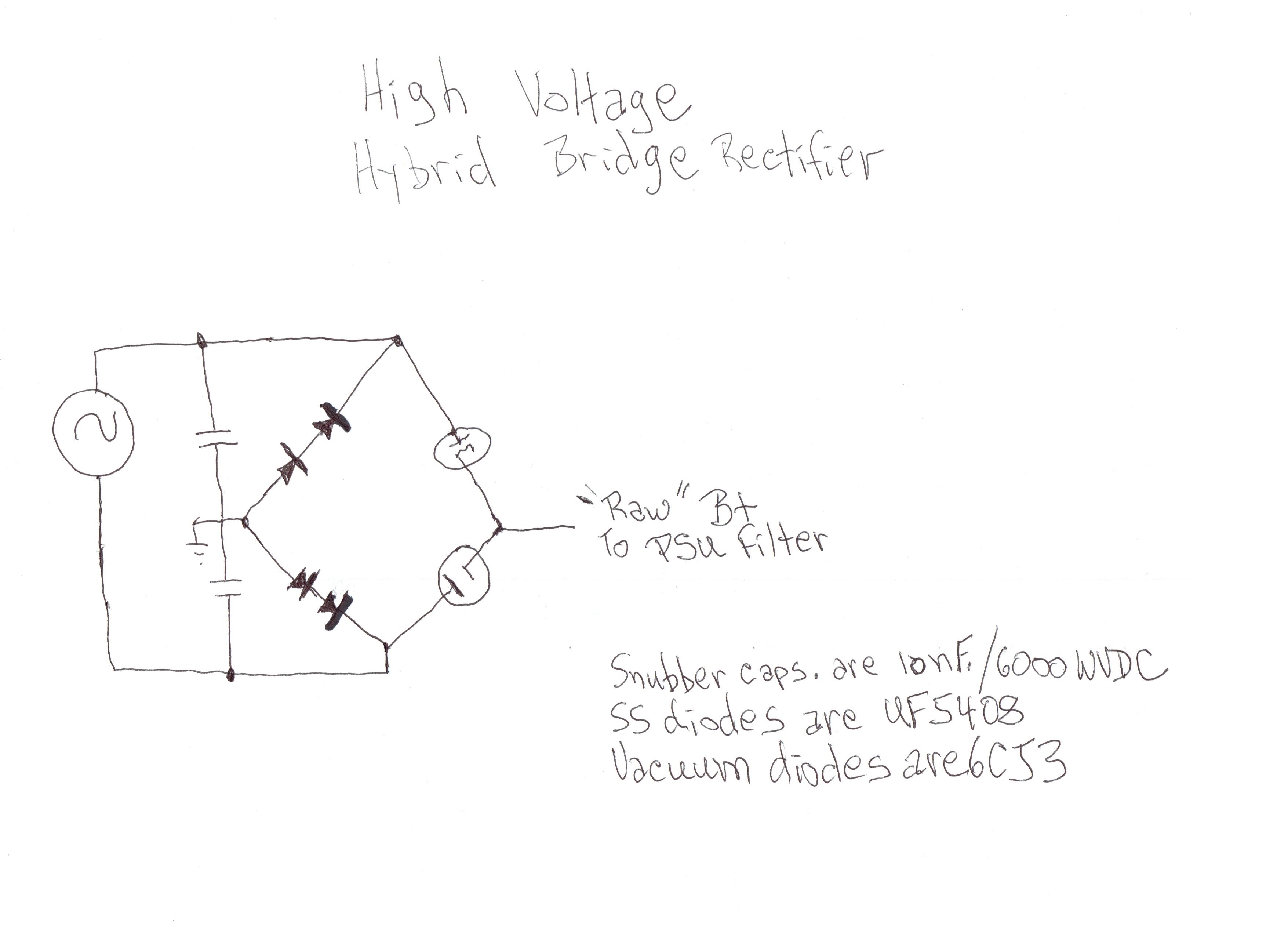

Thomas already gave you the answer to use this piece of "iron". Employ a hybrid 4 diode bridge. Two sets of series wired UF5408s form the bridge's ground legs. A pair of 6CJ3s form the "hot" legs.
On the transformers is also spelled "INTERMITTENT DUTY" (?) Do not know what it means, electronically speaking.

I am a neophyte: I need a schematic drawn.
I can not follow you completely due to lack of expertise in electronics and for the language.

Hi Eli,
you made me a great gift!
This solution allows me to get with the alternating voltage of 1000V? Or should I use the lower intake to 600V?
Thank you so much for the scheme.

Two more questions:
- On the side of the silicon diodes going to ground you need a switch to start the high voltage after one minute preheating valve 6Cj3?
- After the valves 6Cj3 the first capacitor value should it have? Okay a small capacitor (1uF) or is it better to abound (20uF or more)?

Hi!
No
This depends on the filter chain you have in mind (LC, LCLC or other) and the ripple figure you are shooting for. Keep the cap value as small as possible. Best to simulate the PSU with PSUD and check that peak currents are within limits.
Since you wrote that you are a neophyte: Please be careful. Your questions show that you have little experience with such PSUs. Such voltages are dangerous and special care is needed. Make sure all parts used have proper voltage ratings. Especially also the heater transformer for the 6CJ3. In case of doubt consult somebody to help and review your work before you power it up

Today I found in the cellar 2 huge capacitor ICAR SP25 4000Vlcc. Perhaps even only one of these could be used as the first capacitor after the tubes 6JC3.
Another doubt. The scheme suggested by Eli how much current it can handle? 700 mA???
My idea is to build a final single ended parallel GM70. As a driver I have a couple of EC8020 jealously guarded for years for something important.
A final of this type (four tubes GM70 + Two EC8020) you eat 500-600mA easily (at least) ... 😕

You should work out the details first before designing the PSU. Calculate the total current needed including all stages and bleeder resistors. Then design the PSU accordingly with some overhead. And then select the right parts. 700mA would be pushing it for both the 6CJ3 and power transformer.
Please do yourself a favour and use the EC8020 for something they are better suited for. I love the EC8020, but not as a driver for such large tubes. They would not have a lot of headroom. I know it is fashionable to use such tubes and be able to stick with two stages. But simpler is not always better.
Use the EC8020s to build a top notch phono stage and don't waste them as drivers in a power amp.

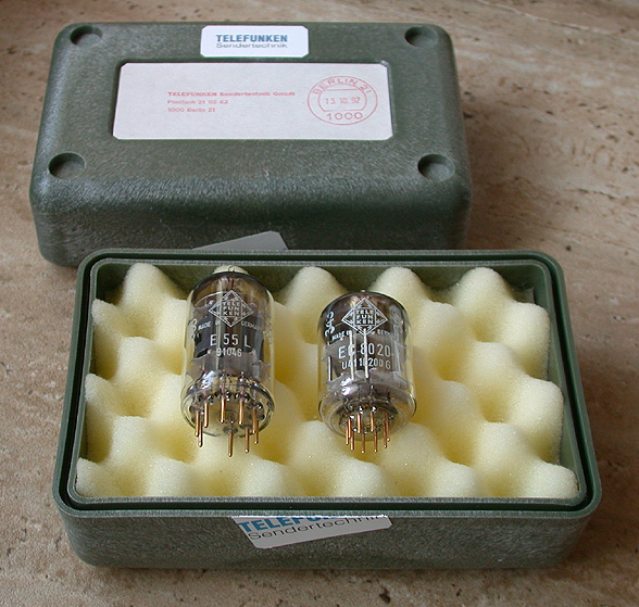

I enclose a rare photo showing EC8020 and E55L together in a pack demo reserved for companies sent by Telefunken. This picture shows that the two tubes are born together, and for similar applications. The EC8020 (very rare because it is produced in small numbers) was born only in Telefunken factory. While the E55L (easier to find still around) I think I was born just in Mullard factory, even if they are then rebranded by many brands.
