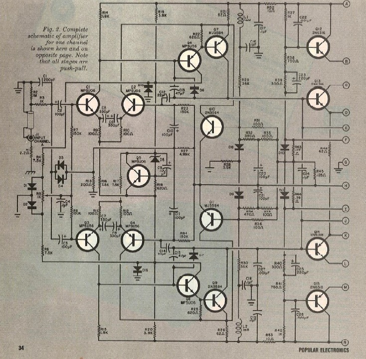

I think the first commercial version of what you cite was Jim Bongiorno's Ampzilla.
Here's a link to the 1974 article:
https://www.updatemydynaco.com/HistoricDocuments/ampzilla_web.pdf
The picture here is the Ampzilla front end from that article.
I built an amp based on this one out of an old AudioAmeture article. It is a beast with about 200 watts into 8 ohms. Great design!

The two diff amps are usually referred to as a complementary balanced input or a complementary diff input.
The advantages they offer are symmetrical slewing, high symmetrical drive from the VAS (but see later remarks), cancellation of most of the 2nd Harmonic in a well balanced design, lower input bias currents and offsets, and an additional 6 dB open loop gain.
On a big power amp, the additional cost is marginal.
Re the VAS output current, it’s unlikely that it will ever go into class AB. Most designs run the VAS current at between 5 and 15 mA and if you use an EF3, even into a 2 Ohm load, the variation will be only 20-30% of the VAS standing current value.
BTW a competently designed feedback amplifier will always include an output inductor of between 0.5 and 1 uH. This is very effective in isolating capacitive loads from the amplifier.
