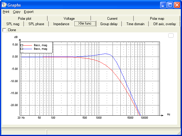

you're right ,but xo WAS in question ,not transfer function of entire xover-drivers combo;
you know that you can use simulation sheets as toilet paper if you don't have exact models of used drivers.
Oh, sorry Zen, I misunderstood. You were just calculating the corner frequency and you are of course correct.
In case anyone doesn't know what we're talking about, changing the load impedance will change the shape or Q of the rolloff but not the corner frequency of the filter. The pic shows two 2nd order lowpass crossovers feeding a resistor (not a real driver.) The only difference is the resistor is twice as big in the blue curve.
Changing driver impedance will change the corner frequency of first order networks. As the order of the networks goes up the driver has less and less effect on corner frequency.

The LT spice simulator will do a good job and even better if driver electrical parameters are included in the model. Like I said before the simulator knows nothing about acoustic properties of drivers or the box they're mounted in. In spite of this, the electronic model is accurate and will display the applied driver voltage.
If you need to go further, a number of papers exist on the internet explaining how to add mechanical models to the spice simulator, these get very complex and given sufficient understanding can end up modeling acoustic output, cone displacement etc.
