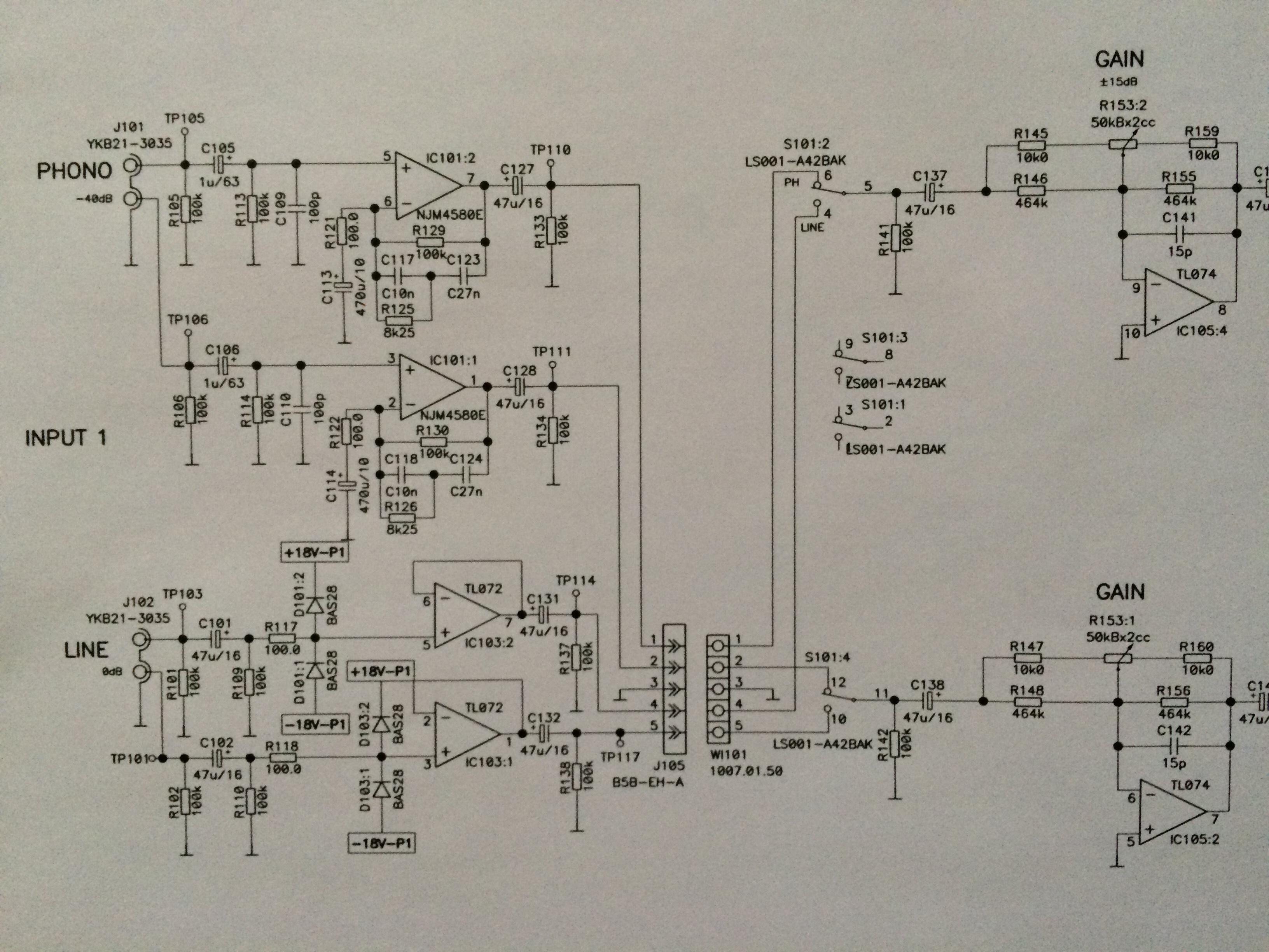

If anyone has the formulae for determining RIAA component values they may care to consider the values used in the gramophone stage. The chosen capacitor values are standard ones and wonder about the 27 nano-farad value. I think that value might err too much on the low side.
Here is the Schematic
The formulae for determining component values in the particular RIAA feedback network are:
Theoretical
R129/R125 equals 12.38
C123 uF value by R129 in ohms equals 2937 uS
C117 uF value by R125 in ohms equals 81.1 uS
Implementation (component tolerances ignored)
R129/R125 equals 12.12
C123 (.027) by R129 (100000) equals 2700 uS
C117 (.01) by R125 (8200) equals 82.5 uS

Guys, thanks for all the input. First things first, I'm am going to try swapping opamps. Couple questions:
Should I stick to surface mount opamps? If not, how do I attach a socket/adapter to the tiny surface mount connections on the board?
I will try NE5532N or the premium version NE5532AN. Only source is TI and that would mean TI's equivalent, correct?

You would do well to replace the ceramic capacitors in the feedback equalization. Polystyrene or polypropylene are suggested. Only in tube equipment does one need a 400 volt rated part. That should take the pressure off in terms of finding components that fit the footprint of your circuit board.
The 1k in series with ground is the decoupling leg of the negative feedback and the ratio of these determines the low frequency roll-off and affects the overall voltage gain. Increasing the value from 1k to 1.78k will have reduced the gain of the gramophone circuit block and extended the bass roll off to a lower level.
It may have been due to a modification during production to reduce the sensitivity of the module and allow more headroom for signals. Disco music is highly compressed and there are jockeys who have made an art out of the deliberate scratching of old gramophone discs.
The component values used in the RA88a do not reconcile with the Baxandall equations. To implement these you would need to replace all the component values in the network between the module output and the inverting input terminal. I can be more specific on this point if you are interested.
I lifted the drawing of the feedback network from the diy-audio-engineering website. Rather than reproduce the diagram here, I read it as {[2.49kohm series (3300 pf parallel 150 pf parallel 922 kohm) series (1000 pf parallel 75 kohm) ]parallel 1.78 kohm to ground.}
In my RA88a mixer, pulling the 1.5 meg resistor and the 100k resistor the builder installed and replacing them with the values above seems doable with rice grain sized tenth watt resistors. I was suspicious of the 1.5 meg anyway, resistors over 100 k tend to hiss in my PAS 2 tube preamp and I like to lower the resistance if possible, or put in metal film instead of carbon comp . (metal film over 100 k helped the PAS2 hiss a lot ). I may have to stay with the ceramic caps in the RA88a already installed, as long plastic caps would have long leads looping around that might short on something. Vertical mount of an axial cap is not an option. The ceramic caps installed are square and green, I can hope they are cpo and not something cheap like Y5u.
What I dont know about is the 1 k series 25 uf to ground the RA88a has on the minus in pin. I suppose the capacitor to ground is important and can't be eliminated, but it has different impedance at different frequencies and I don't know what the best compromise is versus the drawing in the article. I'm not a disco DJ, I just like something with more accessible components than the PAS2 to play records on. I've tried 3 times to get a new PAS2 volume pot, and version 2 installed now requires vise grip pliers on the volume shaft to turn it. Version 3 pot is in the parts bag, is stereo 250 k and turns okay, but doesn't have the volume bass boost pot section on the back.
Really the RA88a makes a piano sound from LP more like my Steinway calibrator now, with the wrong feedback RIAA values, than the PAS2 with polyester MKP brand .022 uf caps replacing deteriorated GI .02 uf paper/wax caps. So the RIAA can't be that far off. But if I'm going in there to change the op amp from 33078 to 5532 or LM4562, I might as well change the resistors and put the 150 pf 10% CPO cap I have parallel the .0033. I don't have a cap meter to mesure what the cap values really are, so it is a **** shoot really. The PAS2 has a 1% ceramic cap from 1961 installed in it.
BTW, I already had to put 33 pf across the feedback network, and .1 uf between +15 and -15 near the two input op amps, to make the 33078 not oscillate ~ 1 mhz. That 4th pole the article pontificates about, to get rid of the cutting lathe rumble, the RA88a already has a low cut filter later to eliminate footsteps from making the woofer cones go in and out.
Thanks for listening. any help on what to replace the 1k series 25 uf parallel to ground would be useful.

That phono output cap sees another similar series cap and finally a 10k input impedance (neglecting some larger resistors to ground in the circuit).
You could change these caps to a smaller value. If both series caps were 10uF, the rolloff would be at around 3Hz.
Reducing these as far as 1uF would roll off at 30Hz, too high.

C105 1uf
C127 47uf
I want to replace both of these with polypropelene.
Can I reduce the value of the 47uf -- it's the output coupling cap? If so to what value?

........c127/128:
.....see post 34........
and i used 4,7uF/35V.....63V in my phono pre without problems in this place. a smaller output cap helps to filter out subsonic frequencies (rumble).
in a friend's phono pre i built in 2,2uF at the output - and he was happy with it.
if you think in the future: the cap was too small, you can parallel another one to the existing cap.......

Rayma,
By "both" do you mean the 1uf (input) and 47uf (output)? Or all the 47uf in the signal path?
there are about 10 of the these 47uf in the signal path for each channel! ...studio mixer, lots of stages.
Maybe that would be make noticeable improvement.
Now I am thinking to keep the 1uf value stock but replace all coupling 47uf with 4.7uf film. If not possible to replace than to bypass with film cap.
C105 1uf
C127 47uf
The formula for determining the frequency is f=1/(2pi.R.C) where f is in hertz, R is Ohms and C is Farads. You can interpolate R or C putting either one on the left hand side of the equation and putting f in their place on the right.
As far as C105 goes larger value capacitors in this position introduce less internal noise - typically and in the interests of not picking up any external radiated fields these would be compact in size - i.e.electrolytic.
If the I.C. dual op.amp you are using has low enough input bias current you can do without an input coupling capacitor entirely.
With a 100 ohm series resistor bridging in place of C105 it is possible to do this with an SE5532. The resistor could be dispensed with and a link put in place of C105 with a 33078.
You would need to compensate for the modification by downstream changes with coupling capacitor values - using the given formulas. An old strategy to attenuate subsonic noise without an active high pass filter is to arrange for successive stages to roll off at 7 hertz.
Electrolytic capacitors are O.K. for inter stage coupling in this subsonic region and cumulative roll-off is more practical to implement as in physical terms polypropylene capacitors are large.
In the last regard I have built several RIAA projects over the years. Two earlier ones of these have low value input coupling capacitors (Polypropylene 470n and 1uF) while the latter ones - successive steps forward - have direct coupling at the input.
Polypropylene and polystyrene have their place in equalization and filter networks where accuracy is much more critical and the values involved will require only small packages.
