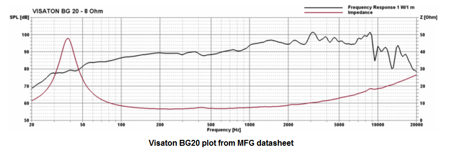

Attached is the response plot that the manufacturer of your driver (Visaton, model BG20) provides in the datasheet. Between 700Hz and 1500Hz the level rises by about 6-7dB. This is the area you should target (as a first attempt) to EQ using the miniDSP. You COULD do this with a passive network, but since you have the MiniDSP it will be much simpler to just use that (at least at first) because you can change the extent and frequency of the shelf EQ until you arrive at something that sounds good.
Do you think you can try that?

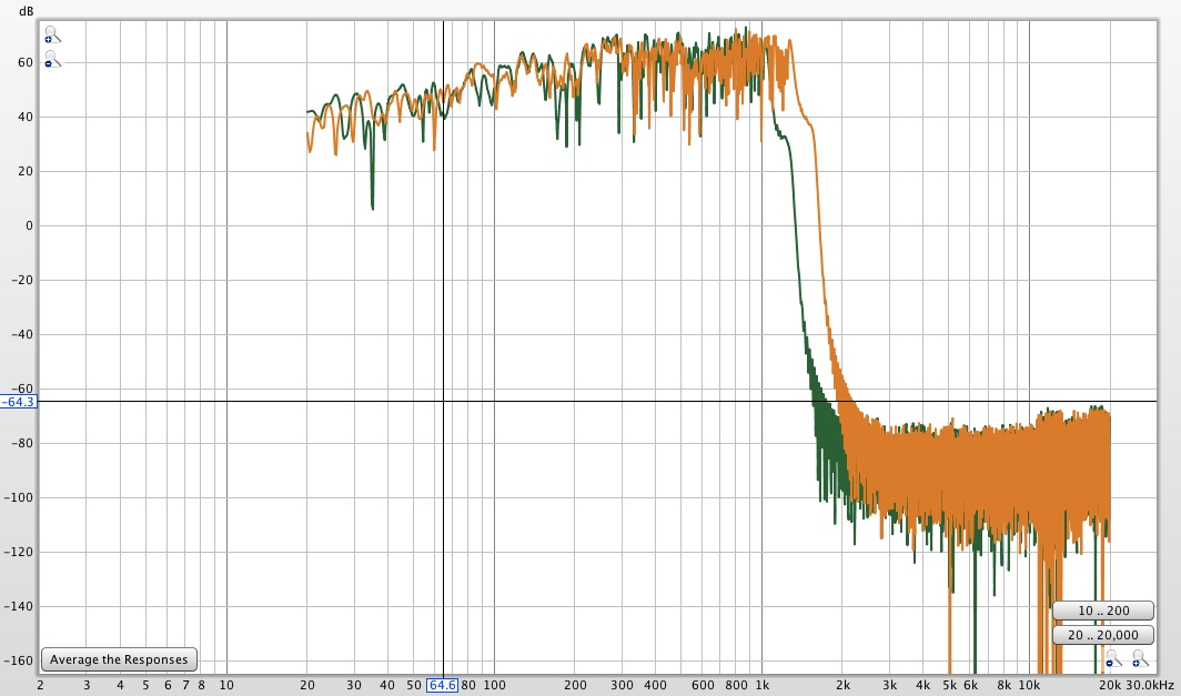

Not very well. I can take measurements with the UMIK, and I can upload profiles into the miniDSP, but my first measurements of the omnis were downright weird looking. See attached. It left me wondering if I made a mistake. If I didn't make a mistake, I need to take the file and EQ it, but there are a dizzying array of options and I got a little lost.

Are you measuring just one speaker with a gating of 3-5ms at 1 meter? Getting reliable nearfield speaker measurements can be a bit of a learning curve. I've been playing with REW and Umik-1 the last months myself..
No. These are an in room measurements taken from each speaker from a seated position about 2 meters away. I don't know what gating is, but I can look it up. I can also take them outside or something if that's a better idea.
Your measurements look like there is a very high order lowpass filter being used at 1.4kHz (green) and 1.8kHz (red):
attachment.php
Did you take these measurements while using the MiniDSP or are they just of the speaker without any filters?
This steep of a filter looks like it might be an FIR filter of some kind. Perhaps your miniDSP has one enabled? Did you get it second hand? If so did you clear it or restore factory default setttings or something like that?

The MiniDSP was connected when I took the measurement, but I don't think there were any filters applied. It's a new unit and I also did a default reset at one point while reading about it. I could try again and make sure I do a reset.
So at this point, we have a weird FR (which could be instantly verified by playing a trumpet recording) and "There seems to be a distinct lack of low-mid frequencies before the sub fills in. At the same time, I can tell that they have promise".
