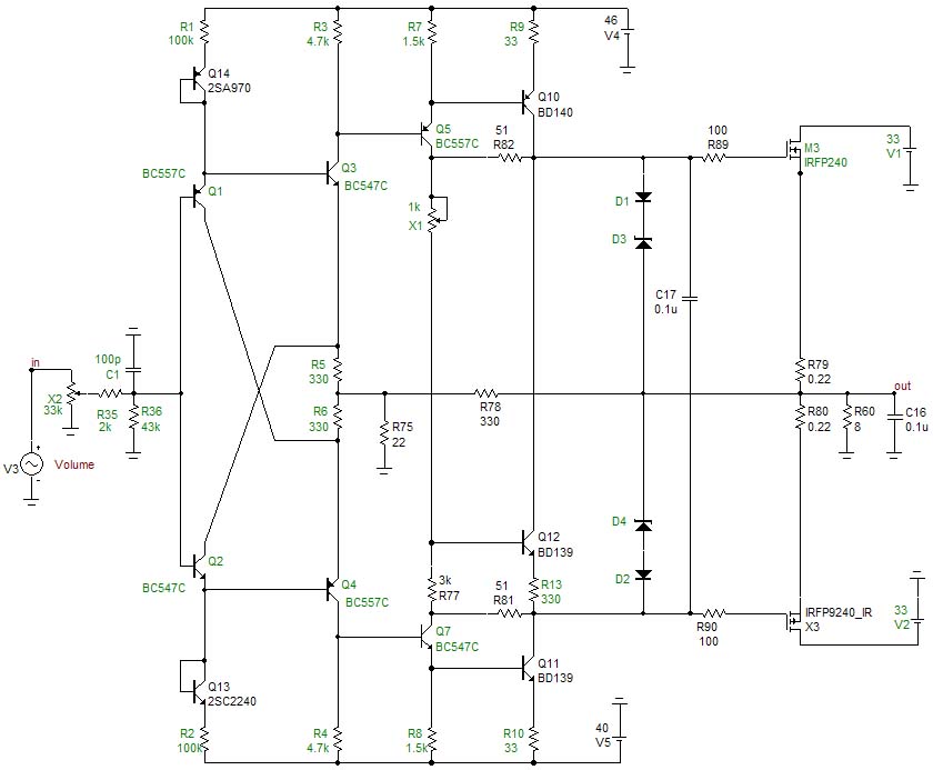

Please comments
Hello All!! I ask your comments under these circuits,
It is very grateful ÂÀÄ

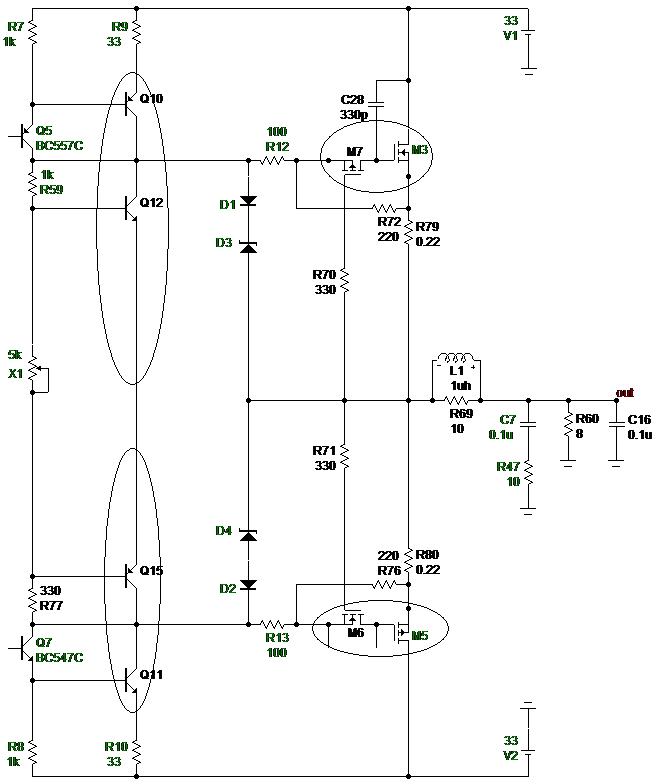

vAD said:
Hello.
Please. Comment output stage.
Thanks.
Well, the circles at left are: darlingoton VAS and complementary Vbe multiplier. Quite nice.
The output stage looks weird.
M6 and M7 seem to work at 0 bias current. What are they for? Built-in diodes or something?
Also VAS 'sees' only Rload+(R12+R72+R79)/2 to the ground.
I don't understand.
Regards
I don't understand.
Hello! Darkfenriz,
R 72, r76. A mistake:😡. The built - in diodes, yes they work(But it is better to replace with diodes Shottki), but all this for a fast recharge input capacitor M3, M5.Simultaneously it should be the stabilizer with the ground on an output, aka the floating ground.Badly I know the theory, has addressed to you.
With Gratitude.
