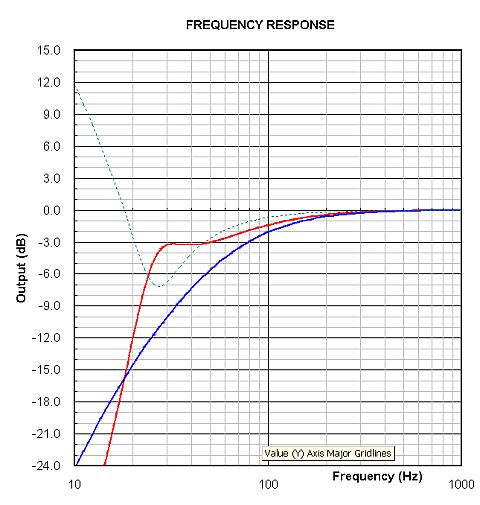

I'm about to begin building a small sub using a 100W plate amp and a TB W8-740C for someone other than myself. I'm trying to keep costs down as much as possible, hence I was hoping to get away with just the single driver in a ported alignment, instead of adding the 10" PR as Creative Sound does.
I get the following response in a modeling spreadsheet (Brian Steele's). The red line is Vbox=Vas=23 litres, Fbox=26 Hz, port is 3" x 5.75". The blue line is 1 ft3 sealed for comparison.
I love the F3 @ 30 Hz.
Comments? I know RAW recommended a 1 ft3 ported alignment for the W8.

Due to the high inductance (Le), F3 referenced to the XO point will be considerably higher than 30Hz. Depending on the XO point, the 1/2 space F3 could be as high as 90Hz. Look at the huge broadband peaking around 100Hz on the factory FR plot to see what I'm referring to. Simple programs don't show this, so many sims bear little resemblance to reality.
Don't know what's caused you to get only a 5.75" long vent for a 3" diameter, but it's off by at least a factor of 5, and probably closer to 6 for a typical golden ratio cab. There's a reason CSS uses a PR.
It can be shortened somewhat by using a ML-TL layout, but even then I still get 24" long for a 3" diameter.
Also, due to the long vent length, the XO point will be limited to ~200Hz and there will be some peaking at Fb, so some damping of the vent will be required for best transient response.
GM

You're welcome! I don't 'know' the driver beyond its published data, so my comments are only as accurate as they are. That said, I don't know what app. this thing was designed for except possibly car audio where there's lots of cabin gain to compensate for the high inductive roll off. For home use, the vented gain isn't all that much whether built as max flat or EBS.
I'm not saying don't build an EBS, I just want you to understand what sort of performance to expect and that you're going to have to build a Daline type cab if you don't use a PR.
Really, Vb = Vas, with a 9" long vent (~40Hz Fb) and some vent damping is probably about the best alignment for home use. You get ~89dB eff./40Hz, rising to ~92.5dB/100-180Hz before rolling off, making it a relatively compact/low distortion, economical wide dynamic range midbass/LF driver to fill in below a FR driver.

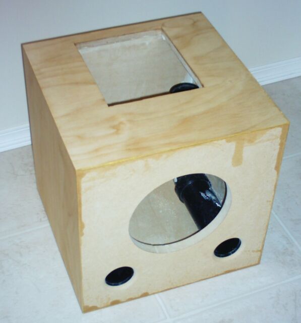

I just wanted to thank you for all your help and post a picture of progess. The baffle is 3/4" MDF, all other sides 3/4" Baltic birch ply; cutout is for 100W plate amp. This is with 2 coats of stain; more stain and clear coat to follow.

Hi Leadbelly,
I've been following your progress on this as I'm considering something similar. I like the looks of your cabinet and am curious to know what method you used to put it together - can't tell from the picture. I'm guessing miters and splines for the plywood with the MDF baffle set into a rebate. Close?
DurdyD said:
Hi Leadbelly,
All 6 sides are 45 deg mitres. Of course, not all 12 joints are tight, so I added 10 small braces in the middle of each panel-to-panel joint.
This actually is a twin of another since I and a friend are building 2 simultaneously. The other one actually came out better, all joints tight enough to not need bracing, and I passed that on to him since he is new to woodworking and has hardly any tools.
