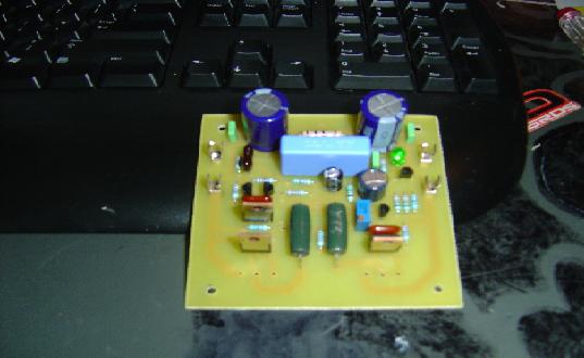

I made one!! and i can tell it sounds great!
no oscillation or what so ever...
here is a little picture of the sweet thing without the output transistor they will come underneath the board
its made of:

my p3a, weak bass and veiled sound
hello folks,
I just finished my P3a amplifier similar to r!sc! designed pcb. thank you for sharing.
I'm using
philips BD139/140 and toshiba 2SC5200/2SA1943
Philips BC 546A.
all Metal fim resistors, except the collector resistor: 2w metal oxide paralled.
evox poly capacitor for pf value
wima input and psu bypass caps
nichicon gold tune for electrolytic capacitor
dual transformer (22-0-22V) 180VA
nichicon Gold tune 4X4700uf perchannel
dc offset : under 15mV for both channel
bias: 150mA
my listening impression:
the amplifier sound is not good.,
it's lack transparancy, weak and poorly defined bass and flat iamging.
the good part is only a slight hum and no hiss.
is there any suggestions for improving the sound?

Are you sure it isn't oscillating? What transistors do you use for the drivers? If you are using BD139/140 for this then they are probably not up to the job of driving the Toshibas.
Also try putting 470uF electrolytics on the rails, on board close to the output transistors. I have found that this helps a lot with stopping oscillations due to insufficient decoupling.

dexter said:I;m not quite sure about the oscilation, I don't have a scope to check it.
I'll change the driver tr from BD 139/140 to SA968/SC2335
hopefully in this coming weekend.
any other suggestions are welcome
greetings dexter,i have just built p3a amp with that pcb layout and bd139/140 drivers and mjl4281/mjl4302, and i could say that i am preety disapointed because the sound is the same as you described.
no bas,no dinamic{flat/not interesting}muudy or no details,iam sure the problem lies in bd139/140.did you changed these driver tranies,any changes in sound?
I have built the P3A on Rod Elliott's PCB (a friend had bought a couple from Rod) and using the parts Rod had listed in his notes for the P3A. I am using 1943/5200 OPS devices. The rest of the devices are all as per his notes. I am most certainly using BD139/140, and I'm happy with the sound.beboni said:greetings dexter,i have just built p3a amp with that pcb layout and bd139/140 drivers and mjl4281/mjl4302, and i could say that i am preety disapointed because the sound is the same as you described.
On a related note, it's a bit difficult to understand what "I'm happy" or "the sound is muddy" means.... it's all subjective opinion. I don't know how to tackle this problem, however. We all just have words to interact with, on these forums.
BTW, if I remember right, your input cap is a little smaller than what Rod had recommended, and your quiescent current is a lot higher than what he recommends. So, maybe you could try fixing those before replacing devices?
