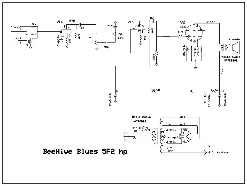

please check my schematic
hi there could some one please check there arn't any obvious errors in this, copying from my amp build of 3 years ago. which i want to clone but lost the original schematic. also changing from 6sl7 to 5751 so may have to change cathode values, sugestions welcome

first amp I have built in 3 years, been fixing a few. got board during lock down and fixed a Holden 100 reverb, seems I got the bug again. and I have 2 beehive box's sitting there already routed for 5f2 or 5e3. so I thought I'd clone this one from years ago as it sounds so good.
but at full volume it gets a weird "Twak" could grid stoppers fix this any suggestions on what to use.

had a closer look with nice sun comin in the window this is closer to whats there.
note there is a grid stopper on the 6l6 that I forgot to look for on the tube socket and second coupling cap is 0.1 not .02 may change it in the next one to 0.2

I'm probably just being OCD, but I like to have a DC path for the 2nd stage grid, that doesn't depend on a pot -- which, given enough time and wear, will ALLways become noisy. Also hate it when the DC operating point can vary with the Volume control setting.
