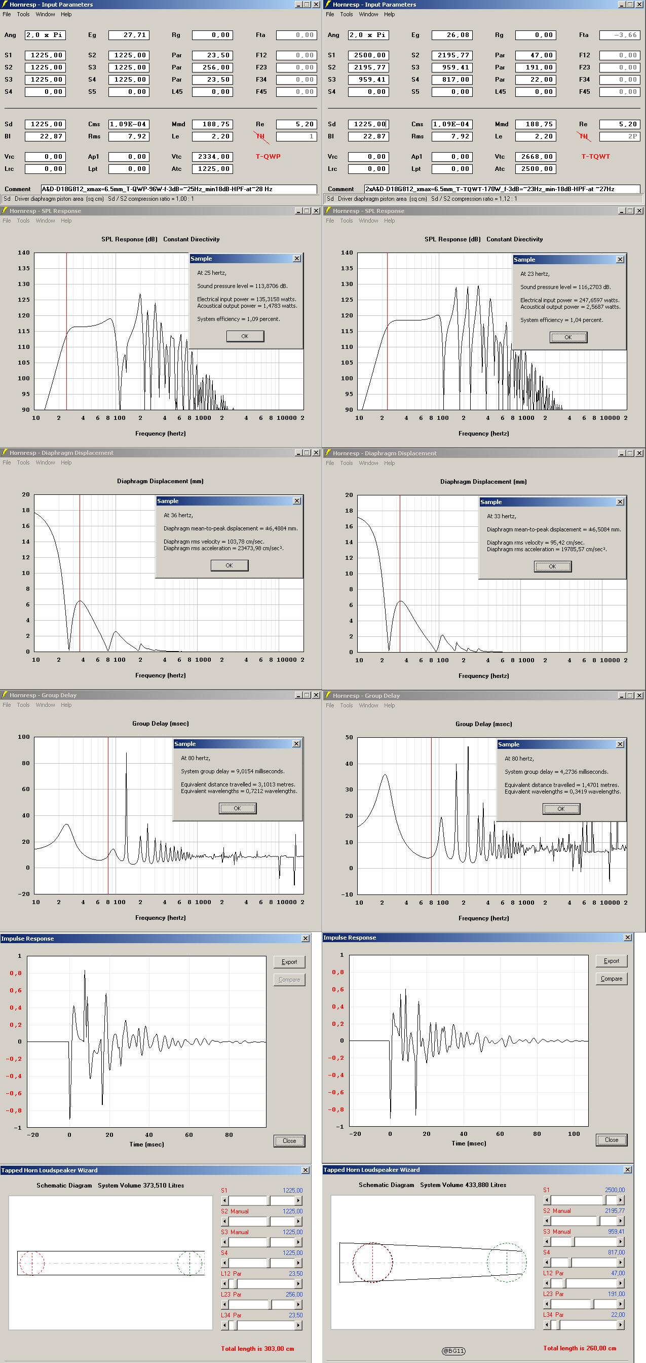

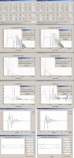

FYI: HT use for one or two A&D-D18G812:
b🙂
