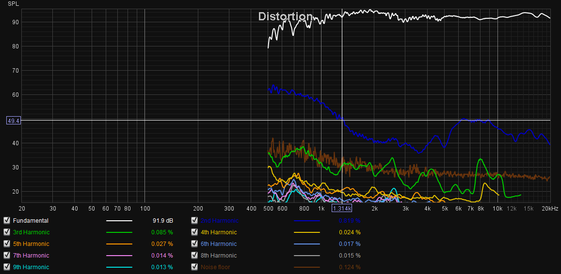

Scan-Speak D2604/8330
In-box measurement (440mm H x 210mm W x 350mm D) cabinet, no roundover)
@1m; 2.83V input. No HPF. Absolute SPL shown.
Made in Denmark tweeter that has excellent low end performance down to 1.3KHz:
Soft dome.
