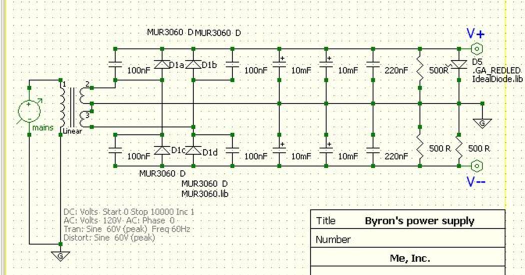

your 40+40Vac transformer should give <+-63Vdc as a PSU with very light load on it. My 230:40+40Vac transformer gives +-58.5Vdc when mains is at 240Vac and total quiescent current is set to ~200mA.............
The UK tolerance range for mains voltage is 216Vac to 254Vac.
If you look at IEEE statistical data on mains voltage variations the nominal +/-10% is routinely exceeded; +15, -30% is fairly common and there's data out to +25%. That means if the mains run high 63V caps may blow depending on the excess voltage duration and how close the caps' actual breakdown is to rated voltage.
I made a statement of what I find with stated equipment and I confirmed two posts later the tolerance range of the mains supply I have. This information was supplied to try to help the Member solve his problem.The OP and, presumably, most folks reading this thread are not in the UK.
Your reply was addressing a different subject.
Whether Members are in the UK or elsewhere does not change my experiences nor does it change the message in your post.
I object to and resent your put down that I am not considering the majority.
I'm sorry you're taking it personally, but I would feel negligent if I didn't raise the limitations of using 63V caps on a 40V trafo. There's enough context in the thread now that a reader has sufficient information to investigate whether or not they wish to risk some cheap (but good) caps:

For this first build I suggest you buy some cheap (but good) 63V caps
