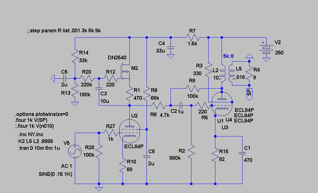

Successfully finished my JE LABS 2A3DX amp, it was so fun that I needed to go on with another project. I decided to build an amp for my pc. Just then I received a surprising present from a colleague whose father was a TV repairer: a bunch of TV tubes: PCC189, PCF80, PCF86, PCL84, PY88 and others. After a search in Internet I decided to build an amp with two PCL84 using the schematic for ECL84 tubes:
http://www.diyaudio.com/forums/attachment.php?attachmentid=67204&d=1152603590
It is a double tube with a triode and a pentode inside, so tjhe whole amp can be made with a single tube.
The only difference between the PCL84 and the ECL84 is the filament voltage (15 V instead of 6,3)

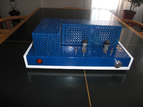

I used Hammond 125ESE OPTs and common components (except the ALPS volume pot, the SOLEN coupling capacitors and MILLS cathode resistors)
I have finished the amp and I am surprised how good sounding it is (I’m not an expert and I hear mainly classic music). No hum, good bass, detailed mids and highs. I am very pleased with it. Here is a pic.
Hello,
the pentode is connected as a triode, I wouldn´t expect more than 1W of power. If you need more power, you should consider building a PSE amplifier with at least 2 ecl84 valves per channel or chose a stronger valve.
George
The PCL84/6DX8 can take a lot of abuse. I've pushed them way beyond rating (9W+!!!) for hundreds of hours in testing without degradation of the performance.
MiniWatt shows them as SE audio amps at Va=250, Ia=16ma, Po=1.65W thd=10% with a 17.5K load.
They also show Va=200V, Ia=20mA, Po=1.65mA, thd=10% with a 11kLoad.
So you need a fairly high impedance load unless you parallel multiple tubes as suggested by revintage.
