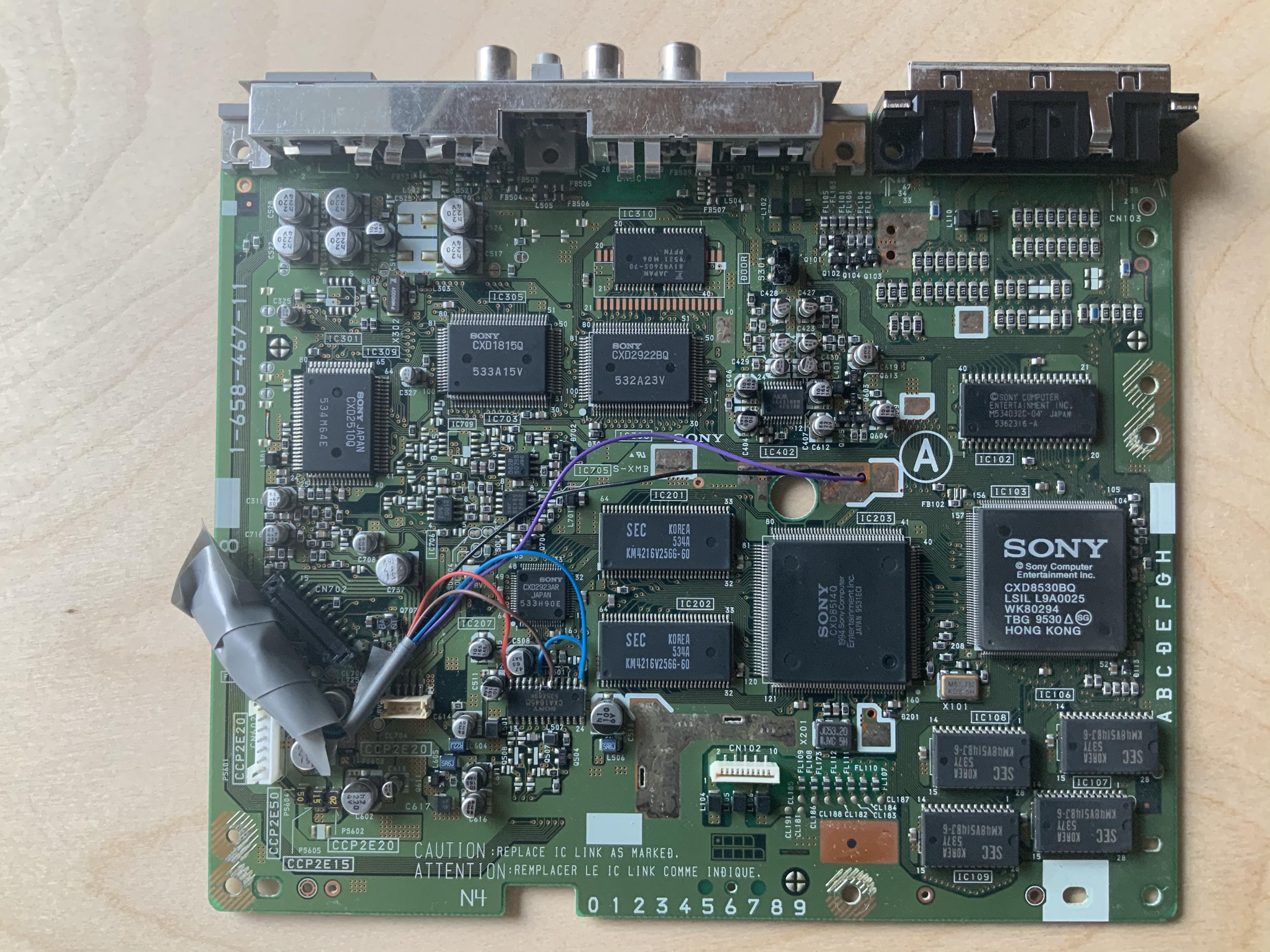

Will the SCPH-1001 mod shown in the first post of the thread work with game audio as well, or is it merely for CD audio?
yes, the idea was 100//300 =>~ 75 ohms
The spdif outputs game audio as well, you will hear the "power up scheme music" when powering up the station.

audiocats - I've just done this mod; first crudely with some +-20% metal film resistors, I didn't get startup sound or game sound but playing CDs worked - presumed it was just noise from crappy wiring so proceeded to install a proper socket and neat wiring now I've got nothing... Reading 0.4V from pin 60 and got about 3.4V into pin 59 - does this sound normal? I've got no audio at the moment and a I don't have a scope to look at what's coming out to debug further, I'm relying on the multimeter at the moment.
Any help is greatly appreciated!

hmm, not sure what happened there. Maybe check the wiring connection to the SPDIF enable pin? I have done the SPDIF tap to a few of my 1001's and all worked ok. The resistors are 1% though.

Got it working now, simple wiring error - I had to hot melt glue my RCA socket in and I got the wires from the wrong way! 😛
Is anybody else using the PAL model, SCPH-1002 ? I get PCM audio but nothing else, e.g. no startup sound, some games that have PCM tracks will just play some sound effects others nothing at all.

It won't make an awful lot of difference - just want to get close to 75ohm for termination, series or parallel works (I tried both)

I was having trouble with this Mod, got no digital output what so ever. So when I started probing I noticed the digital-enable pin 59 was still low because it was grounded under the chip on my SCPH-1002. I lifted the it and now it works perfectly well.
So to everyone getting no output: check if pin 59 is grounded. If so, you need to lift it.
