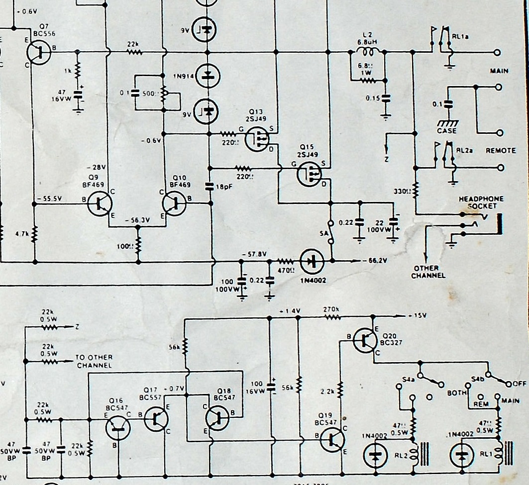

I'm seeking help. I have 2 Playmaster 200 amplifiers and can't find circuit info or schematics. After a bit of work I have both going...kind of. I can't get the relays to switch on however the amplifiers work I have bypassed the relays and they play and sound fine. The DC offset is less than 40ma on each channel (after changing the long tailed pair input transistors) I'm wondering if the protection? relay switch circuit is faulty but not knowing how it works makes it difficult to diagnose. Oddly both amplifiers seem to have the same problem.

It's not a problem with the A/B/AB/off speaker switch is it

I decided to have a look, but I can't find my original copy of the kit instructions, but I did find a scan I had done of the main circuit diagram. Attached is the relevant bit for the speaker protection.

Many thanks. The speaker switch was a problem, both Deoxit and re-solder legs needed, as well as a transistor, BC327, that had legs shorted in a previous repair by someone. The copper pads are very close, quite large but close; I finally found it and now I have one of the units going. It has had previous repairs and some track has been repaired with wire jumpers.
I believe these units sound good but the case work leaves a lot to be desired. Potentiometers are not secured on front panel and removing the bottom to work on them is a ...nuisance! I'll now have a listen and decide if further work needed, caps? etc.
