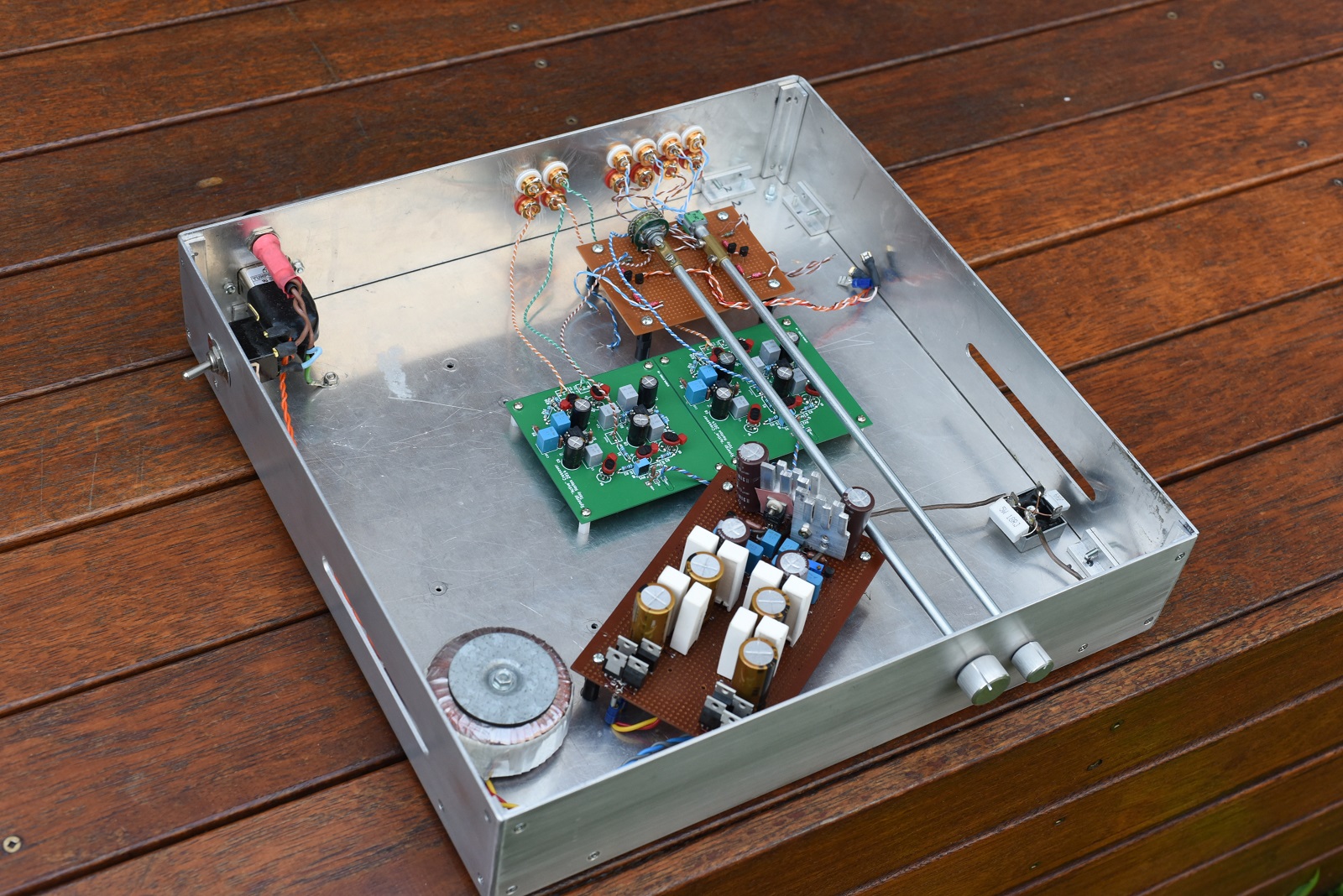

here is a thumbnail (the gallery is dead at the moment) of mine the first time one channel died. My 2yo poked a chopstick in through one of the holes where balance or tone pots used to be and broke a component leg off 😉
Tony.

Hmmm - thanks for the suggestion - that's not a bad idea at all. I think I'll pop in a set of pre-out/in sockets, that way I can feed it straight from the PC in my study while I think of my next move. I was hoping to move it to the workshop next door and run some big old Sansui's off it, but that can wait - I have a Sansui AU-D9 that has a dead output side that I'd like to fix for the study, then I can either sort the preamp in the Playmaster or just run it off the tape outputs of the Sansui... hmmm, way too many broken toys, way too little time 🙂
Just one thing to be wary of. The output of the preamp section has quite a dc offset on it. If you switch from direct to internal preamp you may get thumps. Best to switch the speakers off with the speaker switch before changing between direct input and preamp input.

Checked all voltages that I had measured originally, all good. Will reset the quiescent current next time I have it open. Only anomaly was scorched 6.8ohm 1W resistor in the output RLC network. Popped one end of this - it checks out OK, but will replace. Should I install a higher wattage resistor, or could it function as a fuse of last resort? I don't think that it is given that the 6.8Henry inductance is parallel.
Re the remote volume control - in pricing various bits to provide an indirect connection from the knob to the potentiometer, these parts more expensive than the cheaper kits having 50/50K pot. So decided to buy this first and patch it in and see if there are any noise or other unforeseen electronic problem.
The kit requires 12V/0.5amp power supply. I am not inclined draw this off the +15V supply through a regulator and am considering installing a dedicated rectifier and regulator, assuming that the transformer winding can handle the current. There is no spec on the transformer current handling capability in the original article, so thoughts on this appreciated.
Kit chosen here: 2 Channel Remote Motor Alps Volume Potentiometer Control Adjust 50kA LED Displa | eBay
Instructions in Chinglish in the listing , hard to follow. Also two captions labelled "Display panel control interface" which I didn't notice until ordering. Sent in questions but they provide no answer and are only worried about feedback. But can't expect much for $17.
Will provide a further report when the item arrives.
