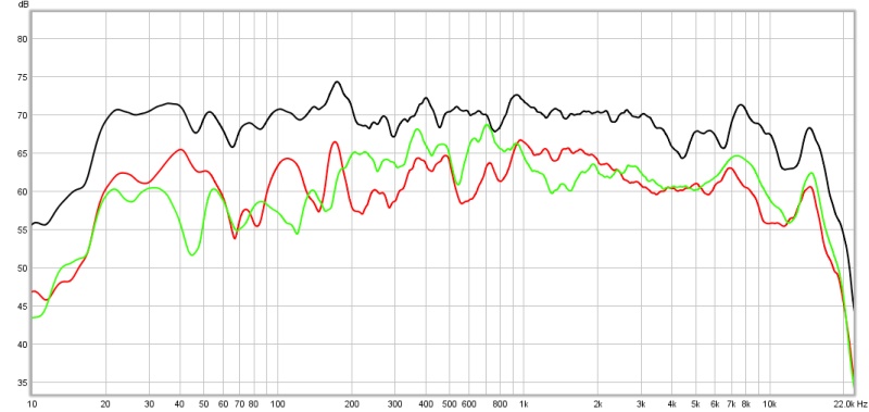

I spend an afternoon playing with the nanoDIGI. Nice piece of equipment. Definitely a step up from the minDSP.
First, the setup: Files on a laptop played through Foobar2000. This computer only has HDMI, USB and headphone output, and the nanoDIGI has only SPDIF input (either coax of TosLink). I have a USB>>SPDIF converter to feed the nanoDIGI. I don’t hear any difference between the coax and the TosLink connection. The output of the nanoDIGI goes to a pair of Topping D-20 DAC’s. The bass goes to a Crown XLS 1500 and on to a pair of Dayton RSS315HF-4 subs in 50l sealed boxes. The treble goes to a Topping TP-60 and a pair of Alpair A10P’s in 16l BR’s.
The miniDSPis a nice piece of equipment and I recommend it as an introduction to DSP and active XO. It has a couple of limitations that bother me. First, the miniDSP is analog input. It then converts to digital, does its thing and then converts back to analog. This means that you only need one DAC to feed the minDSP, and the miniDSP contains DAC’s to drive the amp. The output of the miniDSP is only 0.9v. This is not enough to voltage to drive my amps to full power. Using the nanoDIGI, my DAC’s are providing a full 2v to amps and they can be driven to clipping. The second problem is psychological – the extra DAC>>ADC step is just wrong. Yes, I hear a difference between the minDSP driving the amps and the Topping DAC’s driving the amps.
The FR plots below were created with the microphone at the listening position 2.5m from the speakers 2.5m apart. Therefore they contain all of the room interaction. The plots are 1/6 octave smoothed. The black trace is both channels running. It’s not bad. Does leave some room for more tweaking. The red trace is the right channel only and the green the left. Note how bad each channel is by itself, although the combination is quite acceptable. That’s what you get when the room is not symmetrical, and who has a symmetrical listening room. You must resist the urge to EQ each channel separately. When that is done, the combined result is a disaster. Individual features can be flattened, but the effect must be seen in the combined output. See the peak in the right channel at 180Hz. BTW the XO is a 200. Some work needs to be done with that.
My impression of this EQ is that is somewhat bass shy and a bit flat sounding. The lack of bass may be due to the depression at 70Hz, but this is the area of maximum room interaction, and there is not much that can be done about it. The overall sound is great for instrumentals, but too uninvolved for female voice. A bump up just below 1kHz would fix that and a bit of tip up at the top would add “Life”. So many possibilities.

Great topic and great timing as we are discussing virtues and evils of EQ'ing in DSP in Nautaloss thread. I have the newer miniDSP and it has 2 volt drive capability but the input impedance must be pretty low because my normal headphone level amp does not drive it to clipping. There is also a $40 digital input option for the miniDSP that snaps on as a daughter board to give you spdif and I think optical input.
Your freq response in room looks great btw. You have to be careful with EQ'ing at the 1khz range as the EQ in nanoDIGI is IIR and will present phase distortions in critical vocal range but as Anthonybisset pointed out, use EQ'ing in wide broad strokes and reduce peaks rather than fill valleys and this minimizes noticeable phase effects.
I realize that there are other solutions in building miniDSP stacks, but I don't do electronics, so I have the in-a-box versions.
Yes, one must be careful when applying filters. Order is important, and applying a +ve peak filter after a few others can give truly bizarre results. This why I have a hole around the main room mode at 70Hz. No way to EQ it out. Just have to live with it. Of course, moving the system around the room might help, but as often is the case, that is not an option.

Very nice response!
