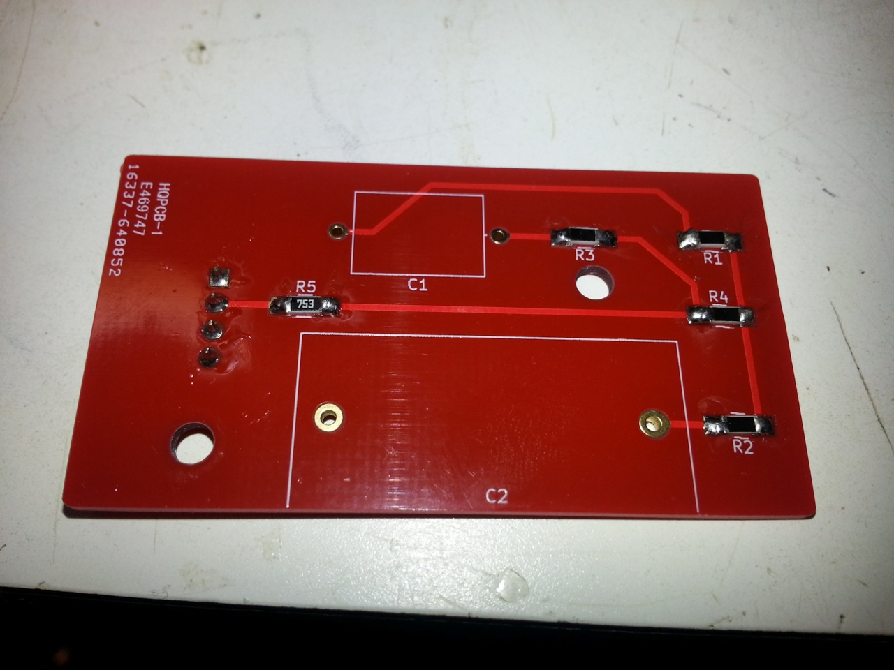

Here are the instructions for building and installing the EQ PCB. (Supersedes all earlier instructions)
All the parts with the exception of the capacitors can be found here: Digi-Key - Fast Add
I do not recommend substitution of any of these parts. Thin film resistors must be used.
The 0.047uF/400V or 600V, 0.022uF and 820pF capacitors are available from Sonic Craft. The caps should be matched and close to the nominal value. (< 2% if possible) I used RTX for the 0.047uF, TFT for the 0.022uF/200V, and a polystyrene and foil for the 820pF.
Some changes are required to the pre-amplifier PCB to fit the EQ boards. See attached schematic for details.
The EQ PCB must be secured to the board to assure long term reliability and prevent intermittent connections. Hot melt glue or electronic grade RTV are recommended.
Optional Reworks:
1. I have identified a minor issue with noise injection into the CCS via the -25V supply by the LM337. See schematic for a rework to add some decoupling to the bias supply to address this.
2. Replace R7 with 47.5 ohm resistor (33.2 - 56.1 acceptable)

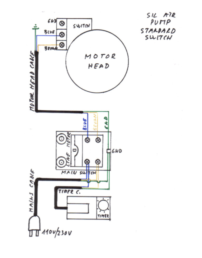

I'm not exactly sure what you are doing with the solid state relays, please explain.
One thing you can try is large ferrites on the compressor power cord pretty close to the pressure switch, this should help both radiated and conducted HF harmonics during switch closure. The other thing you can do is get some snubbers (RC network designed specifically for this purpose) and install them across the switch contacts.)
Kuzma suggests to use long wire and solid state relay for their airline arm. Please the diagram. Basically, they use solid state relay to replace mechanical contact. They use one solid state relay on the pressure switch. I tried it. But it didn’t work. So, I tried to use two solid state relays on AC power, one for phase and one for neutral. Bot relays are triggered by external 12 V DC. I am also using a long extension cord for the compressor. But nothing works.
I also tried a high current power isolator. But, the compressor motor doesn’t work with the power isolator.
I would restore the compressor to stock and implement the suggestions I made and see where that gets you.

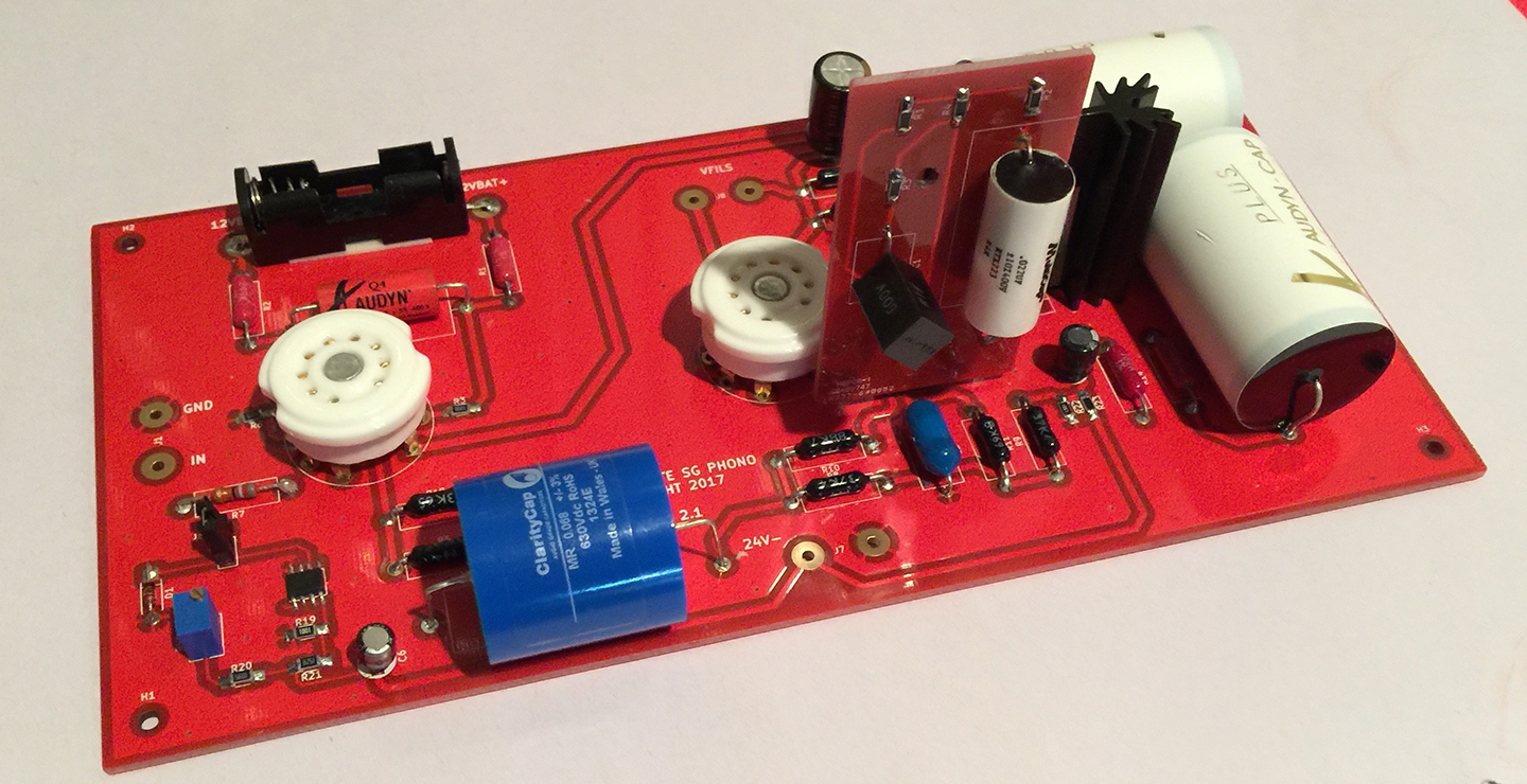

R20 is only changed if you cannot adjust the current to the proper value of 4mA at the cartridge. Really more important is whether you can get the currents to match closely, otherwise is not too critical as long as the current is within about +/-5% of the recommended 4mA.
Is C2 0.047uF? Looks way too large, this is a pretty critical value with the new EQ card. (Looks like 0.068uF which is borderline acceptable, but I would recommend replacing it.)
No. It is 0.022 uF. Thank you, Kevin.

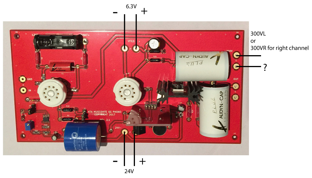

I am in the final stage of finishing up the phono. Before I do this, I want to make sure that I understand power connections correctly. Please see the image to check if everything is ok. Hopefully, I will have time to listen the system next weekend.
Where should I connect the ground of phono cable?
Thank you!
Jim
Thank you!
Jim
I would use the ground closest to the 300V connection rather than the one at the -24V supply.. Reverse the filament connections.

Yes.. Also swap filament connections. (+ to left, - to right)
And I was talking about C2 on the pre-amplifier PCB, not the EQ card. It appears to be 0.068uF, and needs to be changed to 0.047uF..
You can listen to it that way but the bass will be accentuated.. I would not use a clarity cap in that location, I would use a REL RTX or similar.
Yes. These are 0.068 uF on phono boards. I will order 0.047 uF to replace them. Thank you again!
Did you mean 6.3V?

Silentaire uses three kinds of motors. They are 1/5, 1/3 and 1/2 HP. Mine is 50-TC which has 1/2 HP. I guess mine makes the loudest popping noise. Kuzma uses 20A which has 1/5 HP motor. So, the noise may not be as loud as mine.
My compressor runs about 8 mins and stops for about 12 mins at 80 psi. I added a 10 gal tank so it extends the down time a little. I also use two computer fans to reduce the motor temperature.
You only use 10 psi. However, the maximum pressure setting on/off interval is between 25 psi and 30 psi. I think this is why you feel the running cycle is shorter than you expected. If I were you, I would reset cut-in pressure and cut-out pressure lower than default setting. It may extend motor life.
