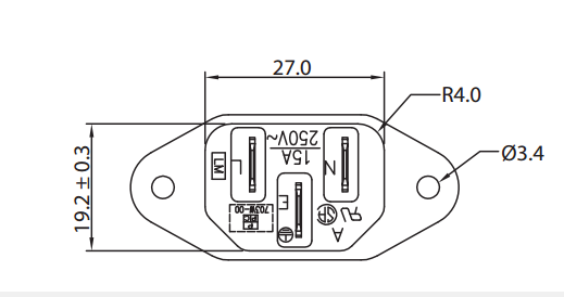

I have edited my previous post, please read the added comments, as wired it is DANGEROUS.
I thought I wired the switch correctly on L side, not neutral N side. 🙁 Anyway, I corrected it. Thank you again!

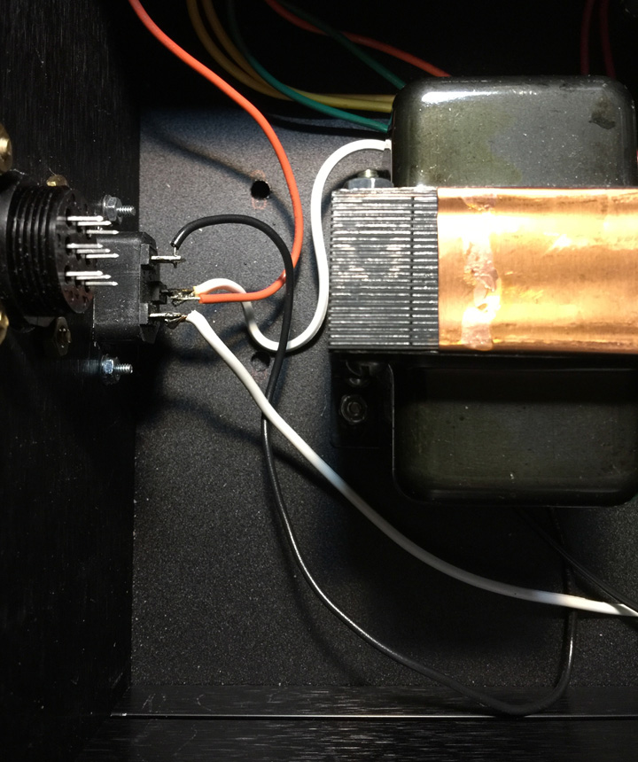

You should twist all AC wiring and keep it against the chassis.
On mine I ran the AC line thru a copper tube grounded to earth on one end only and covered all the transformer AC leads in braid grounded also to one end.
Probably doesn't do much but mine was a tight build unlike the open build of others and had to remove the trans housing to fit inside my extrusion.
The transformer itself should be chassis grounded as Kevin suggests also.
Remember that all 3 pcbs float seperate from the chassis and only connect to earth thru the 10 ohm/ diode combo (used 15 ohm as I had it already)
You will want to put a heat sink on that hot running bridge if you want to make it live a long life.
I ended up using a copper sandwich and bolting it to the aluminum side with plenty of thermal compound.
It takes a little longer to come up to a stable temp but worth it I think.
Regards
David

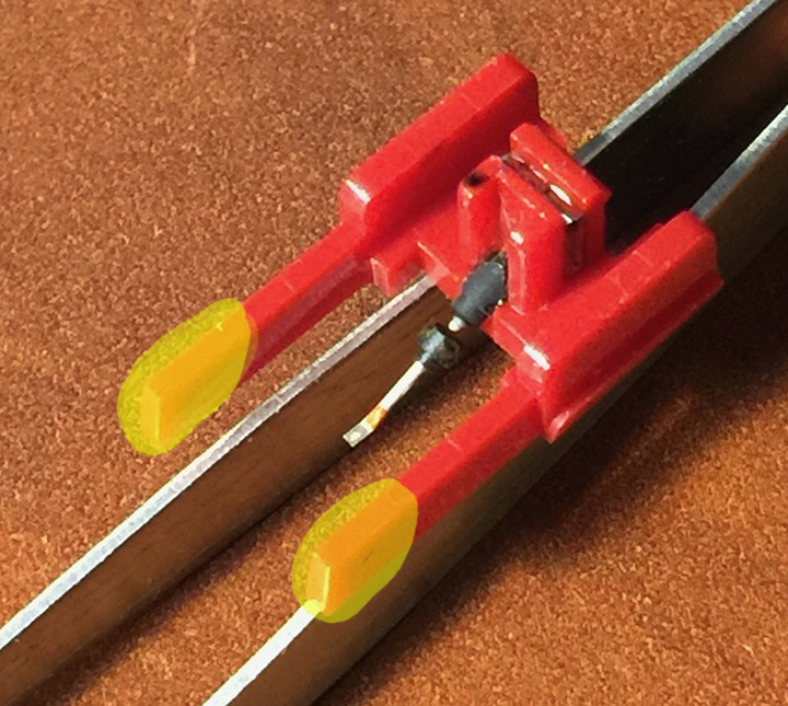

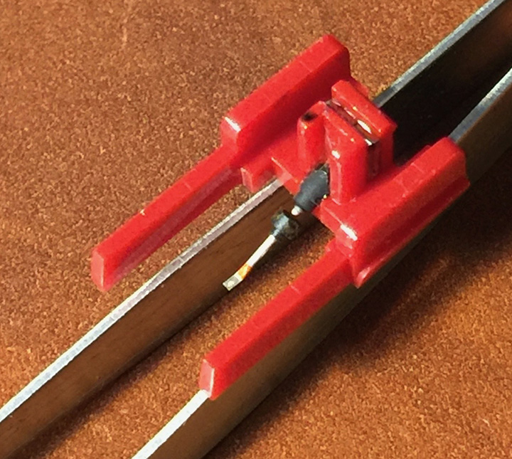

The 'U' channel is the one that holds the rubber cantilever down at the bottom.
That is the one to place some kind of damping in
You glued the spring tension tab that keeps Pressure for the assembly.
You might have a tough fit when pressing it back in
I checked the cartridge this morning. The epoxy is completely cured. The stylus fits very tightly and I don’t think it is necessary to add a external brace to hold the stylus down firmly. I am thinking to add a very thin layer of silicone to both legs( please see the image) to further reduce possible resonance.

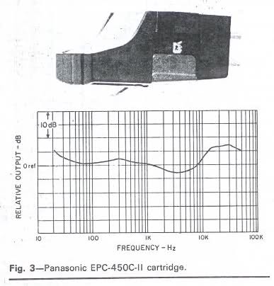

I just got it hooked up last night and it was quite impressive. The response still needs some shaping. I'd say it is pretty close to the attached image, which is the response of the cartridge itself. I put a shelf of -6 db, Q of 1, at 15 kHz. That cleaned up the etched sound at the top. Left the bottom end as it is, which was quite pronounced and probably needs a cut also.
My system is a Technics SL1200 with a DL103 and a Dyna 10X5. The 10X5 is superior to the DL103, and I'd say the 451C was not far behind the 10X5. It definitely calls for more experimentation.
I haven't looked at the circuit of the demodulator, but it does not appear to compensate for the cartridge response. It did sound fine otherwise, so, it must compensate for the RIAA plus inherent SG response. How can one run a frequency response sweep? Might be time to invest in a test LP.

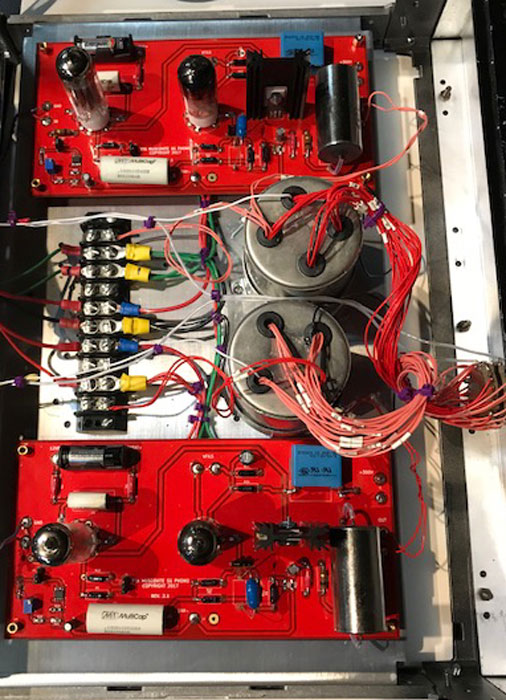

We have a get together today to listen to the new strain gauge preamp, everyone that knows my system were impressed with the improvement over the old and commented the sound was the best my system ever sounded! I end up using .12 uf vitamin q and 1 uf polycarbonate as coupling caps. Very happy with the sound! Very quiet as well.
Kevin really did an outstanding job designing this preamp, for those that are on board for the build you won't be disappointed!
