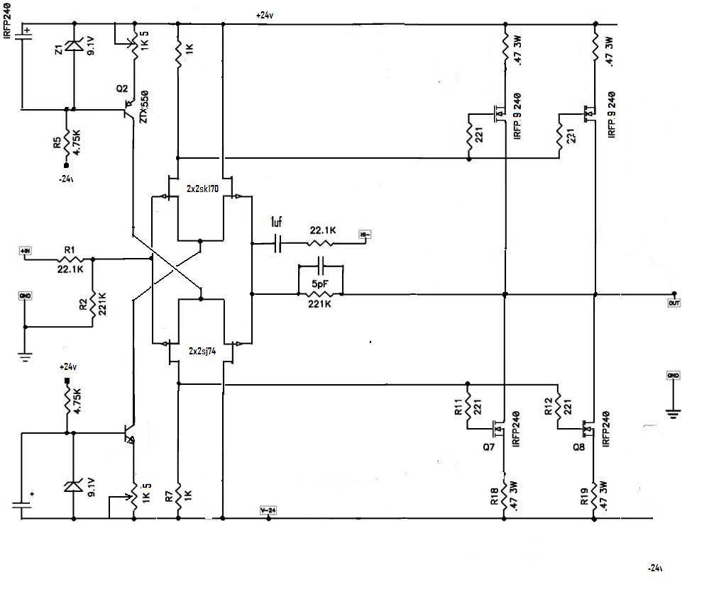

Hi all,
I do dot know if this has been already done...
Derivated from the Aleph j schematic:
Taking the lower half of it and drawing its symetrical as upper half.
I think it should work, though a question remains to me about the feedback: Do we need a leg to ground at the inverting input? (Jfets gate)

already done , and even not just by Papa
dunno where was that posted , few years ago
anyway - F5 is practically same ........ with Spice ( and I'm not meaning on sim prog )

To answer the question, a matching resistor to ground would
give the circuit a better CMRR on the balanced input.
